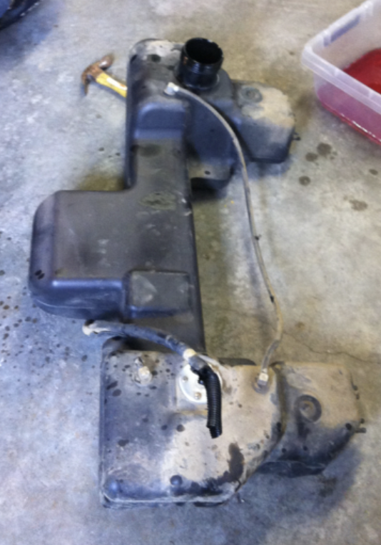

Well, the reason it's $400 is because it's a 6-hour job to remove the tank and clean it. Kubota practically built the tractor around the tank. I'm sure I'm not capable of removing it myself. It's made of plastic and looks like:
I bought a borescope and strapped it to the end of my suction hose so I could guide it to the output port area. That area is a low place so it contained some fuel even after pumping out what was in the tank (probably should have drained it out rather than pump it, but that would have taken a very long time). As soon as the camera end hit the fuel, the image washed out completely. Evidently the fuel is opaque enough that the camera was blinded by its own LEDs.
As for algae, I've purchased something that's supposed to kill it and it's in the fuel now. And I'll keep using that stuff until it's gone.
My plan is to drill the hole in that flat area in the middle section. That's the output port at the lower part of the mid section. The seat is right above that mid section and is relatively easy to get to for drilling.
