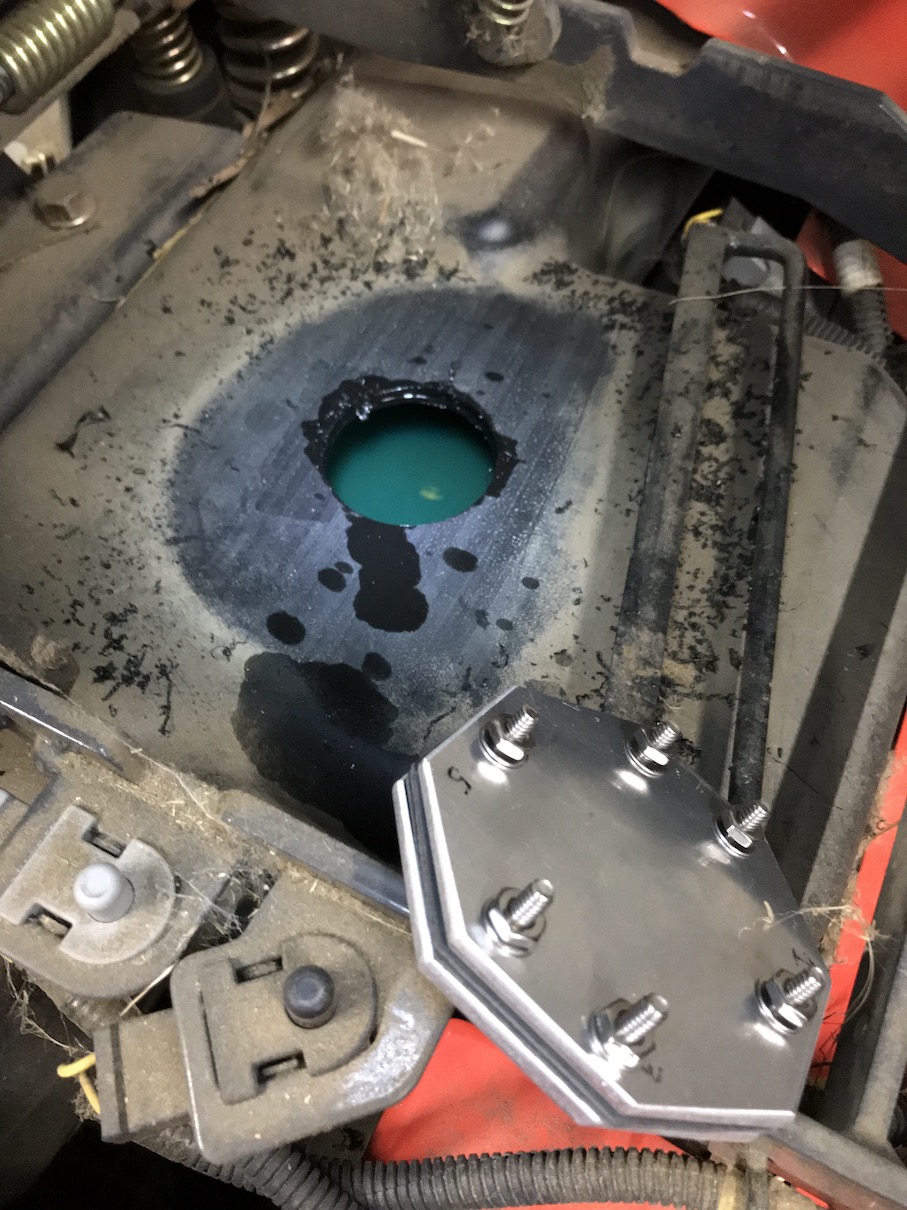

   / Cutting a Hole in My Fuel Tank!
#18
I think you could cut a good smooth hole in the plastic tank with a hole saw
That's exactly what I did. The hole in the picture is a lot smoother than it looks.
But I never found a plug that I liked so I built a seal from 2 aluminum plates and 2 rubber/fiber fuel-proof gaskets. That's it in the lower right. The hole is 2-1/8" and the plates are 3-1/2" across. One plate goes inside the tank and the other on the outside. I'm going to cut the inside plate right down the middle, fold it in half (the gasket should keep the 2 halves together) and wiggle it into the tank. Using forceps I should be able to guide the bolts up through the bolt holes (not shown in the photo) in the tank and attach the upper plate. (The bolt holes on the inside plate are threaded.) Oh, and before I do anything risky I'll tie a fishing line to one of the bolts! Risky, ha ... as though cutting a hole in my tank isn't risky enough.

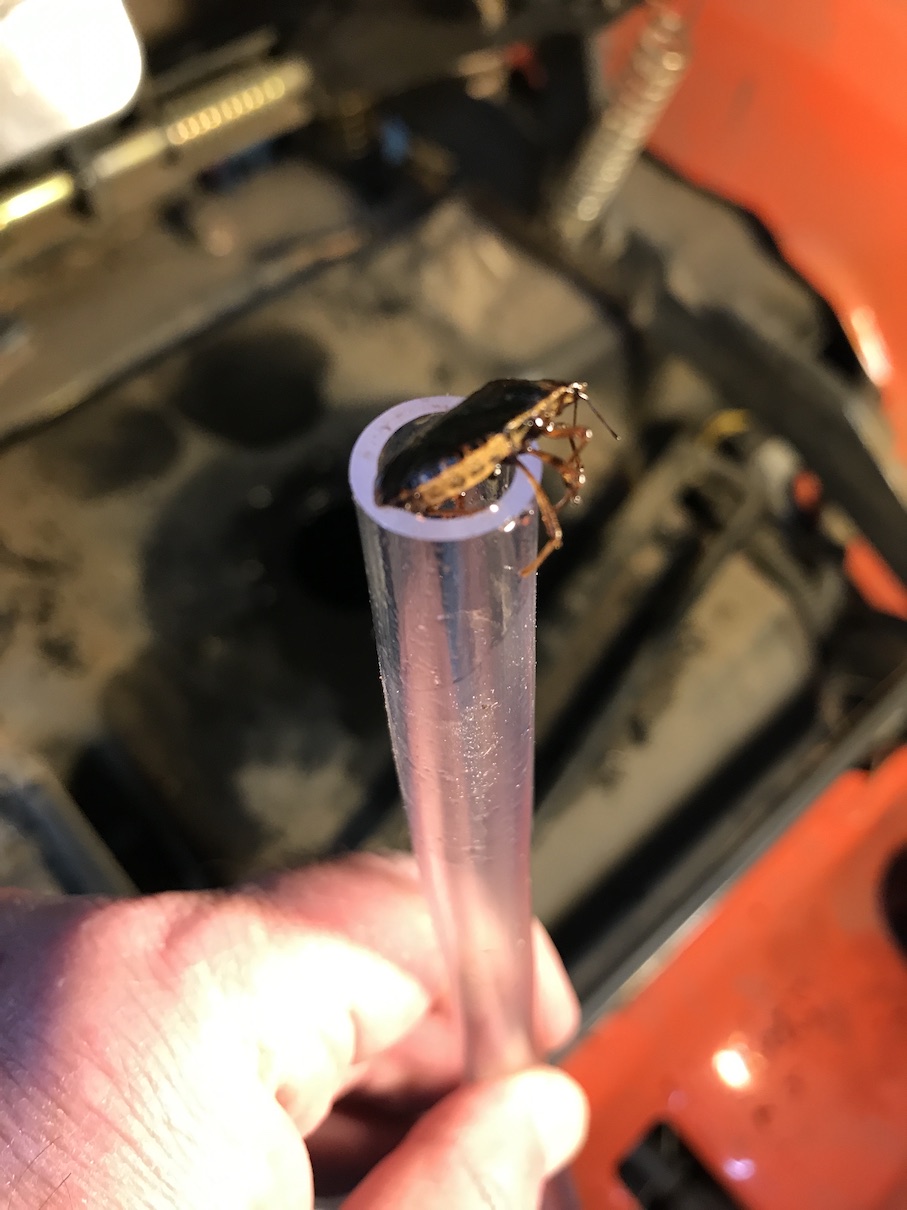

First thing I did after cutting that hole was to suck out all remaining fuel in the tank. I haven't inspected the inside of the tank yet to see what trash has been left behind but I'm sure I'll have to add in some fuel and repeat. (Through the hole you can see one item of junk floating in the fuel.) But I think I found the main source of the blockage... a d--n stink bug!
He may look like he just crawled out of that hose but he's very much dead. When I pulled that hose out of the tank he was just like he is in the pic. Now I don't say WTF very often but I did on this occasion.
And with all this bending over and twisting around working on this little project I've got my back in worse shape than it's been in some time. I'll be taking a break from this for the next few days.
