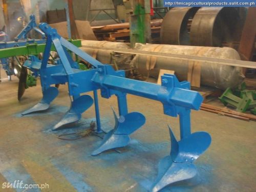

Lots of talk about "across" the driveway here. :)
Used to see lots of 2-2.5 inch square toolbars with clamps for various tools. I hardly ever see them anymore. Maybe dedicated tools have replaced them.
One of those with just one furrower on the end comes to mind for a driveway ditch.
Here is an example I found on Google.
Bruce
   / Cutting Driveway run off trenches #15
Bruce
The above photo is a series of what many would call a multi row potato plow. Anything that furrows and lifts like this would qualify.
Per your request for a trench, this would do it. Trouble with any trench, however is that the water runoff from rain would continually erode the trench by washing the soil and would eventually create other problems further down the line. In addition, weeds would spread seeds because the trenched surface would not be possible to mow. This is why people have suggested a gradual and grassed runoff area.

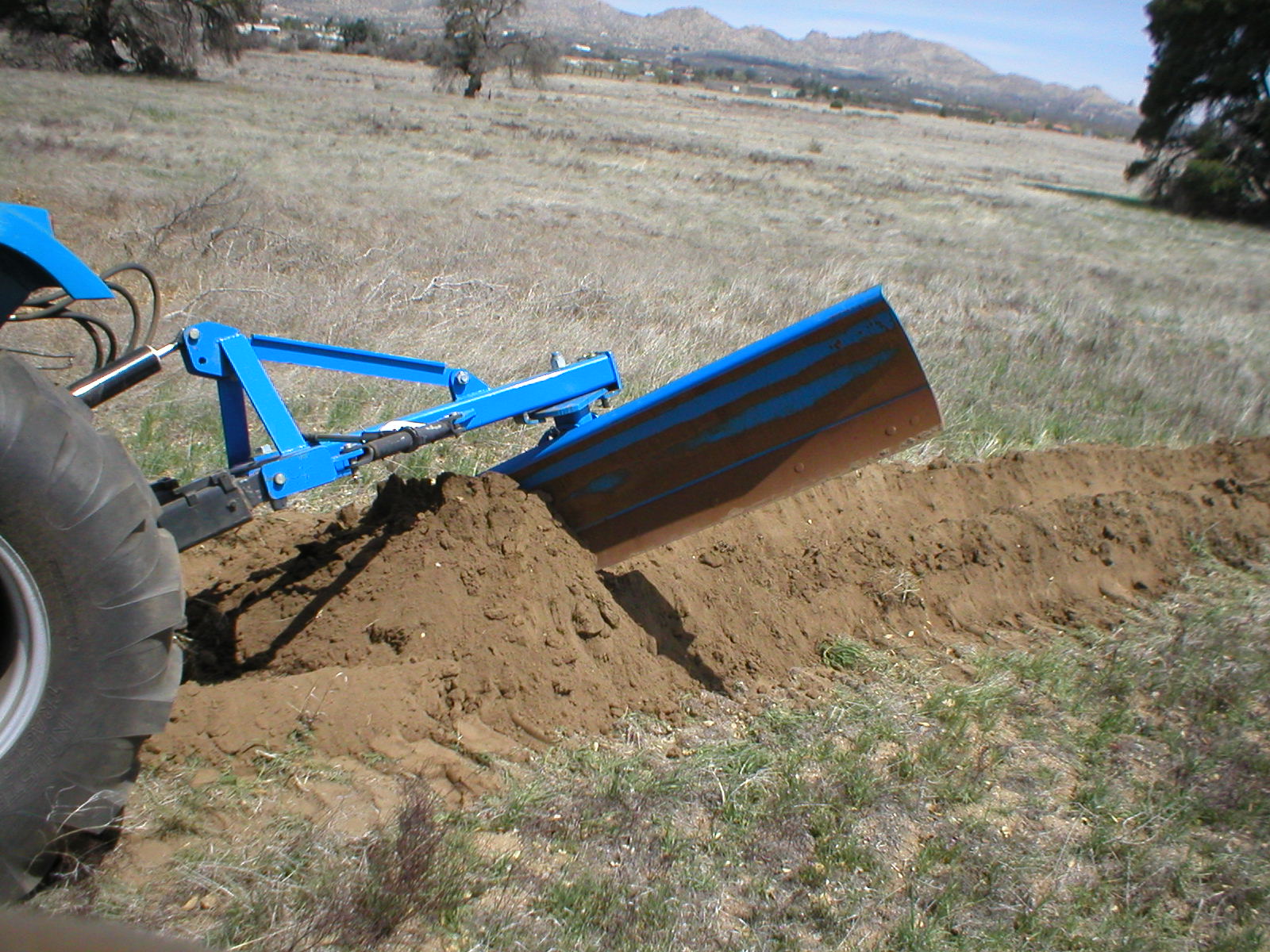

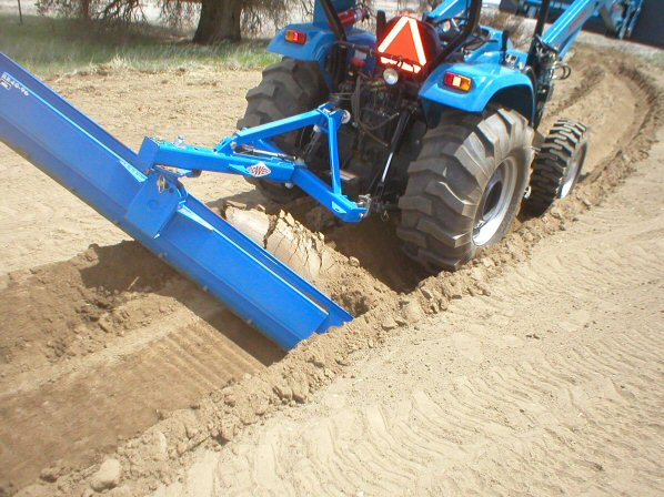

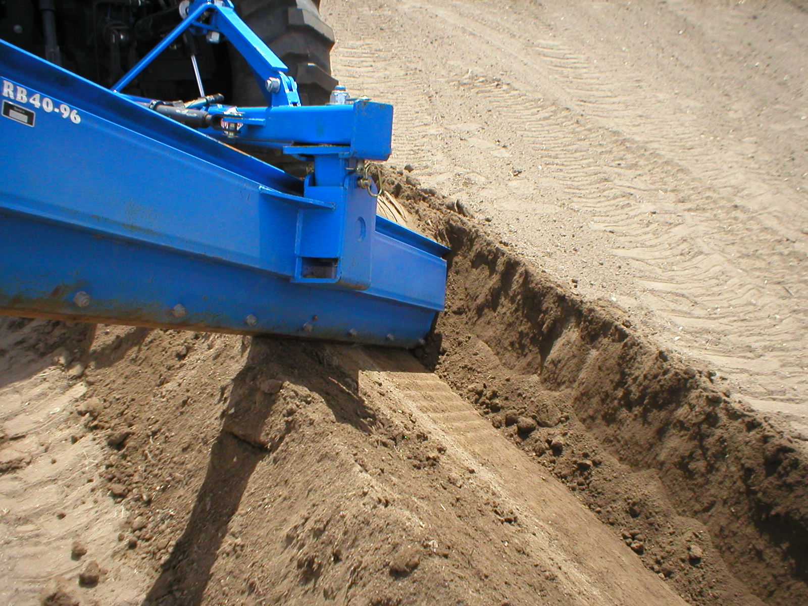

A rear blade allows you to ditch and or do the swales that have been talked about. This rear blade was a good mid quality blade that would work well with your size machine. Back when I bought this blade they ran about $1000. Now a similar quality blade is going to run $1500-$2000. These are very versatile implements.:thumbsup:
