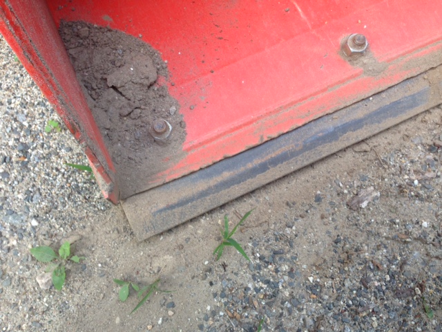

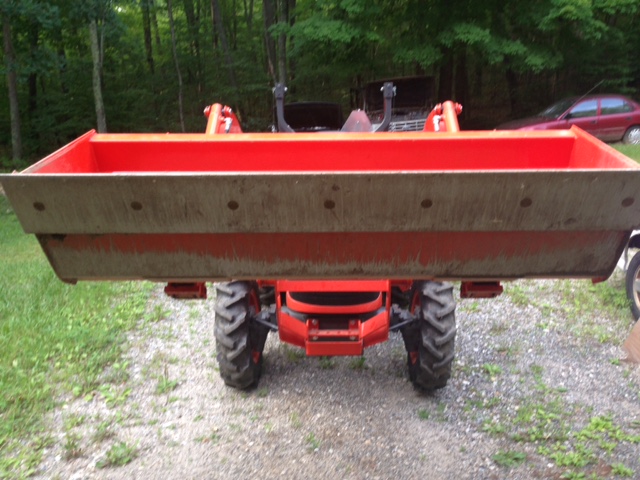

I just clamped it on and it will be .5 inch to short on each side. Should I bail? edgeA.jpgedgeB.jpg
/ Cutting edge protector #8
I just clamped it on and it will be .5 inch to short on each side. Should I bail?View attachment 412755View attachment 412756
Is 1/2" going to make a difference? Many buckets have teeth on them which cause much more issues than a 1/2" gap would. They are generally used for digging rather than snow removal though. I wouldn't imagine a 1/2" by 1/2" strip of snow is going to make much of a difference. If it does, make an overlapping pass or something.

My concern is that the cutting edge is not protecting the corners from wear and defeating the purpose of bolting it on to begin with.
/ Cutting edge protector #10
With that edge the corners of the bucket shouldnt be contacting anything that will wear it out while moving snow.
In order for you to rub that the corner & wear it out by my math your tractor needs to be at 45 degrees or higher. 1/2" wide gap by 1/2" thick = square. If you are half way rolled over or more, you have bigger problems than wearing out your bucket. That corner will get some wear from material, but it won't be dragging on the pavement or gravel as you plow. I'm sure the corners of the bucket will outlast the tractor if you leave that huge cutting edge on all but 1" of the bucket.

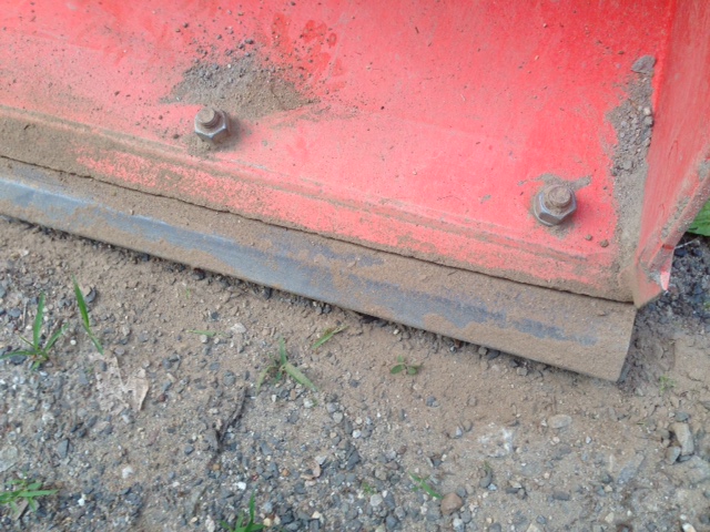

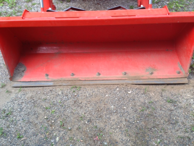

Spent the following week drilling 7 5/8 holes by hand through almost 3/4 thick metal to mount the edge. I got it done just in time for a snow storm on 2/22/2015.
#15
pics:
