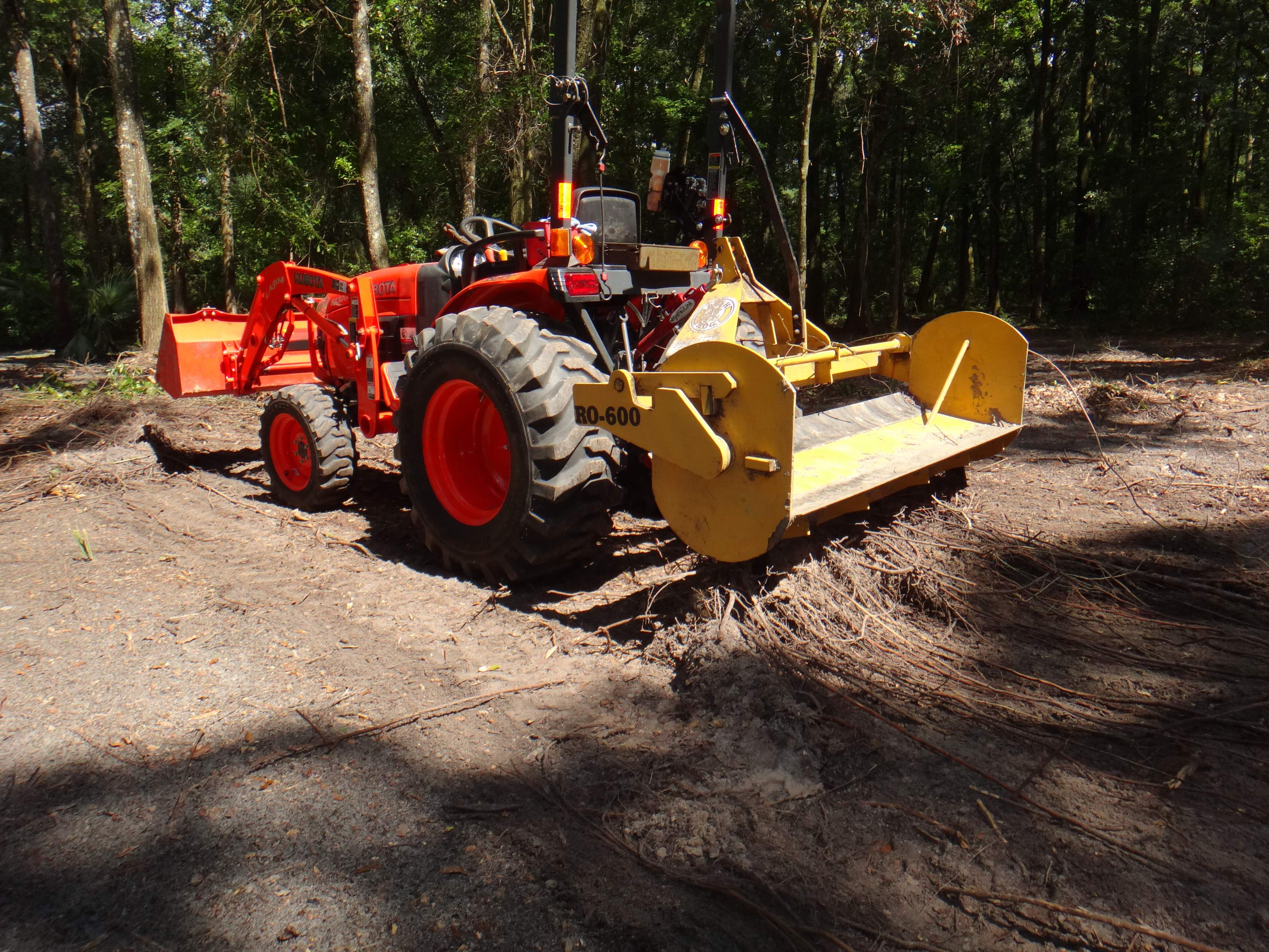

Give it a go. Box Blade or an Rear/Angle Blade are the two primary choices for your task.
Box Blades will move a lot of dirt, one load at a time. Keeping playing with the Top Link adjustment until you get the 'bite' you want.
You might consider a Tooth Bar for your bucket, to pair with the Box Blade. The Piranha Tooth Bar gets great reviews here.
