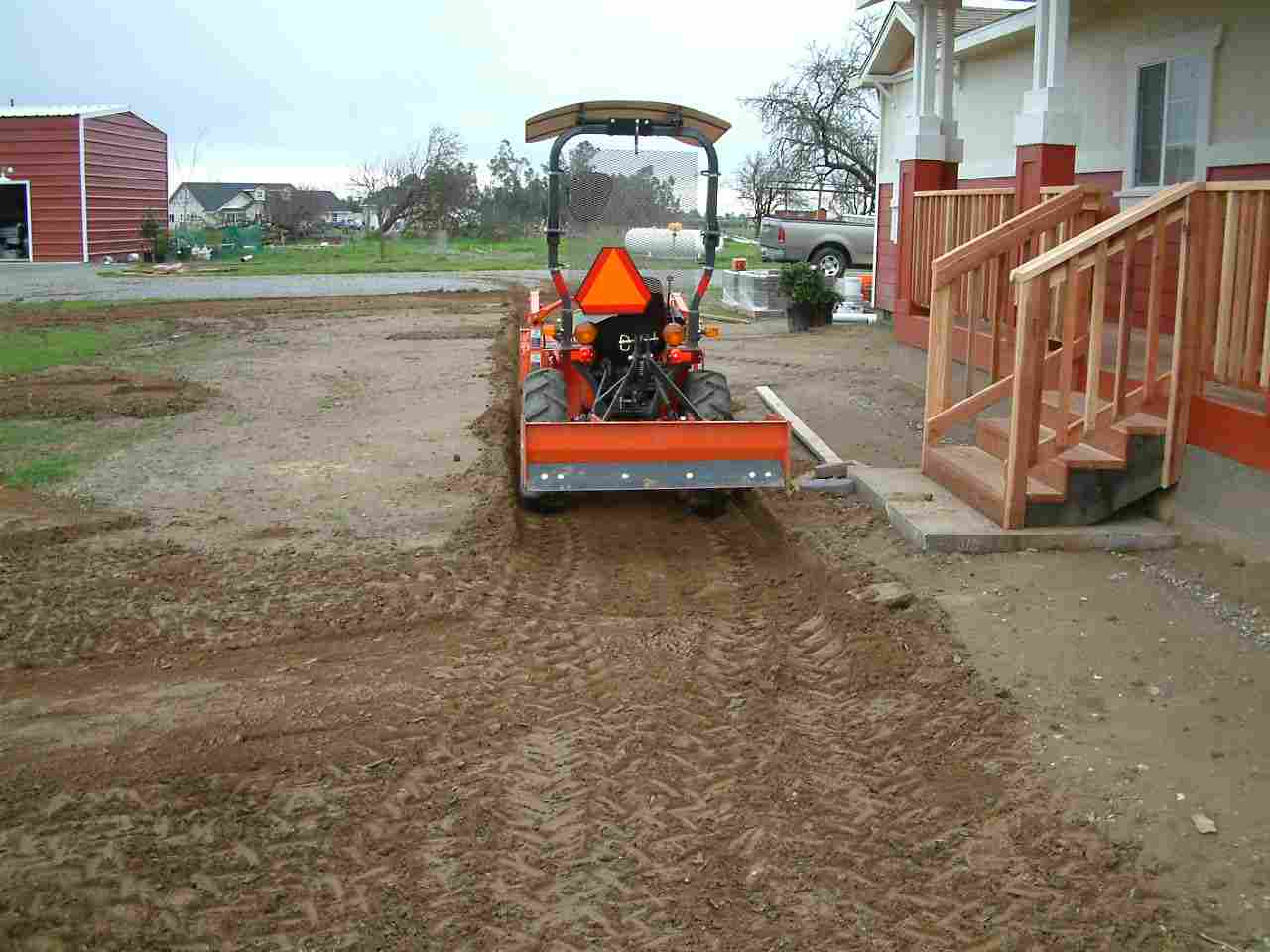

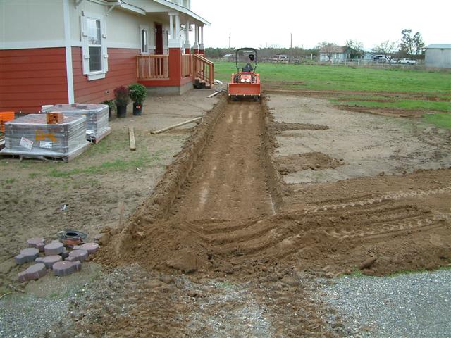

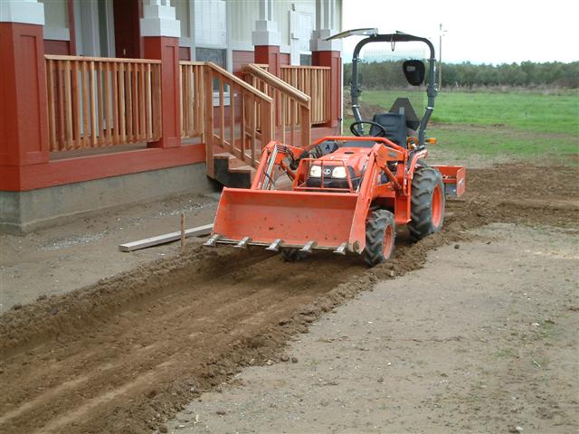

Give it a go. Here's how I used my little Kubota B7510HST, 4-ft wide FEL with toothbar and a 4-ft wide King Kutter box blade to do the excavating for paver block walkways around my new home in 2005.
Made the job pretty quick and easy. Use the box blade scarifiers to dig. Use the FEL to scoop out the dirt.
Good luck
