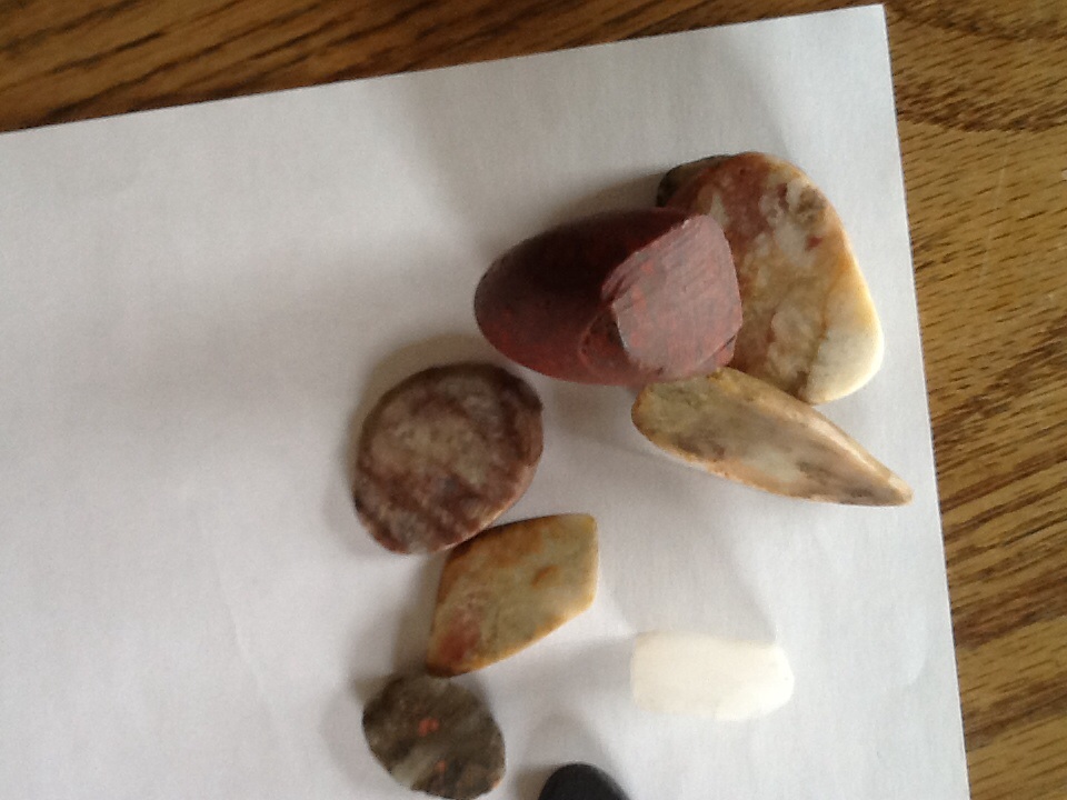

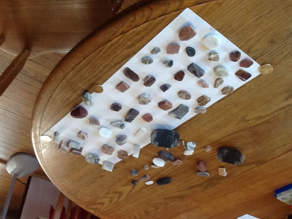

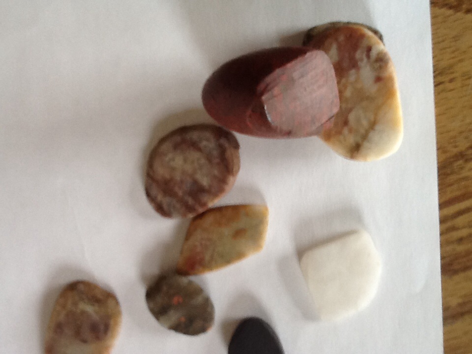

Pictures of beach rocks cut on a wet seven inch tile saw. A one inch cut is easily done in one pass.
