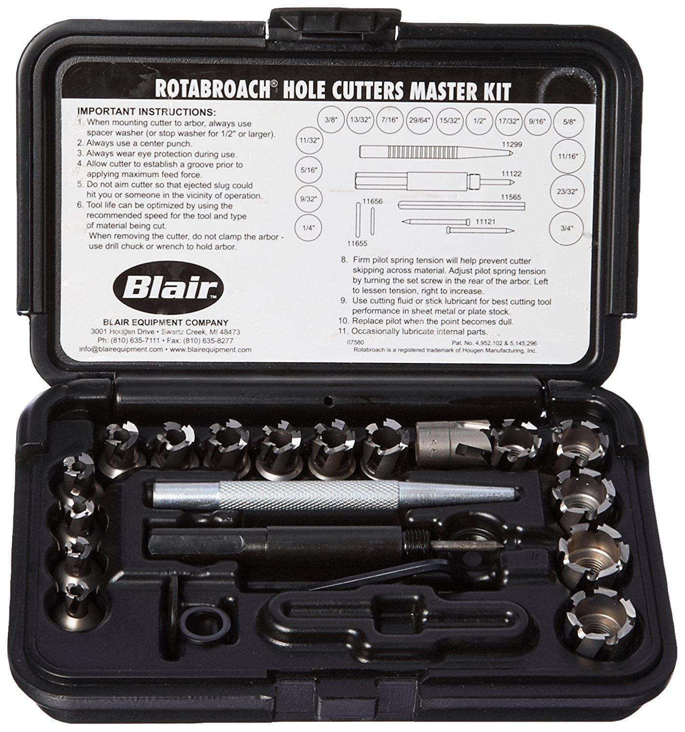

For materials 1/4" or less thick Hougen makes RotaCut Sheet Metal Hole Cutter with arbors that will fit in a 3/8" or 1/2" drill chuck. These have triple flats on the arbor to enable use of cutters up to 3/4" in diameter.
Easiest drilling is this Blair Rotabroach kit. I believe it's made by Hougen. With these hole-cutters
a 5/8" hole is effortless with a battery-powered drill.
Blair Rotobroach SAE Master Kit with 16 Sizes $163
16 sizes from 1/4" to 3/4". Perfectly round holes, plus 15 other sizes. It can easily become your favorite new tool.
500112d1488167699-cutting-holes-steel-gate-post-81ivrbbdcsl-_sl1500_-jpg
Very interesting tool kit. That would be nice to have.
