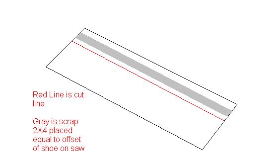

good idea with the screws Junkman! Now, when i do this would the saw try to cut into the wood or would the wood pretty much keep it where it needs to be?
   / cutting metal roofing (straight) #13
The shoe of the saw ride along the edge of the wood as a guide.
   / cutting metal roofing (straight) #14
mopower,
Fasten the 2X4 with screws to the scrap side of the metal. Move it over enough to equal the distance from your balde to the edge of the shoe on the saw. See attached pic

a picture is worth 1000 words...... thanks inspector...

inspector507, you are correct, i am using the master rib and the ribs are closer to 10" apart, so when i cut it, unfortunately, the cut end will be whats overhanging the gables and will be visible, i wish there was a way to put the cut end under the previous panel, but this panel actually overlaps the previous one.. I guess im going to go with the clamping the pice of wood to the metal and using it to keep the saw running straight, but im afraid i wont be able to find a straight piece of wood, every last peice we have bought for this project has been bent and bowed, every last one, so im gonna have a time finding a good straight one, ive been trying to think of something else to screw down to the metal to use for a straight edge., no ideas though.
