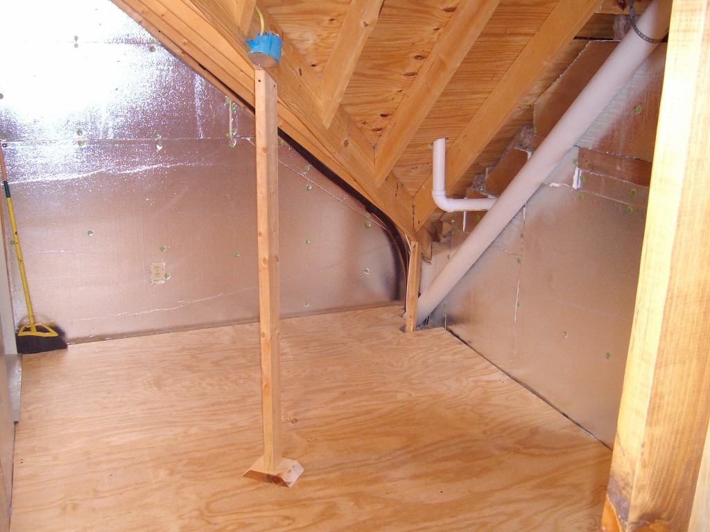

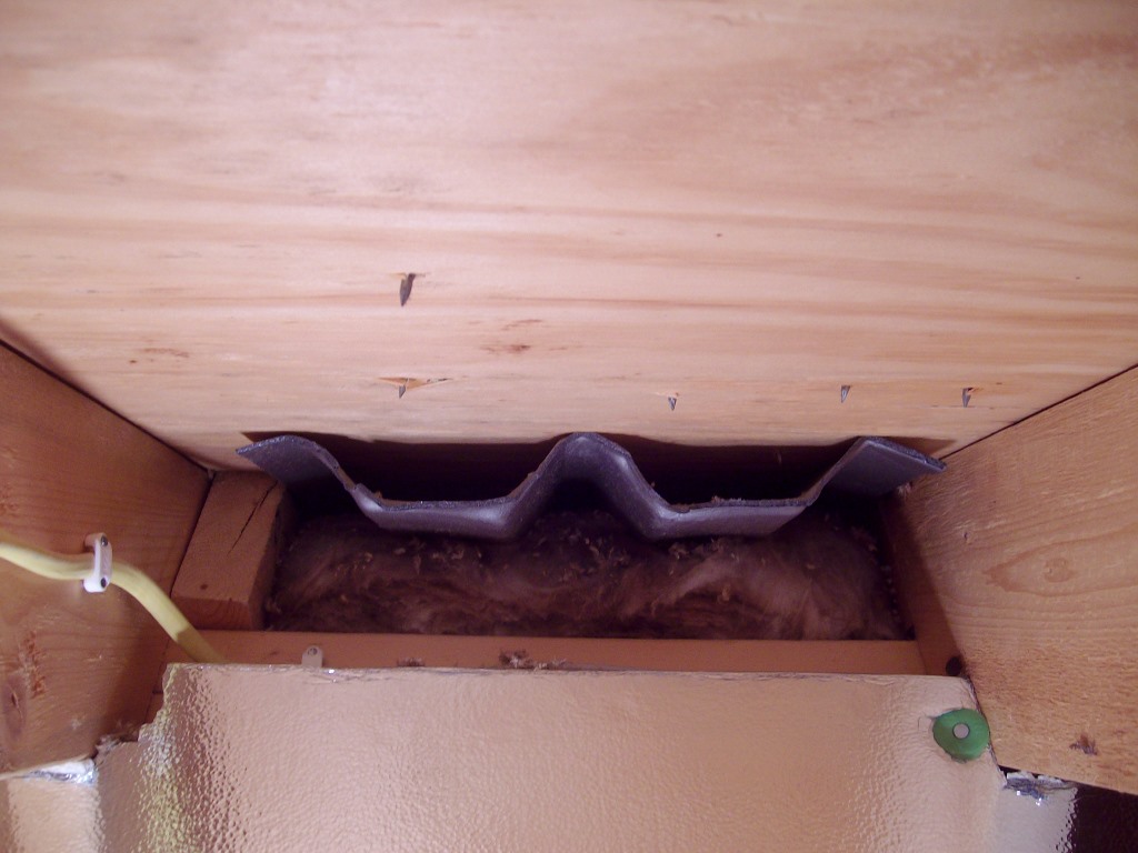

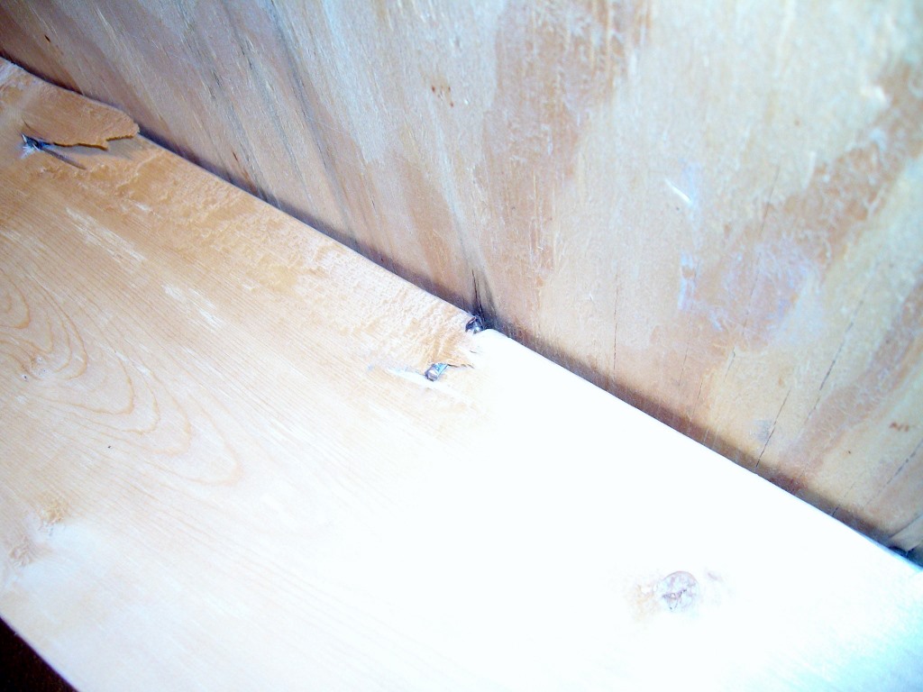

Thanks for all the input. It's done. Went with the cutoff wheel. All good, except for a nice coating of nail/wheel debris all over me, and the smell of burning plywood where I had to burn through the splinters that had broken down around the nail tips. We kept a close watch for any smoldering for several hours. After the first one or two, it was obvious that the heat generated was minimal, and probably only raised the temp out at the nail head to a couple hundred degrees at the most. So didn't even wet rag them. In most cases there was only the nail tips (about 1/16 - 1/8") protruding, and the ply around them was splintered out, so I don't think I really affected the nail grip any. The other candidates were where framing (16d) nails or 8d ring-shank nails used to fasten the decking down had missed or just barely caught any framing and these were providing nothing but a hazard anyway.
- Jay
Typical of the roofing nail protrusion
Typical of the framing nail protrusion
Finished product
