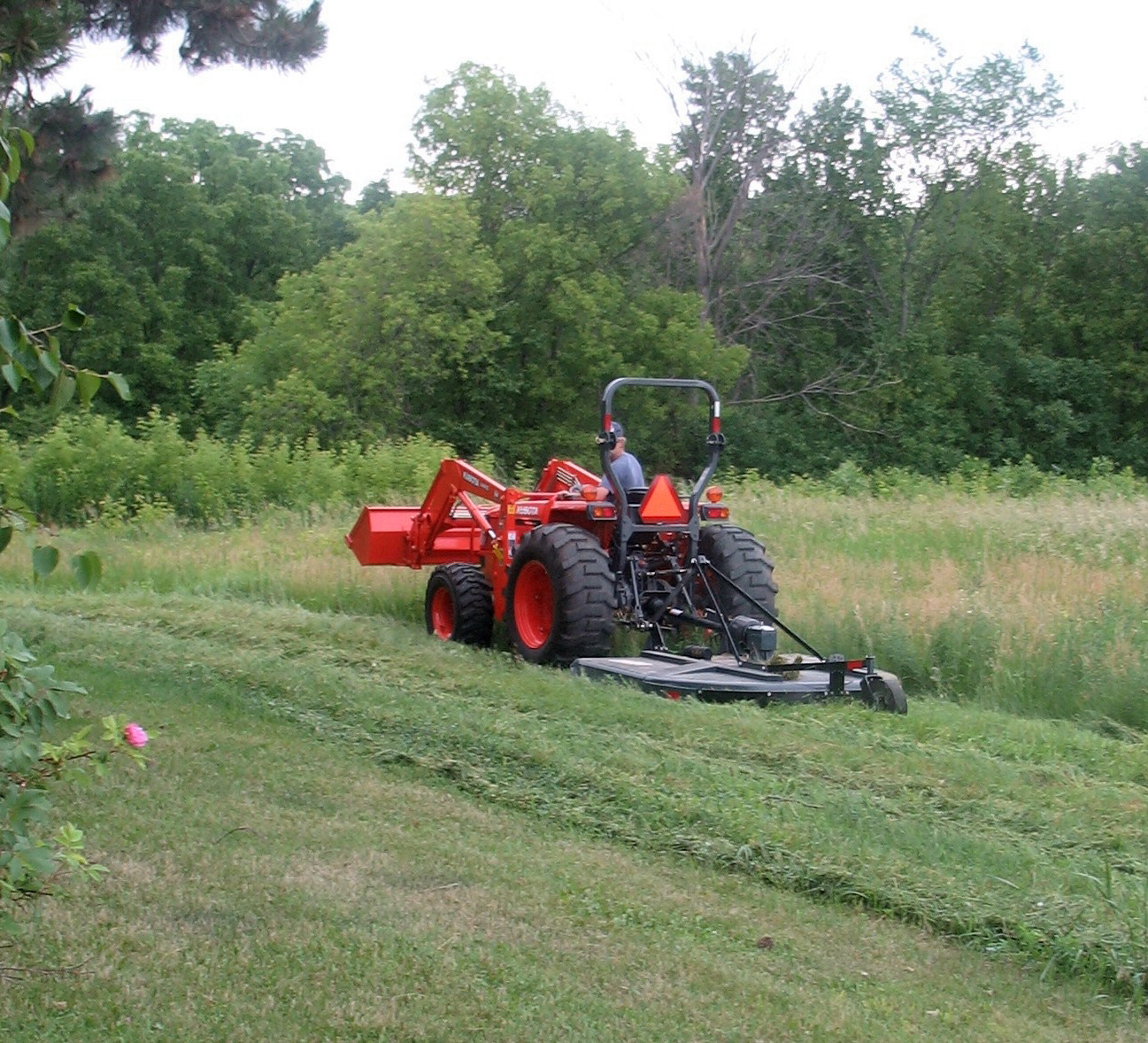

Mowing down a field that had grown wild for 5 years. I can walk through stuff like in the picture in 4th/low without a problem. Going over the top of a huge gopher mound will make it work though.
