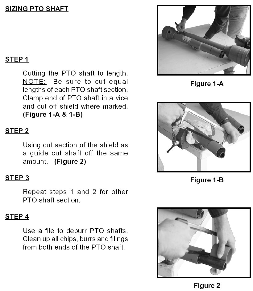

from KingKutter
Sizing a PTO shaft...
(see attachment)
   / Cutting PTO Shaft #26

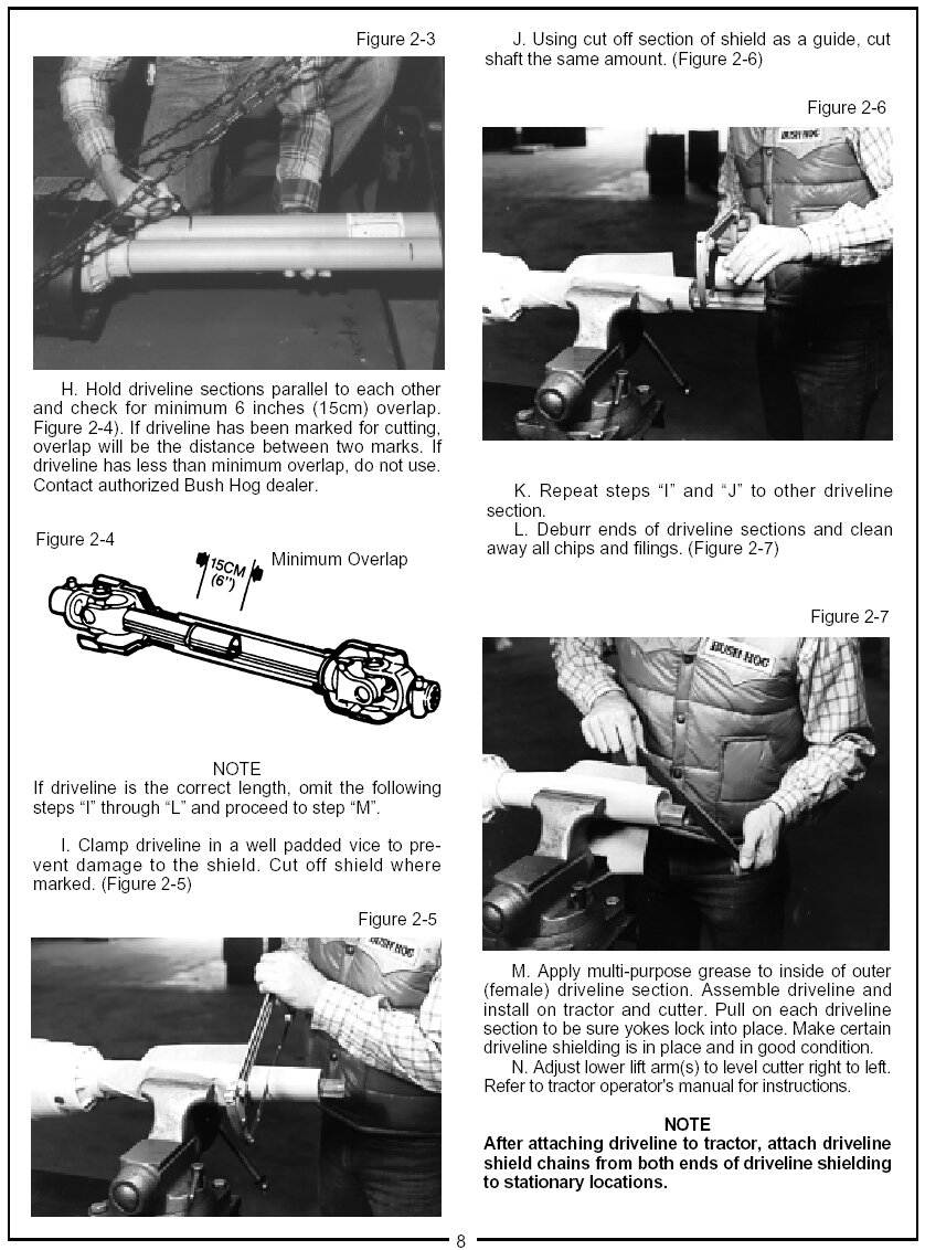

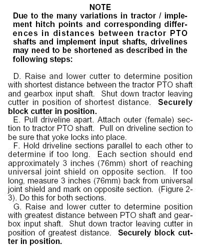

Where's Page 7? /w3tcompact/icons/smile.gif
   / Cutting PTO Shaft #27
(for Mike...part of page 7 /w3tcompact/icons/smile.gif)
(sizing PTO shaft per BushHog)
   / Cutting PTO Shaft #28
Thanks, John! /w3tcompact/icons/smile.gif
