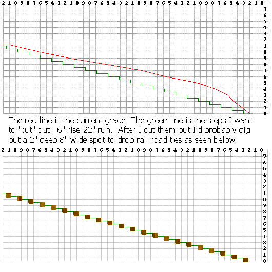

I have a bank behind the house that drops down over ten feet. I want to make this friendly to walk up and down for family members of all ages. I am thinking about a 6" rise with a 22" run for the steps. I'll attach a cut away drawing of what the bank looks like and what I want to do with it. Nothing fancy at all. I want to leave the steps dirt for now with railroad ties to keep the edge on the steps.
My question is I don't know how to start! /forums/images/graemlins/crazy.gif I have standard hand tools (shovels, levels, etc.) I have a Power-Trac 180 with a FEL and a tiller (that attaches to the front arms). I was thinking of using that combo to start digging into the bank. The bank is pretty good soil no rock or hard clay to dig in.
There are big landings at the top and bottom with plenty of room to work. I just don't know where to start (literally). Should I start at the top going down or the bottom going up. Do I completely cut the steps then put in the ties or complete one step at a time including the tie to hold it in place? Any thoughts, ideas, suggestions would be appreciated! /forums/images/graemlins/smile.gif

<font color="blue"> I want to make this friendly to walk up and down for family members of "all" ages. </font>
How wide is the property and would it be possible to carve in a walkway from side to side in somewhat of a 'Z' pattern?
Don
   / Cutting steps into a bank #3
You start at the bottom and go up. You'll have a RRtie for the riser and a tie on each side stabbing back into the bank (making the sides of the steps). Each riser rests on the step below it. Once you have the first step leveled, the rest are easy.

Bill, I think Don may be onto something with a zig zag pattern or something other than a step that is 6" tall and 22" deep. Those steps would be pretty hard to stride with any rhythm. I think you'd find people would take a few steps, then have to adjust their stride, then take a few steps, then adjust their stride.
We have a stone staircase that goes down part of one of our slopes. It was layed out in several small flights with a few small landings. So you climb 4 or 5 stone steps that are each roughly similar in rise/run to a standard staircase, then come to a landing that is about 3' to 5' long, then climb another 4 to 5 stone steps up to the next small landing. I think there are 4 sets of steps and 3 small landings to the stair case. It is very easy and natural to walk, even with the irregularities of the natural stones we used as steps.

Bill, Looking at your drawing , I have a question ,Is it possible to take some of the dirt off the knoll at the bottom 1/3 of the slope and drag it out to lessen the incline at the bottom? Because other wise you will be cutting a valley into your bank...
Generally the slope somewhat dictates the amount of depth a tread is going to have.
As said before start at the bottom...
I have a smaller scale than yours staircase that I used RR ties then behind each tie is a poured slab which is about 1' in depth adding to the 8" RR tie for a total of about a 20" tread.
You could use brick pavers or concrete squares or stamped concrete(nice)behind each riser post. I could post a pic if it would help.

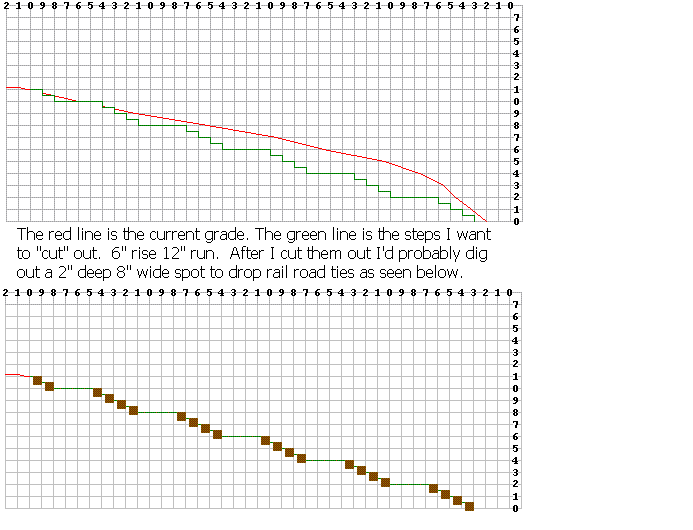

As Bob notes above there is a pace that makes using steps easier or more difficult. The combination for a normal stair case is for the height of the riser and depth of the landing to be 18 inches [see this page for a better explaination]. I'd guess this 18" about matches the normal walking stride.
If that be the case, then design the stair case using a 6" rise for RR tie leaves 12" for a landing. Then add 18" to the landing depth for a total landing depth of 30". A side effect of this will be to use the same leg for each step up, which may be uncomfortable to some folks. Making each landing two strides long (12 + 18 +18 = 48") may be a more comfortable pace and would work well for a person using a walker.

Thanks everyone again for all the helpful ideas and suggestions! I have modified my plan and am using the more standard 18" formulae for steps. Since I do want to keep the small rise of 6" I am going with the 12" run as suggested. This will allow me a 4' landing after every 4 steps. The top most landing should have only two steps to reach the top grade.
I've attached drawing #2. /forums/images/graemlins/smile.gif
I will be cutting into the bank as noted earlier. What should I do to hold the sides up? I do imagine they may fall in a little but they are not that big so maybe I won't have to do anything or I could taper them in a bit to help them hold.
