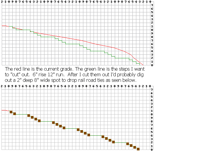

As Bob notes above there is a pace that makes using steps easier or more difficult. The combination for a normal stair case is for the height of the riser and depth of the landing to be 18 inches [see this page for a better explaination]. I'd guess this 18" about matches the normal walking stride.
If that be the case, then design the stair case using a 6" rise for RR tie leaves 12" for a landing. Then add 18" to the landing depth for a total landing depth of 30". A side effect of this will be to use the same leg for each step up, which may be uncomfortable to some folks. Making each landing two strides long (12 + 18 +18 = 48") may be a more comfortable pace and would work well for a person using a walker.
   / Cutting steps into a bank
#12
Thanks everyone again for all the helpful ideas and suggestions! I have modified my plan and am using the more standard 18" formulae for steps. Since I do want to keep the small rise of 6" I am going with the 12" run as suggested. This will allow me a 4' landing after every 4 steps. The top most landing should have only two steps to reach the top grade.
I've attached drawing #2. /forums/images/graemlins/smile.gif
I will be cutting into the bank as noted earlier. What should I do to hold the sides up? I do imagine they may fall in a little but they are not that big so maybe I won't have to do anything or I could taper them in a bit to help them hold.
