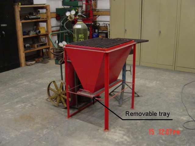

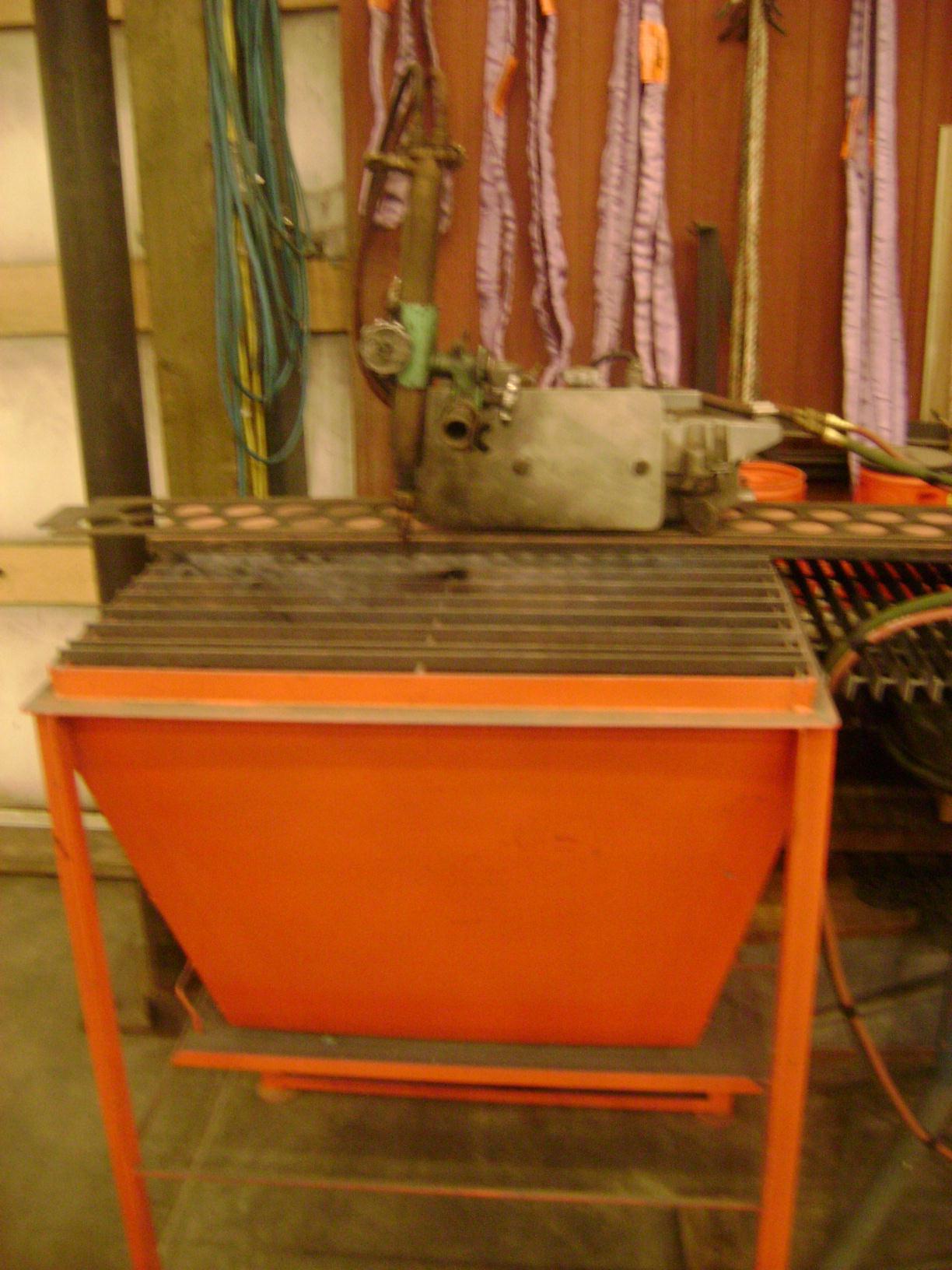

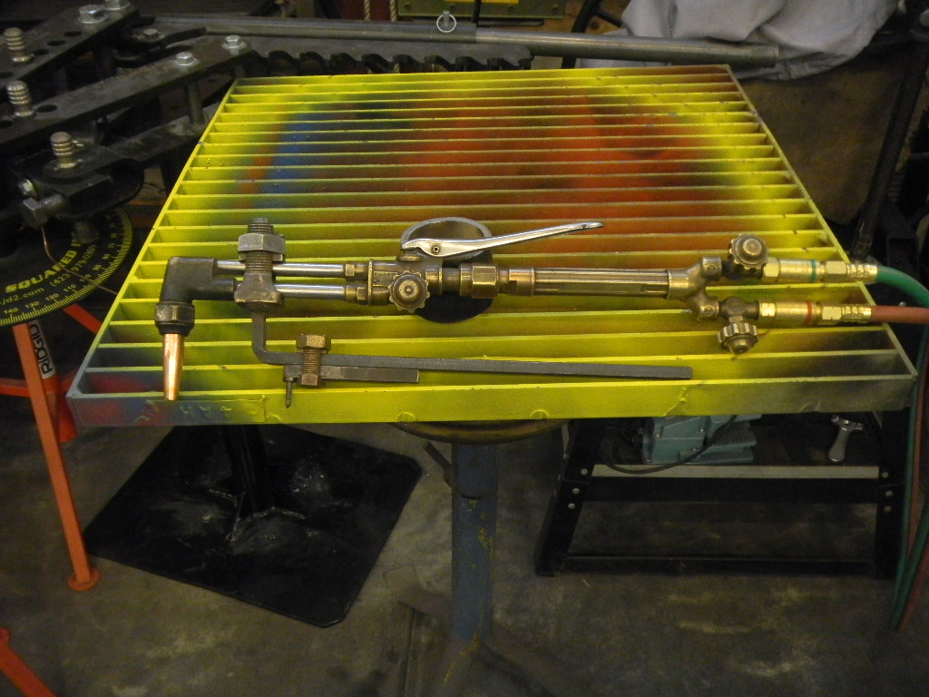

I built this one years ago. I used 1/4" x 3/4" flatbar for the slats. Spaced about every 1 1/2". If you can find some bar grating, it works good too. I use the bar grating for my rotating circle burning table.

SA, thats pretty close to what I had in mine, but Instead of sq, I probably go Rectangle, running the slats longways. Do you have much problems cutting thru the 3/4 wide slats. I plan on lining my cuts up the direction the slats run and maybe taking out one or two slats depending on how the cut lays. It just seems to me if the cut had to run across a 3/4in wide slat that it could burn thru on the first pass

I try to make all my cuts, where it doesn't cut the slats. I don't use that cutting table much, I use my Ellis saw for 95% of my cutting.
This last grate I got was given to me. As you can see I use it more for painting on than cutting circles:eek:. I've been galvanized poisoned at least a dozen times. For me welding galvanized material is not all that bad, but burning it gets to me fast!:thumbdown:
