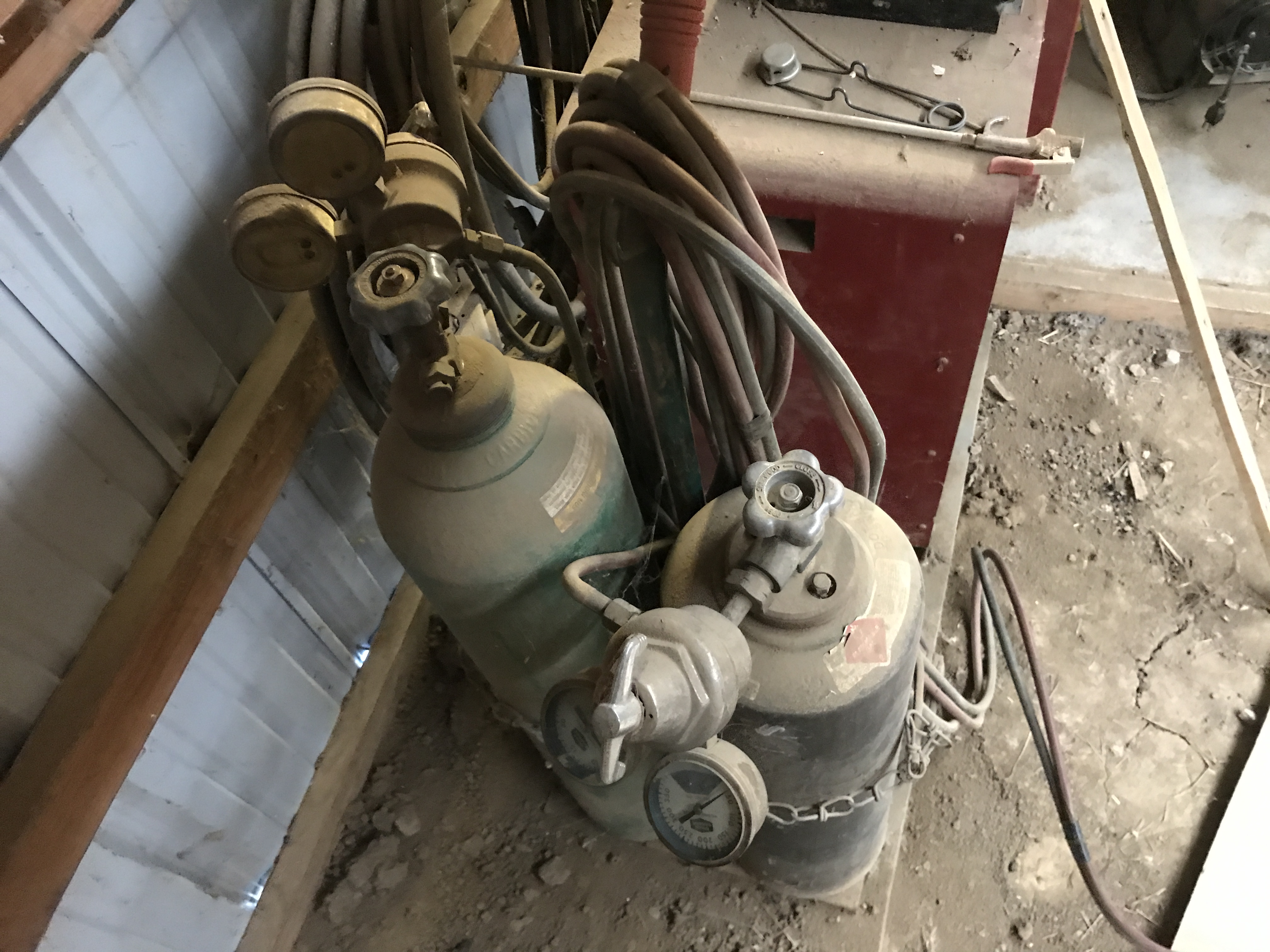

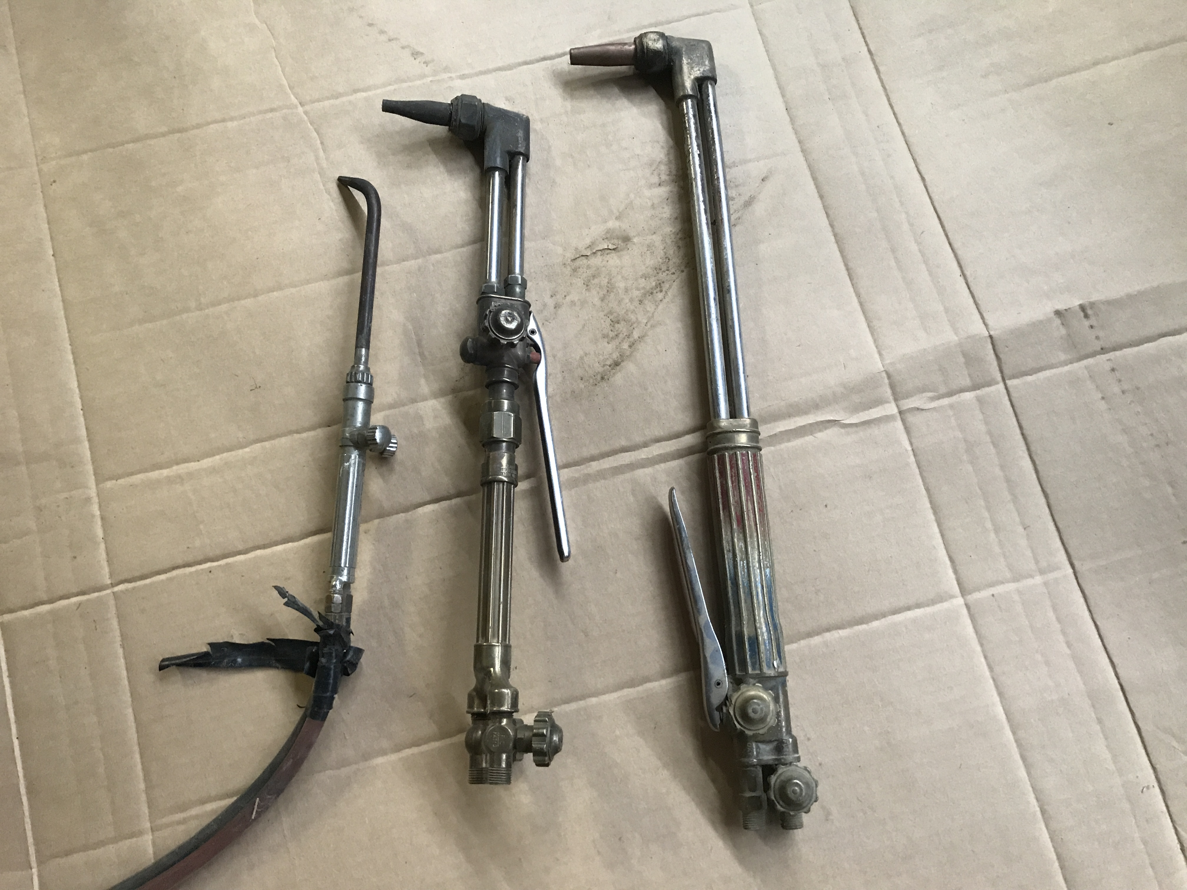

I have an oxy-acetylene tank set with a welding torch on it. It's the leftmost torch in the picture, the one connected to the hoses with some pieces of electrical tape on them :eek: I use that torch to heat bolts and such but it's not a cutting torch.
I have these two Victor torches as well but I have never used them for two reasons: (1) the hose connections don't match the hoses I have and (2) I don't know how to know if they are safe to use or not.
Obviously the hoses I have aren't the best. Someone put electric tape around them for some reason and it's probably a good idea to replace them. Can I get new hoses that will work with both types of torches? The welding and cutting torches each have different fitting sizes. And is it reasonably safe just to try out the cutting torches or should I tear them apart first to check for problems? I haven't used a cutting torch in 10-15 years but it would come in handy around the shop. I just don't know what's the best way to proceed here.

Electrical tape is a No-no.. There are 3 hose fitting sizes. A,B and Rail Road. You wont see rail road much. It's the larges one of the 3. There are adaptors available that screw onto a B fitting to go to an A and Vise versa.. You can also heat with the other two torches just dont push the cutting lever. I have a few mini rose buds that go on these Victor units you simply replace the cutting tip with the mini rose bud. I have acetylene and alt fuel mini's.

The left torch is a brazing torch used in plumbing single stage middle torch is a two stage rig right side rig is a single stage (gas axe) used for scraping out steel can also be used for cutting yes you want to get a new hoses and add check valves so keep your tips clean and you flame hot.

Don't take anything apart other than changing hose,putting gutting head on torch body and switching tips. Repairing torches is a specialized procedure requiring parts you will have trouble finding. Take everything you have,including tips to a welding supply house. See if they will give you credit for parts you will never use and sell you a torch body with B hose fittings,a cutting attachment for the torch body and some welding tips and cutting tips.
If you can't work something out to trade spare parts or if cost is more than you want to spend,buy hose with B fittings, B fittings for the gauges. That will alow hooking up the cutting torch on right. A #1 or #2 cutting tip is probably all you need for now. That set up will heat as well as cut but will not braze. If you decide to buy a new set,consider one suitable for propane/oxygen. That usually only require's type T hose and special tips because most gauges will handle acetylene and propane. If you plan on brazeing,stick with acetylene because propane won't work for brazng.
