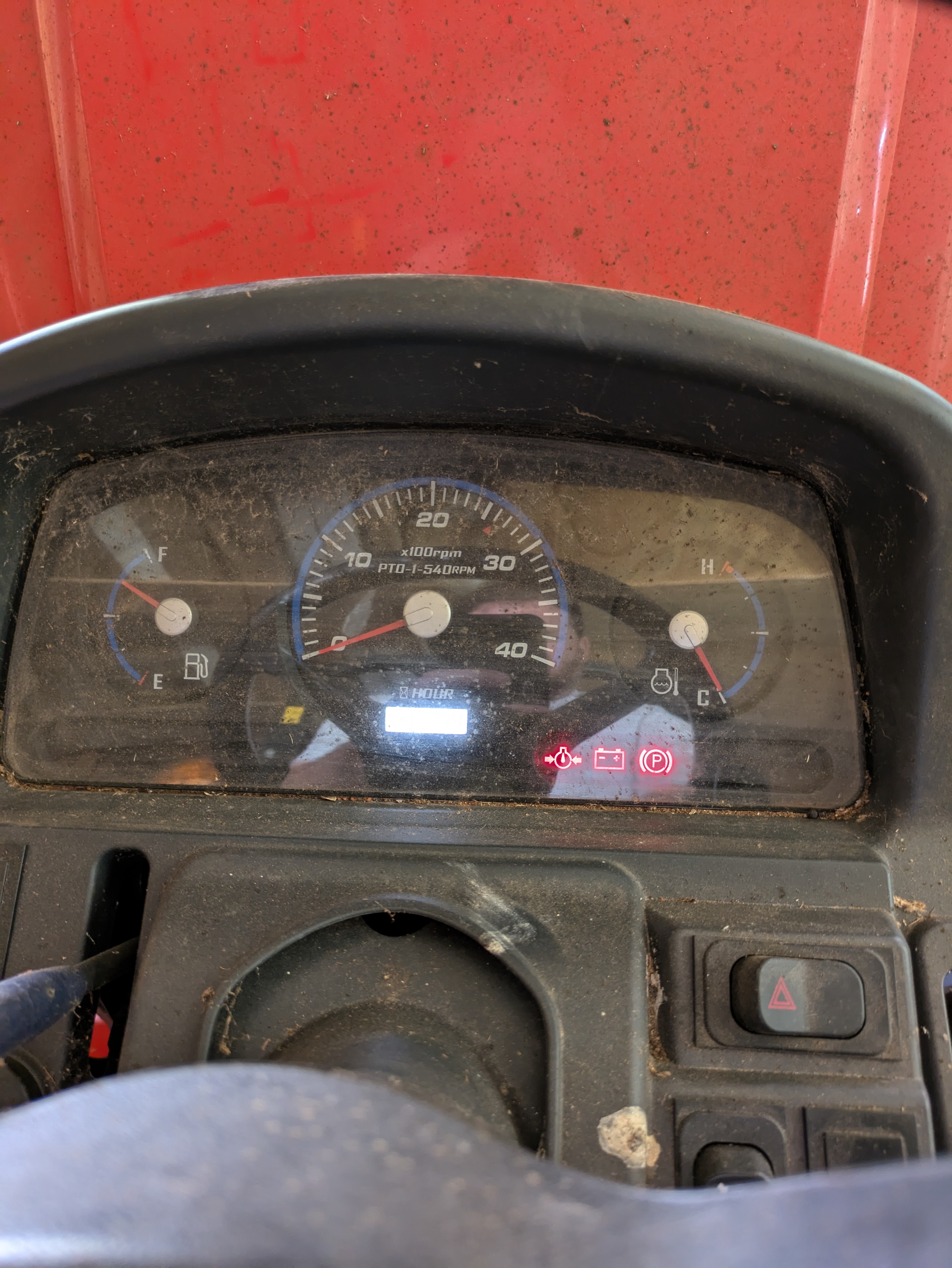

CX2510 I've had for about 3 and a half years, 160 hours or so. It's done great for me up until yesterday. I used it this past weekend but went to start it, when I turn the key to <On> the dash lights up as it usually does, the tac sweeps and all looks right. When I turn the key to <start> I get nothing. Parking brake is on, brake lights lit up, clutch pushed in, in neutral and PTO disengaged. I'm getting 12.6v on the battery and the same on the starter post. I'm assuming it's one of the safety switches because there's no clicking or noises or anything. Is there a way to bypass the safety module just to narrow it down to a safety switch? I have the factory service manual and see where all the switches are so I can go down the list one by one but a couple will require removing panels. Any help would be appreciated.

I double checked the fuse for the safety controller and there's continuity. I had totally forgotten I had this fuse break on me a couple years ago and while I was searching for solutions to no start issues found my old thread from the way way back of 2 years ago. :p Anyway, when I twist the key back to light the glow plug I don't get the glow plug icon lit. Pic below when twisting the key back.

I swapped out the safety controller and I'm back in business. Apparently there's a TSB out there for this exact issue and dealers can replace it at no charge but my serial number didn't fall in the range. So I'm out $160 on the part and 15 minutes of effort. Pic of the old controller and bag of new part number.
/ CX2510 No start situation (resolved)
Also, if anyone else runs in to this, before I fired up the tractor I twisted the key back to the glow plugs and the amber glow plug icon lit up on the dash. So if you're not getting that lit up this might help you zero it down to the safety controller.
