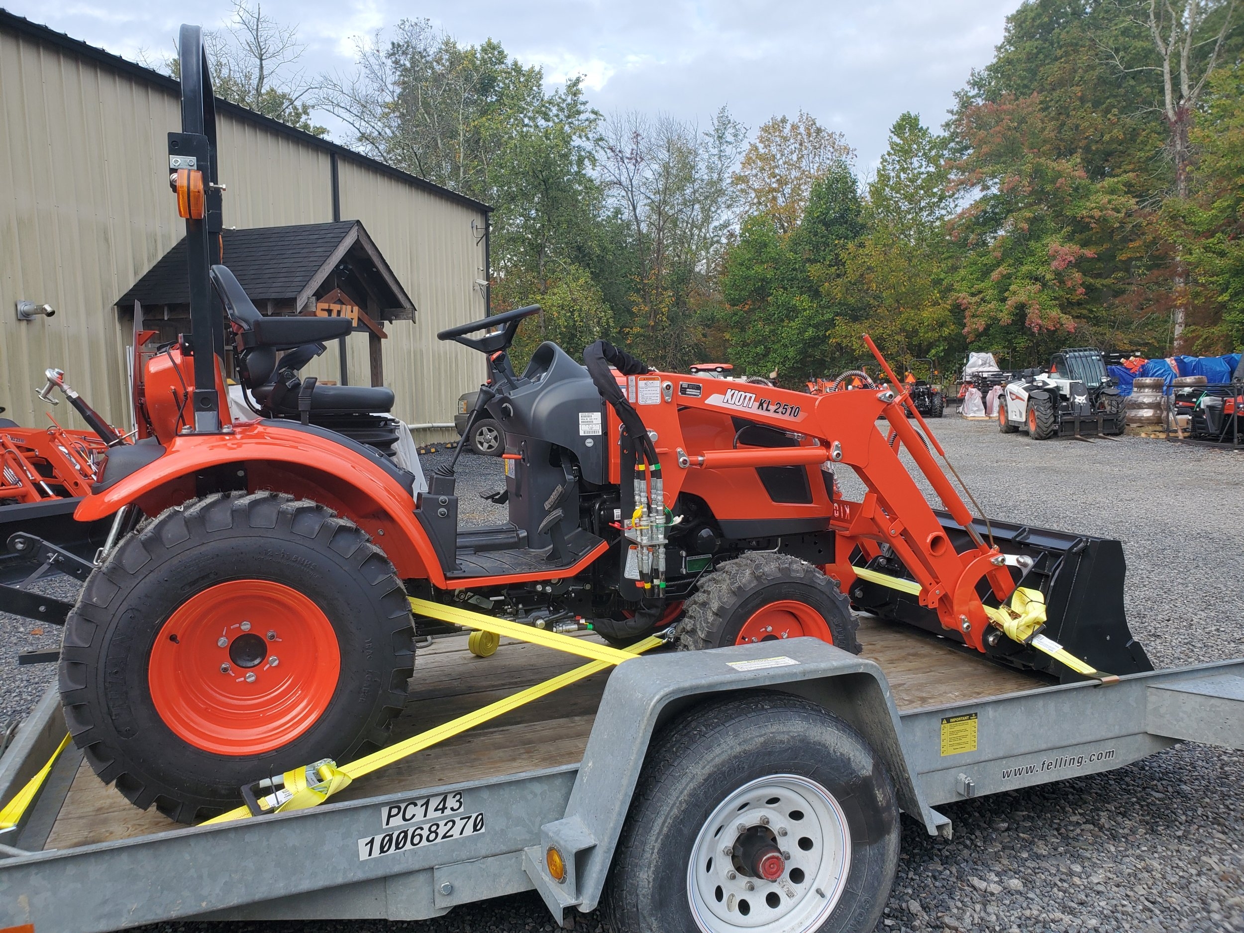

Ok, for the CX2510, your wheelbase is about 60", and the length from the front axle to the end of the bucket is about 60", for a total of 10 feet.
Add say 2 or 3 feet behind the rear axle, and you get a 12 to 14 foot trailer minimum.
2308 lbs for the tractor + 605 lbs for the bucket = about 3000 lbs. So, the trailer needs some strength, but nothing insane.
If you go with a super short trailer, you may struggle with getting the weight distribution right, and you will have to play around with loading it forward vs backwards.

I've hauled my Yanmar 424 on a 12' trailer a few times, but I have to remove the bucket and load it backwards in front with the loader arms sitting in the bucket. A CX2510 is about the same length, so I would say 14' minimum if you want to haul it with the bucket attached. I much prefer hauling it on my 20' car trailer.

My CX fits in my 14' dump trailer with my counterweight on it with not even 1/2" to spare. With nothing on the 3 point it will have plenty of room.

I rented one from Sun belt rentals to take mine to the dealer.
Felling FT-6T-G 12 ft S/A Tilt Deck Trailer​
