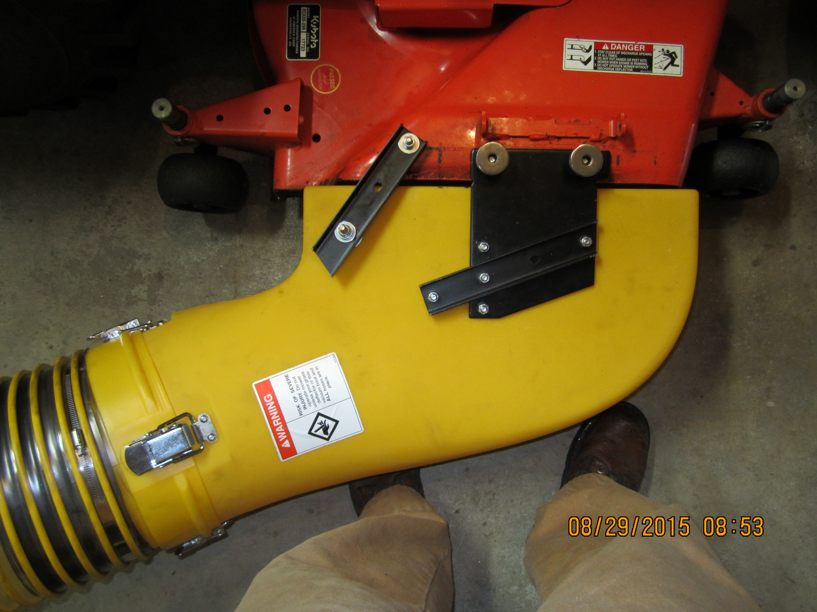

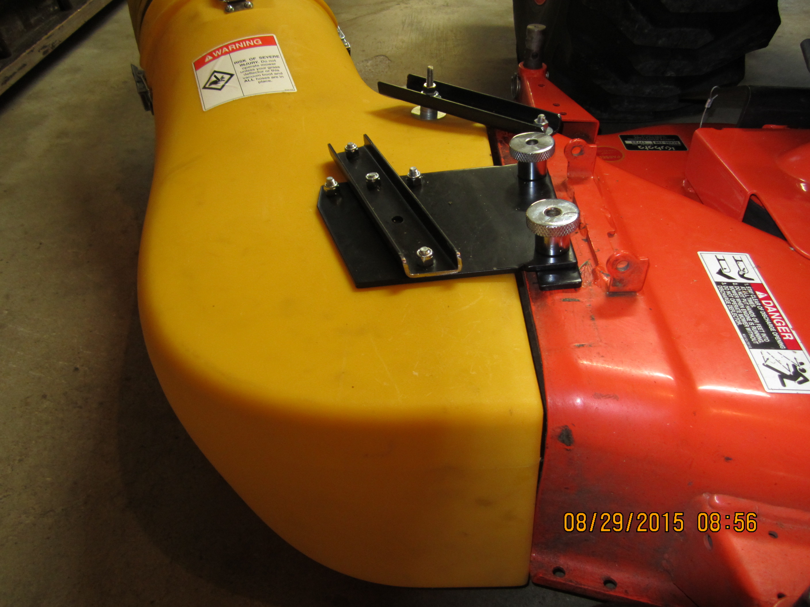

Hi Couple of Achers, I just bought Cyclone Rake for my Kubota B2620. I don't really like the fact that the mower deck adapter is smaller than the mower deck opening. CR said it's the biggest one they have. I just talked to Kubota dealer about it and he was confused of what I was talking about. He will probably email me later if he found more info. Is the Kubota's chute able to float up on terrain changes? How is it connected, rigidly or is it connected to the same connector used to connect grass deflector. IMG_7761.JPG
   / cyclone rake on B series? #14
It was my own adaptation to the materials provided by CR. Works okay for me.

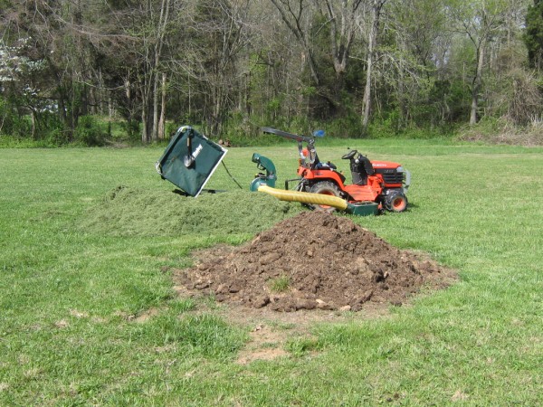

I've been using a CR behind my BX23 for 12 years now and it does the job I originally got it for. Someone asked why collect grass, one word, compost....
I mow 2 acres weekly during season and 2 other acres every 2 weeks. I mow (side discharge) in such a way as to make 8 windrows. I then quickly connect up the CR, pickup the windrows and dump them in a big compost pile. I'll do this every 3 or 4 mows. I turn the pile once every couple weeks with the FEL and by late spring I have fresh compost for the garden. I don't add any browns or any chemicals, just fresh cut grass.....I haven't had to use any fertilizer on the garden I use the compost in.
I find that as soon as I see the CR spitting grass out the side discharge ports and shut the blades off the CR won't be filled so tightly which makes it easier to dump.
I usually just mulch up the leaves and leave the bits and pieces lay. Most of my big leaf producing trees are getting killed off by the Emerald Ash borer so I don't have the leaves I used too.
I use gatorblades on my 60" MMM and slap a home made mulch plate over the discharge port which does somewhat OK on the leaves.

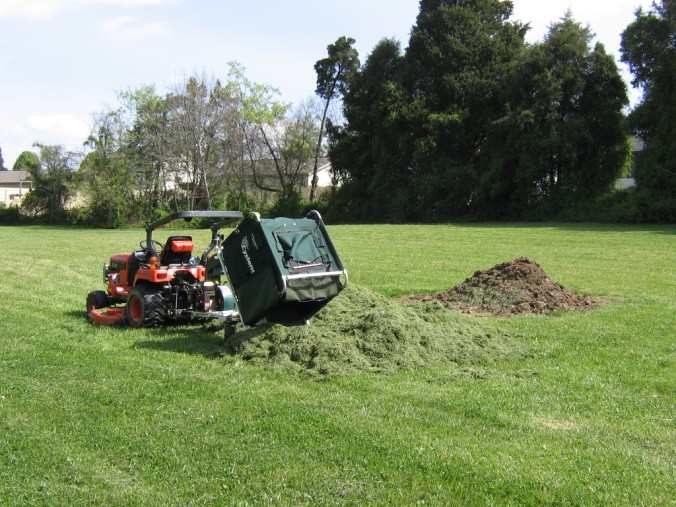

Here's my hookup on the B2620 using the CR adapter.View attachment 570533View attachment 570534

Hi Mike, thank you for the pics! Those really help! I wasn't convinced since the MDA was too small. Do you think it will be fine with my uneven terrain? Will it give a little if it got hit from the bottom? Is yours Z-10 or XL? Mine is XL. Did you use jigsaw to cut the hole?
   / cyclone rake on B series? #18
Quite honestly, I don't remember ........but probably used my old Craftsman jig saw to cut the opening in the MDA. Not knowing how rugged your place is, I'd say the MMM will glide over the terrain as good as it usually does, even with the CR attached. I bought the Z-10. IIRC, the times that I need the CR people to assist me with questions or replacement parts that they were quite helpful.
