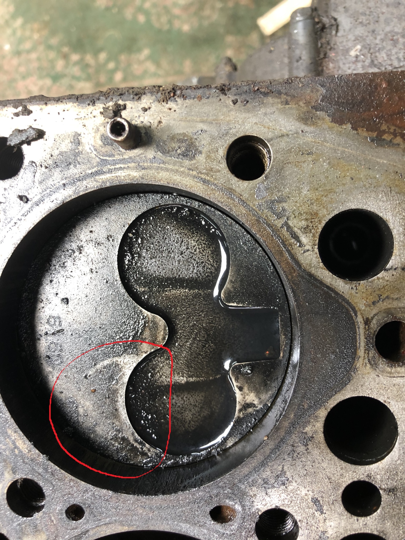

You haven't responded to your other thread in a while so I'm not sure if you have read the other opinions there. I am copying one of your photos from that thread into this one to continue making a point.
As I said earlier if you don't figure out why the valve contacted the piston and correct that issue everything else will be for naught.
In this picture it appears the valve contacted the piston to the left of what looks to be valve reliefs that were cast into the top. IF that is what the depressions were for it could be the engine had been apart and someone installed the pistons backwards. Pistons HAVE to go in facing forward as defined in your service manual. They may also have to be on the connecting rod a certain way. You may not know this but the wrist pin is actually offset in most pistons with the longer side of the piston to the thrust side. It is very slight but if you pull a tape around on both sides you will find the difference.
Make sure you figure out how the piston goes on the connecting rod and which direction it should face in the cylinder before you put it back together.

That seems to be the million dollar question....
This engine appears to be a Shibaura as it has a Shibaura tag on it However, Shibaura and Perkins had a joint venture on these small engines for 20 years. In fact a few years ago Cat/Perkins bought out IHI Agri-tech - which was or includes Shibaura. I think maybe 30-40 years ago you might be able to classify an engine or machine as "good quality" based on the reputation of the manufacturer (CAT, case, Deere, etc) and we all know some manufacturers had stronger and weaker traits.
Anyway here is what I know: Both push rods on the number one cylinder are bent and there is clear evidence (there is a pic in mashed pushrods thread) that at least one valve in that cylinder hit the piston. All 4 pistons are pretty well scored.
The machine shop looked at the head and said right away he can tell the head gasket was leaking. He said when the head gasket leaks, "it heads for the cooling passages and pushes the coolant out and they overheat. That's what happens to these engines." We discussed the push rods but he didn't seem to have much to say about it. I asked him if the thought the deck of the block would be warped and he said probably not, but check the cylinders for roundness, they come out of round when they overheat.
I did check the block and it looks good. The cam shaft is excellent and within factory spec, the crank/rod bearings all looked good. The only other weird thing I found was the oil pump shaft is worn quite a bit on the top surface only. I looked at the pump cam thing briefly and it looked fine.
So bottom line we have: Bend push rods (cyl 1), Valve contacting piston (cyl 1), Scored pistons, worn oil pump shaft. And that is all I could find for damage.

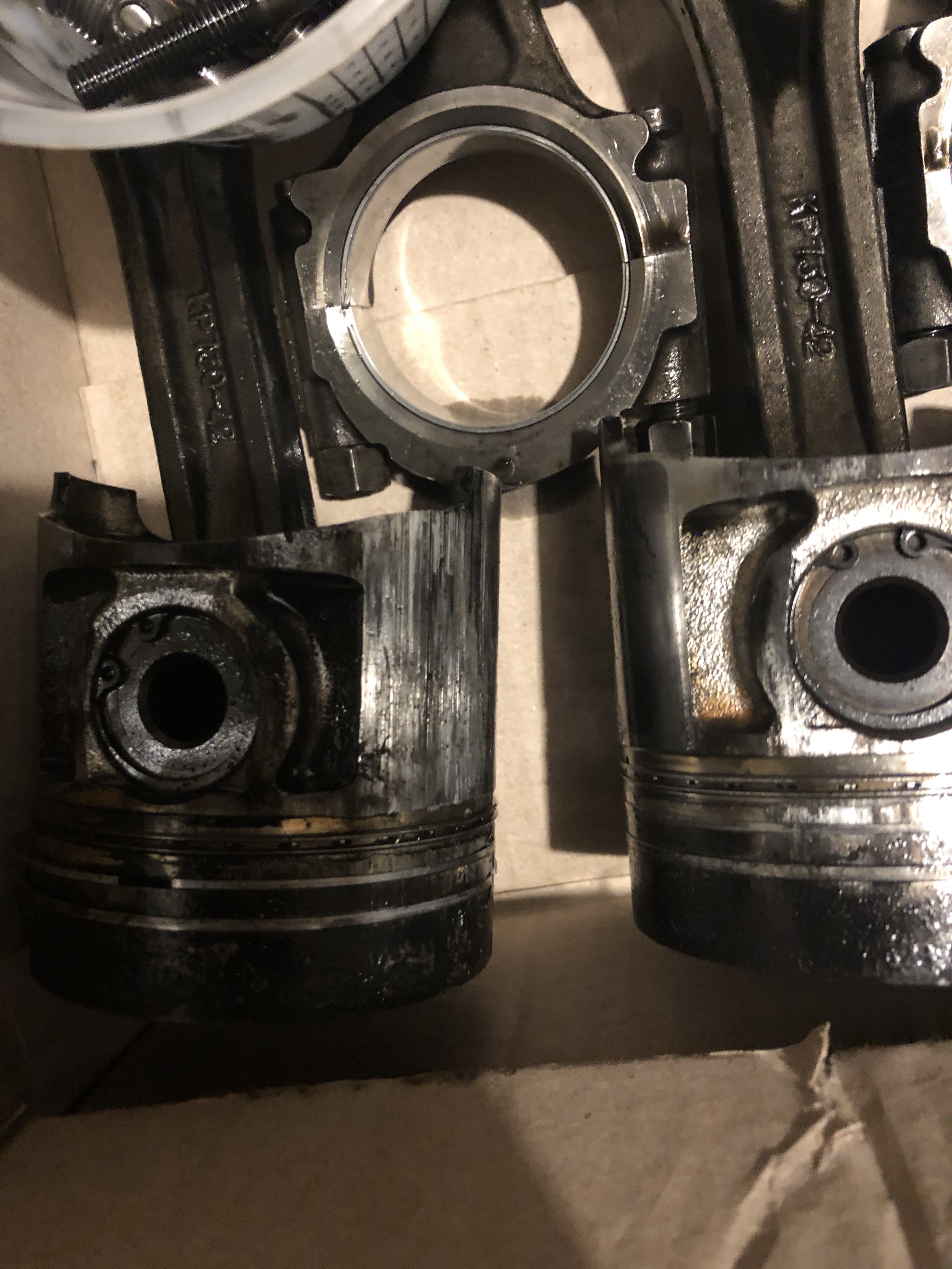

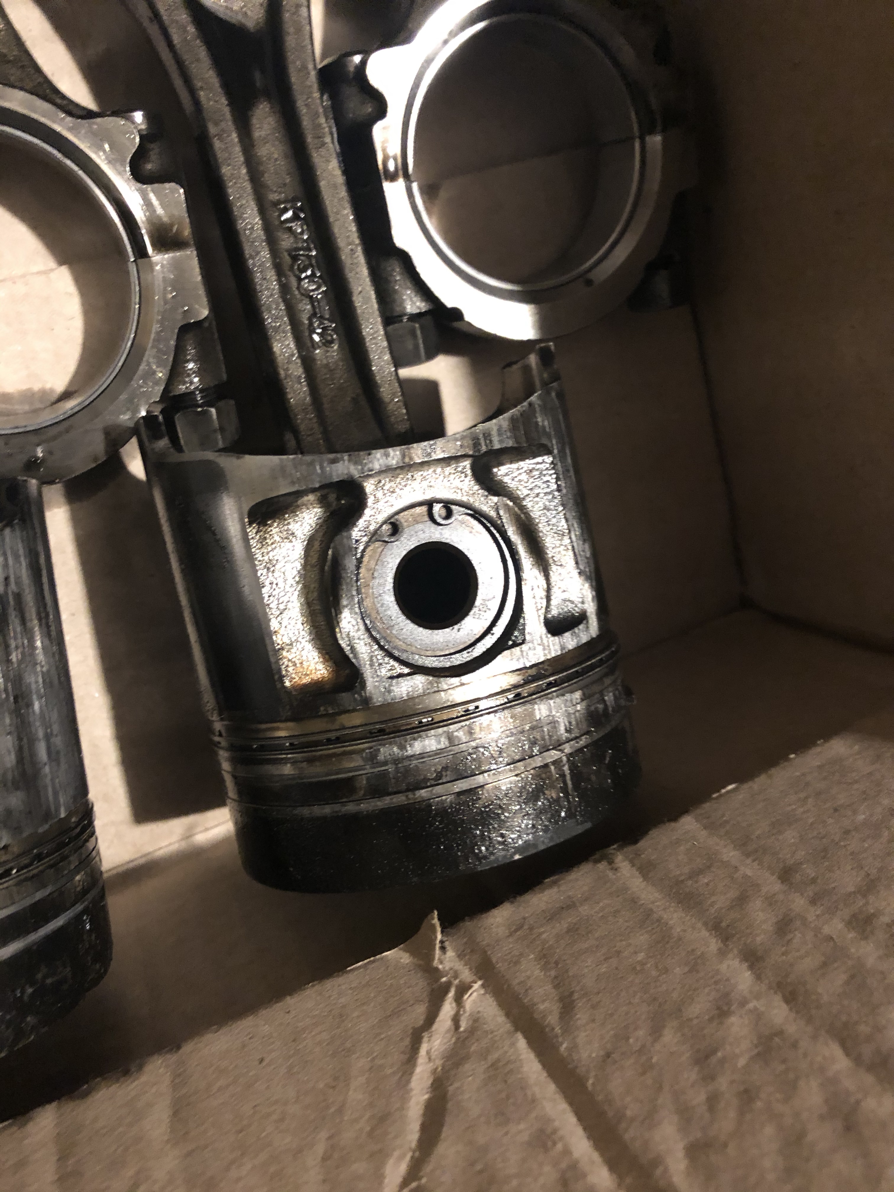

Could be it hydro locked a little bit? The valves could not open all the way and the push rods bent? The pistons do look scuffed on one side.
   / cyl bore tolernaces - follow up to mashed push rods #15
Hydrolocking doesn't happen all that often.
The right side piston shows the pin offset.
The left most piston skirt shows that piston was not getting enough oil. I can't tell if the right side piston skirt looks the same. That may not have been the only problem but it was a problem for sure. That's why there's aluminum on the bore.
On a plain bearing engine there is usually a lot oil flying around, plenty to lubricate the pistons on a low speed engine like this. Unlike the bearings it doesn't require a minimum oil pressure to lubricate the pistons, just some oil flowing. I'd look carefully for bearing damage and be sure to replace the pump. Maybe there's plugged oil passages too.

Great point with the pistons. There were a couple versions of this engine and it appears that some versions had a cylinder projection above the block and some did not (mine is below the block). Maybe the same pistons were used and the recess is for valves on that other engine...? I really don't think this engine has been apart before, but its certainly a possibility. I will double/ triple check the piston orientation. It is noted in the manual, but I did not fully understand what they were referencing on the piston as I did not have one in hand at the time.
