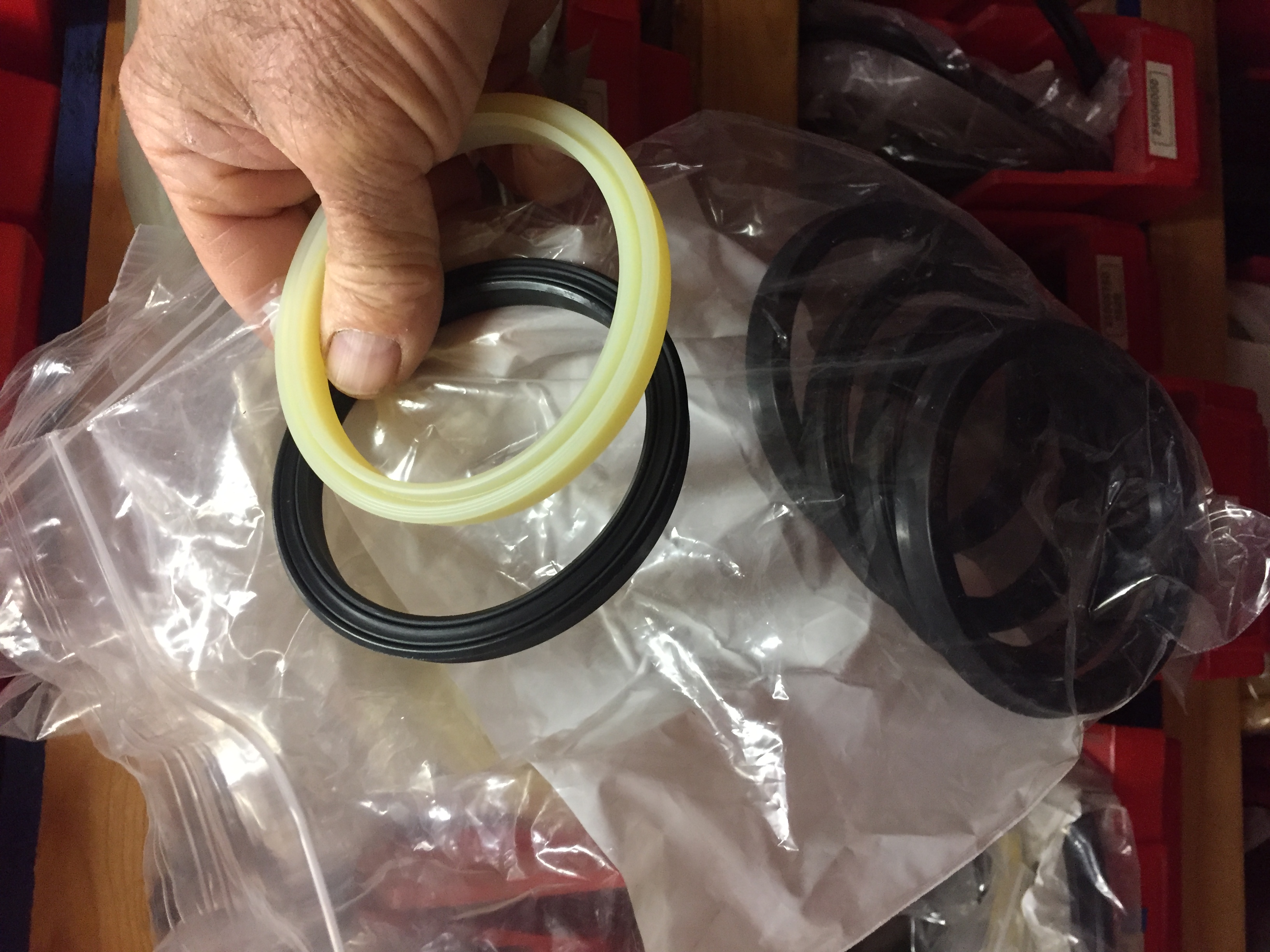

Mar 2, 2020 / Cylinder seals #11 wdchyd Elite Member Joined Apr 16, 2010 Messages 3,256 Location Hooksett, NH Tractor Kubota B2320 That would explain you asking about the leather piston cups. Here’s what belongs in those two grooves, either of these two styles.

Mar 2, 2020 / Cylinder seals Thread Starter #12 OP G granitepeak Bronze Member Joined Nov 13, 2019 Messages 50 Tractor MHF 202 The bucket cylinder does have leather cups. Going to send you a message.
Mar 2, 2020 / Cylinder seals Thread Starter #13 OP G granitepeak Bronze Member Joined Nov 13, 2019 Messages 50 Tractor MHF 202 wdchyd said: That would explain you asking about the leather piston cups. Here’s what belongs in those two grooves, either of these two styles. View attachment 643581 Click to expand... What would be the name of the type of seal in the picture? After calling a number of shops, I finally found one that has parts but he asked what kind is needed for the piston? Thanks, Don Last edited: Mar 2, 2020

Mar 2, 2020 / Cylinder seals #14 wdchyd Elite Member Joined Apr 16, 2010 Messages 3,256 Location Hooksett, NH Tractor Kubota B2320 U25-3.00-37B...(black seal) ...or........DPU25-3.00-37 (yellow seal) Parker #25003000-375B They’ll know
