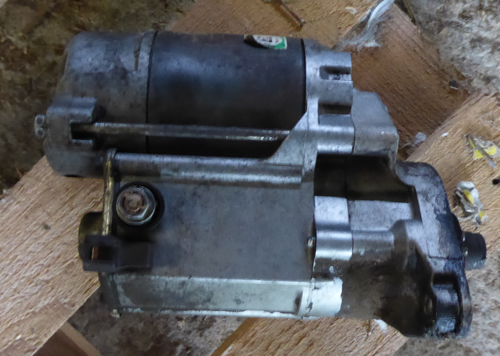

On these starters I don't think the solenoid is a replaceable part, they're sort of round the other way from most starters with the motor piggy backed onto the solenoid. See photo, the solenoid is the lower module with the terminal stud, the motor is mounted above and drives via an reduction gear.
I can rig up something to test that voltage-to-the-solenoid idea, a heavy cable with a push button that I can temporarily rig up next time it's in a sulk. It might actually explain why messing around with different batteries persuaded it to play the game in the first instance. Not so much the last time as I left the battery on charge overnight and it didn't work the next morning.
