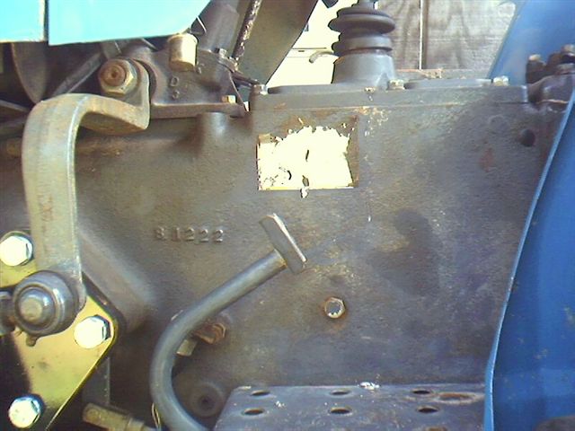

with the loader attached now i have to recheck the oil in the hydralic case.there is no dip stick. what do i do?
   / d1850fd #14
There should be a check plug on the side of the trans/rear end case. On my tractors it just looks like a bolt that has nothing attached to it. Put the oil in the top and when you see it running out the side, your done. It's a little messy but if you are just topping off that how it is done.

#15
can u put up a pic. i looked and found a nut on the clutch side. i found the oil rotella 15w40 at auto barn. 12 dollar gal. i found trans/hyd oil at john deere dealer 58 dollar for 5 gal bucket.
   / d1850fd #16
Can't post a pic cause I don't have the same tractor as yours but generally they work similar. Try other sources for the transmission/hydraulic oil. Check with Tractor Supply, Wal Mart, etc. Per other posts on TBN they have it. 58 is too high for trans/hydr. oil. Think I saw it for $30.00 at TSC 3 days ago.
   / d1850fd #17
You have a level plug on the right side of the transmission behind, and about on the same level as, the differential lock pedal. Send me an email and I'll send a photo with its location. Better yet, consider buying a operators/maintenance manual from me. Bill - satohparts.com

#18
there is another plug on the other side near to the clutch.what is that one for? i saw the one u spoke about it is just above the filter screen access.

   / d1850fd
#19
what is that bar thing that is near that plug bolt.looks like some kind of brake lever.what do u use it for?hey oliver i put up some pics does it look like yours?
   / d1850fd #20
I'll have to look at mine. Is the plug on the clutch side at the same level as the plug on the brake side? The brake side plug looks lower.
