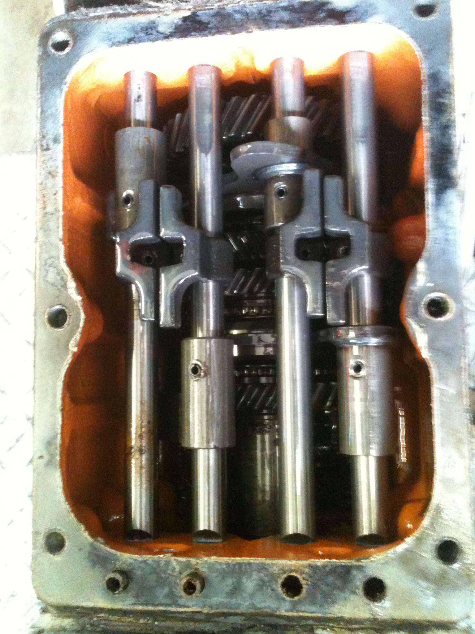

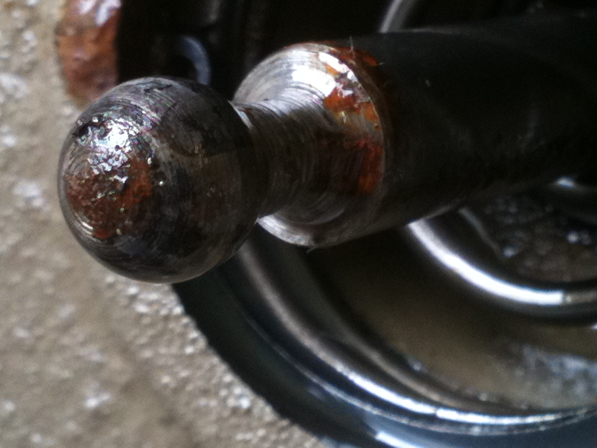

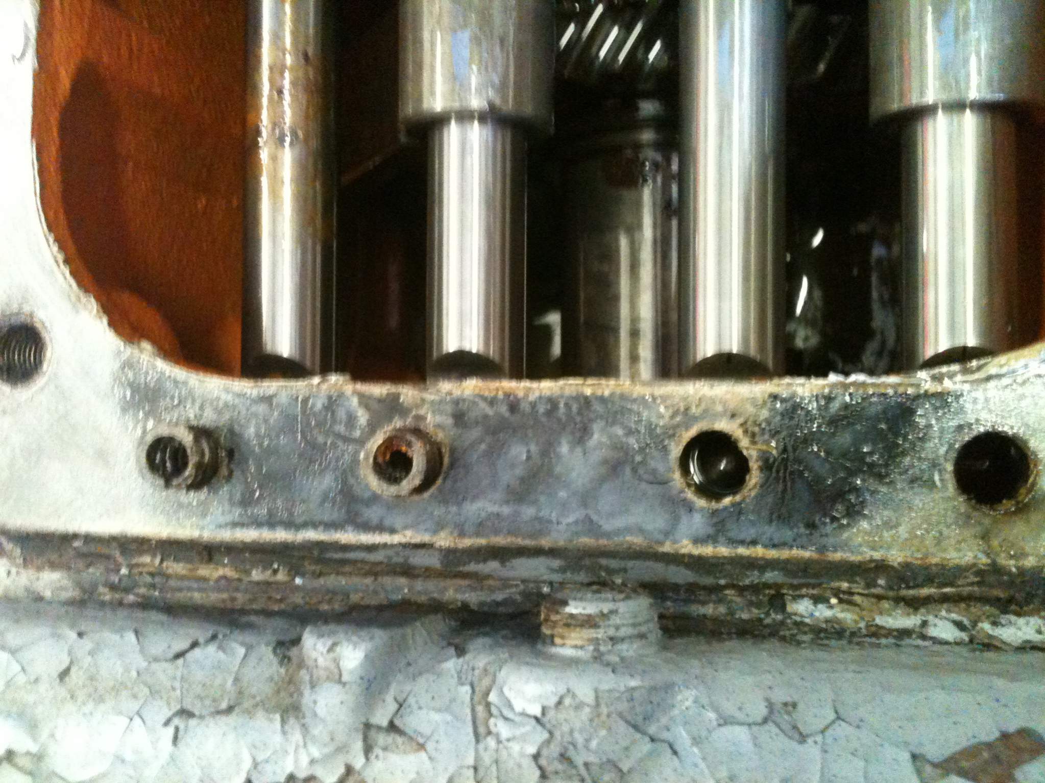

I removed the bolts from the shift cover and tapped it with a hammer and it popped up and I removed it. You can see a small amount of rust on the shift rails which cleaned up nicely.
There is some minor rust/corrosion on the springs and housing but they will clean up OK.

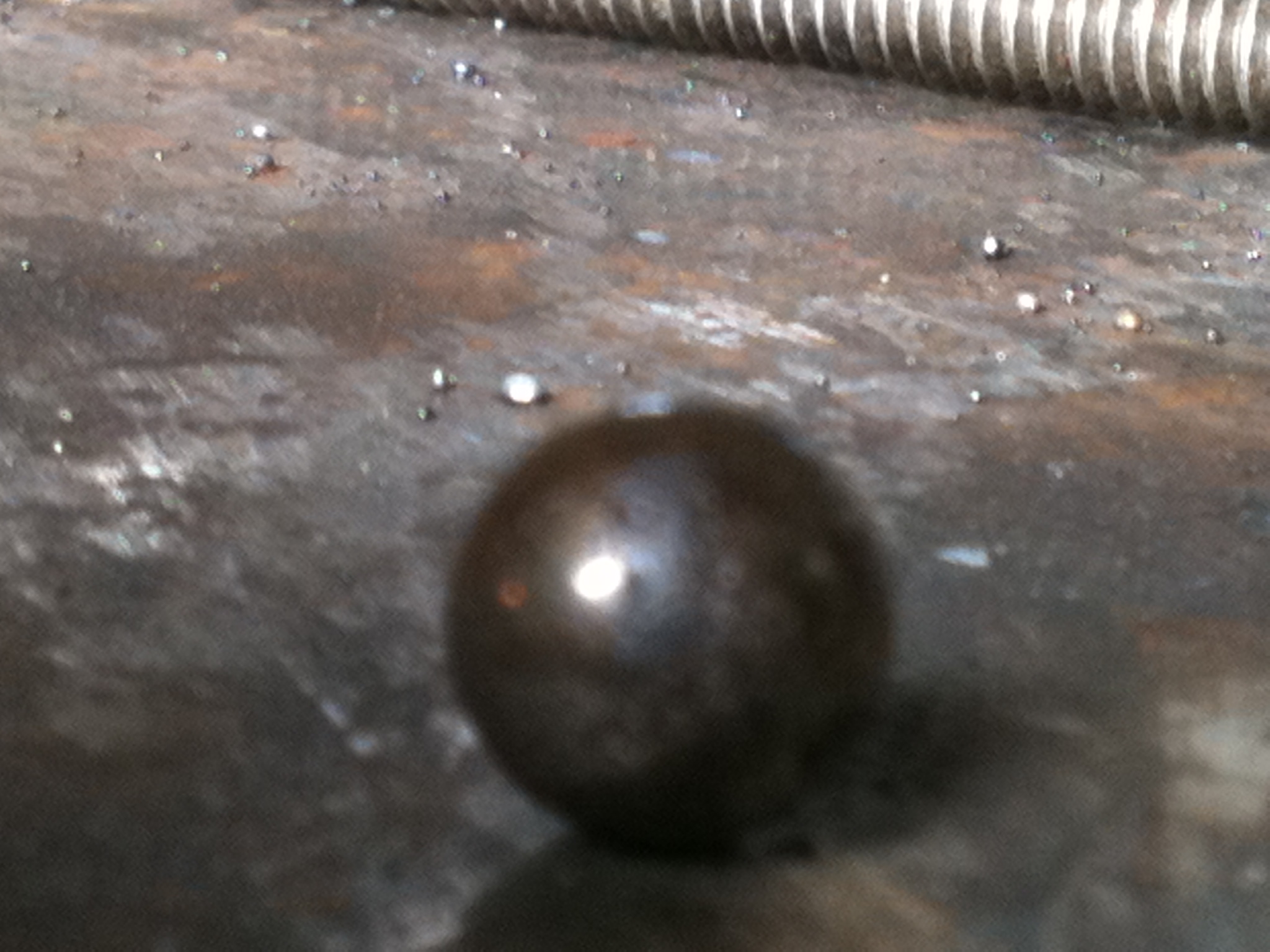

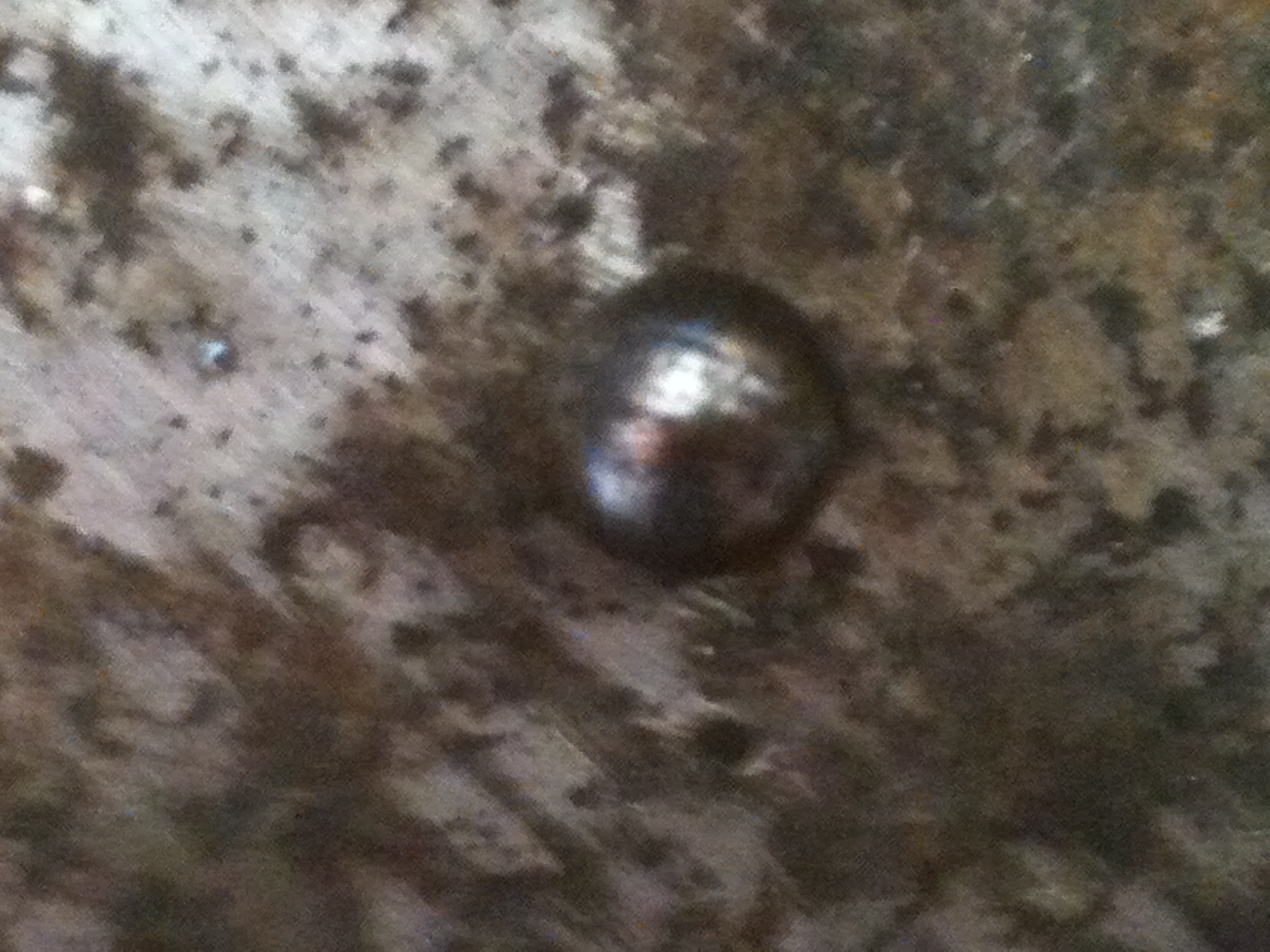

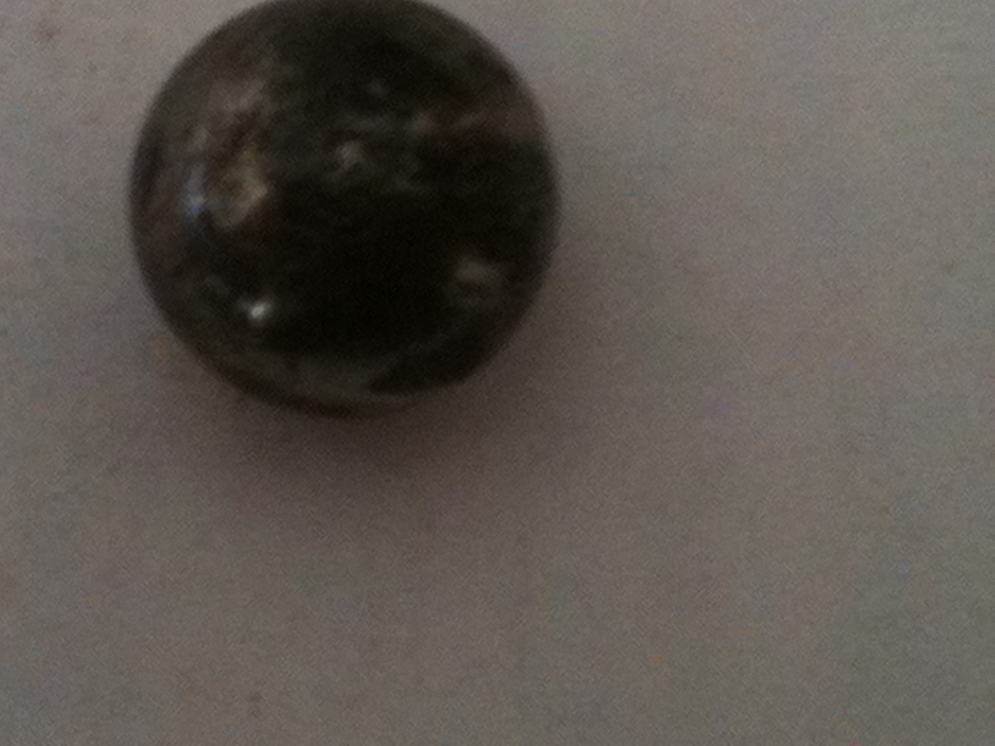

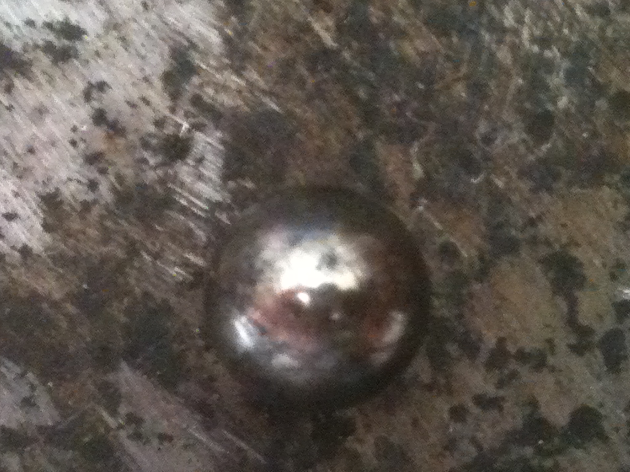

The detent balls are trashed. Rusted and pitted. I ordered some new ones from Valley. I'll have to clean up the holes where they go and flush out any crud.
The shift levers showed some rust which cleaned up good. I used some fine steel wool to polish the tips where they contact the detent balls.
This appears to be the result of transmission oil that was badly contaminated with a lot of water. I should be getting my parts in a few days. I'm looking forward to putting it back together and checking it out.

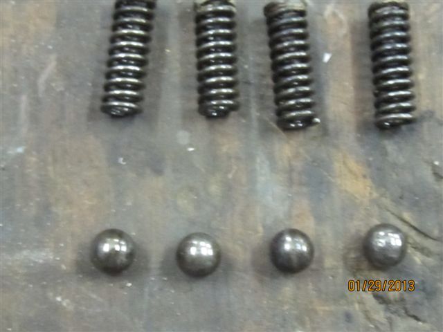

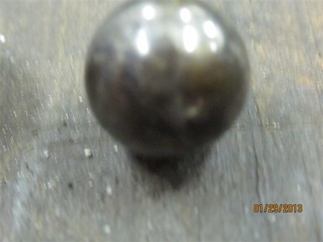

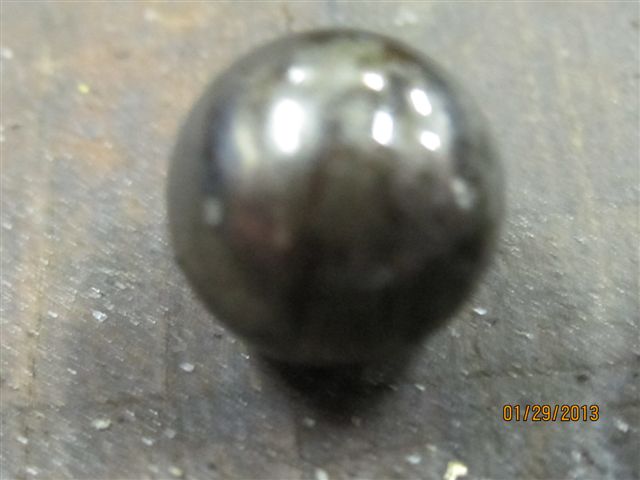

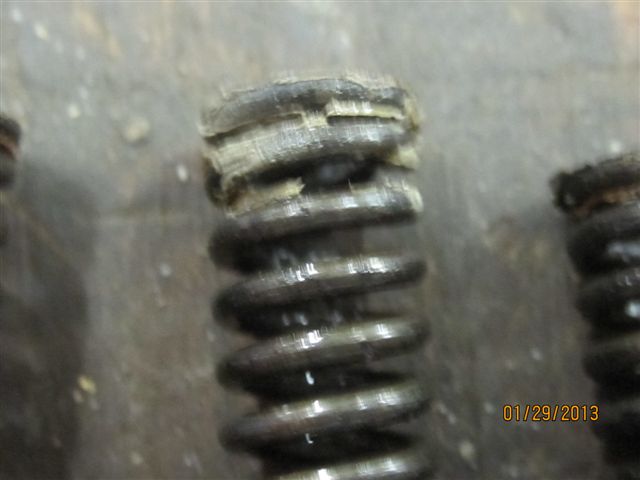

I got my wife's camera and took a few pictures of the balls and springs hoping they would be better and they are somewhat. Some of the thumbnails look better than the big picture-more focused.
Tractor Ball 4.jpgTractor Ball 3.jpgTractor Ball 2.jpgTractor Spring.jpgTractor Shifter 1.jpgTractor Balls_Springs2.jpg
The grunge on the springs turned out to be sealant. I'll keep y'all posted with my progress.

I got the balls yesterday and installed them last night. The new balls took a lot of slop out of the shifters. I ran it back and forth a few feet in the shop checking all the transmission and pto gears and everything is working fine. I'll have to wait til I can run it for an hour or so to find out if the problem is solved but I feel confident that it's OK.
It was an easy job.
