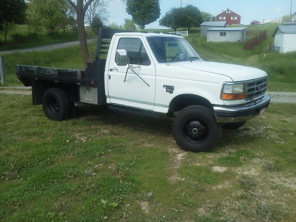

Well it certainly has been a while since an update so here goes:
since the last update, it was my daily driver but it developed some fuel leaks and need some attention to a few things (intercooler hoses not flared and blowing off under load, lack of power, sticking injector) other than that it started reliably got 18 mpg and was in my opinion the coolest ride around.
at this point I started a new job and questioned the reliability of the truck as is to get me there, so I bought a new daily. a 2007 toyota fj cruiser as a more comfortable way to get me to work and back. the truck then became a weekend ride and work truck as needed.
soon it went under the knife and I told myself that it wasnt leaving till it was all fixed!
after countless hours and being a predominant statement in the garage for the better part of a year it was back in the game after alot of fab work, injector pump, pisotn drive lift pump, new gaskets, valve seals, stock style injectors, wiring, full axle rebuilds, brakes, 19.5 wheels and new tires, the start of red to grey interior swap, etc. it finally fired up just like it had ran 10 minutes ago not 10+ months ago! and i pulled it out of the garage and went for a cruise. I soon discovered a leaking radiator and a bad gauge cluster, so back in it went.
heres some pictures to get you caught up.

what was the vintage of the 5.9? was a KDP era engine?

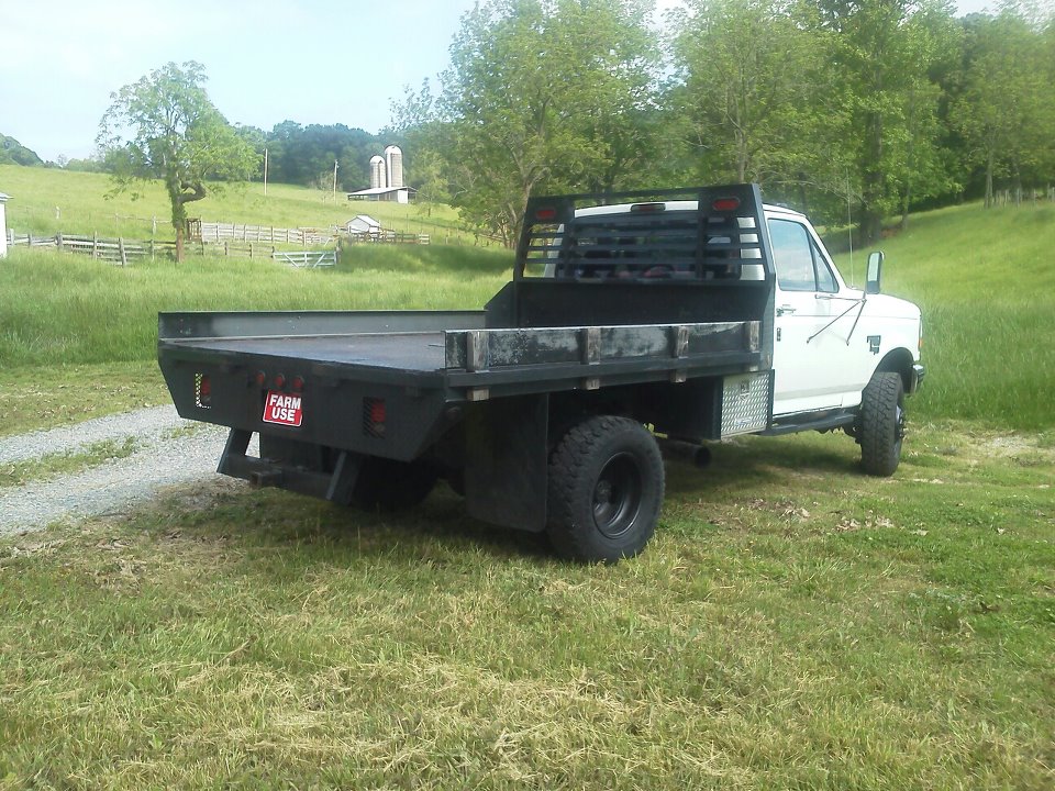

So at this point I fixed what was left on it, Sent my spare radiator off and got some deals on parts trucks to finish it. I have made good progress on the interior, I decided to go with 2004 F-150 power bucket seats and a 2006 F-550 center seat from my hookup at the local junkyard, To finish of the interior I have door panels, gauges, and the trim at the back of the cab to finish it up, It has turned out great so far! However I did not account for the amount of time that just the interior hjas takin up to finish.
At this point I had a fully usable truck once again, Ive hauled everything from firewood to lumber to even converting it to a Gin Pole setup to hoist the heavy wood stove up in my house through the door (shown lowered down in the pictures).
The Dream Machine as Its now called is off to get a good paint job in the correct factory black color here very soon, since every time I wash it more of the white flakes off. :laughing:
More to come soon!!!

The engine was orignally a 91 Non Intercooled Cummins out of a D250. The non intercooled have some point in there head design about being stronger anyway.
It was a pre KDP engine but since I was in there I piened to hole on 4 sides and tabbed it with a longer bolt and locktight, It was really necessary though because I dont think it had even moved at all, So I think the motor has Had an easy life, also the internals of the engine looked brand new with no sludge or dark residue at all. :D

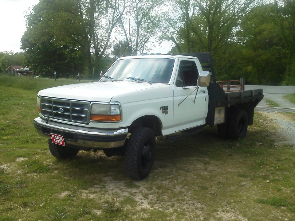

Not to rain on your parade mind you just want to mentioin what happened to my former neighbor's 92'. He had a bolt drop out and get jammed up in the timing chain, breaking the gear off the camshaft. Ended up he had to replace the head due to the damage.
The neighbor had happened by to see what I was up to on the day I was using the tab method on my 97' Dodge. After we talked, I checked my bolts and did find some that were less than spec.
Anyway, it is a cool ride and you can be proud. Way back when, I was on the TDR, there was a member that stuffed an 8.3/RR into an F250. He was pretty good with the fire stick and had to do some pretty impressive mods to the frame and all to support the weight of not only an 8.3 but also the RR. Not to mention the sheet metal mods to the floor to clear the RR.

Well I have heard of on these vintage engines the bolts are as big of a deal as the KDP thats why I took them all out and put the good locktight on them when they went back in, its going to take heat to get those babys out now!
an 8.3 cummins in anything less than a medium duty truck would be quite a feat. I dont know the exact number on those but I would guess they weight close to 1500 pounds with all the dress on them? It would pull good though i bet with all that torque. :thumbsup:
