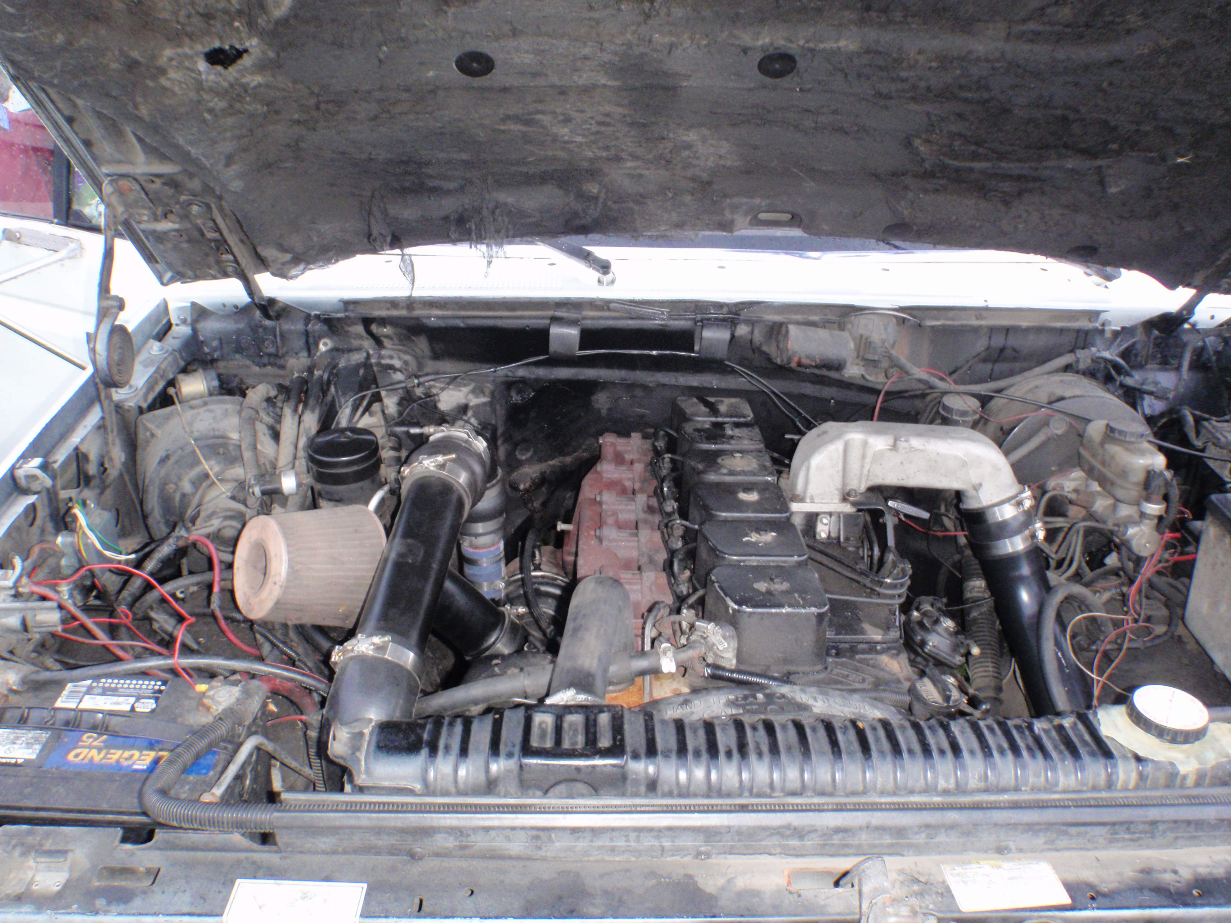

Nice truck. How is the trans mated to the engine? Does it have the ford transfer case? Did the engine and trans come from a 2 1/2 ford truck. Currently running 7.3 's turbo and non. Thank you for any info.

There mated together using a ford to cummins adapter plate you can buy. No the engine came from a 1990 model d250 dodge (non intercooled).
company's like this supply parts for the swaps:
Destroked - THE Cummins Conversion Company : Home Page
fordcummins.com - Increase Horsepower with Ford Cummins Diesel conversion kits

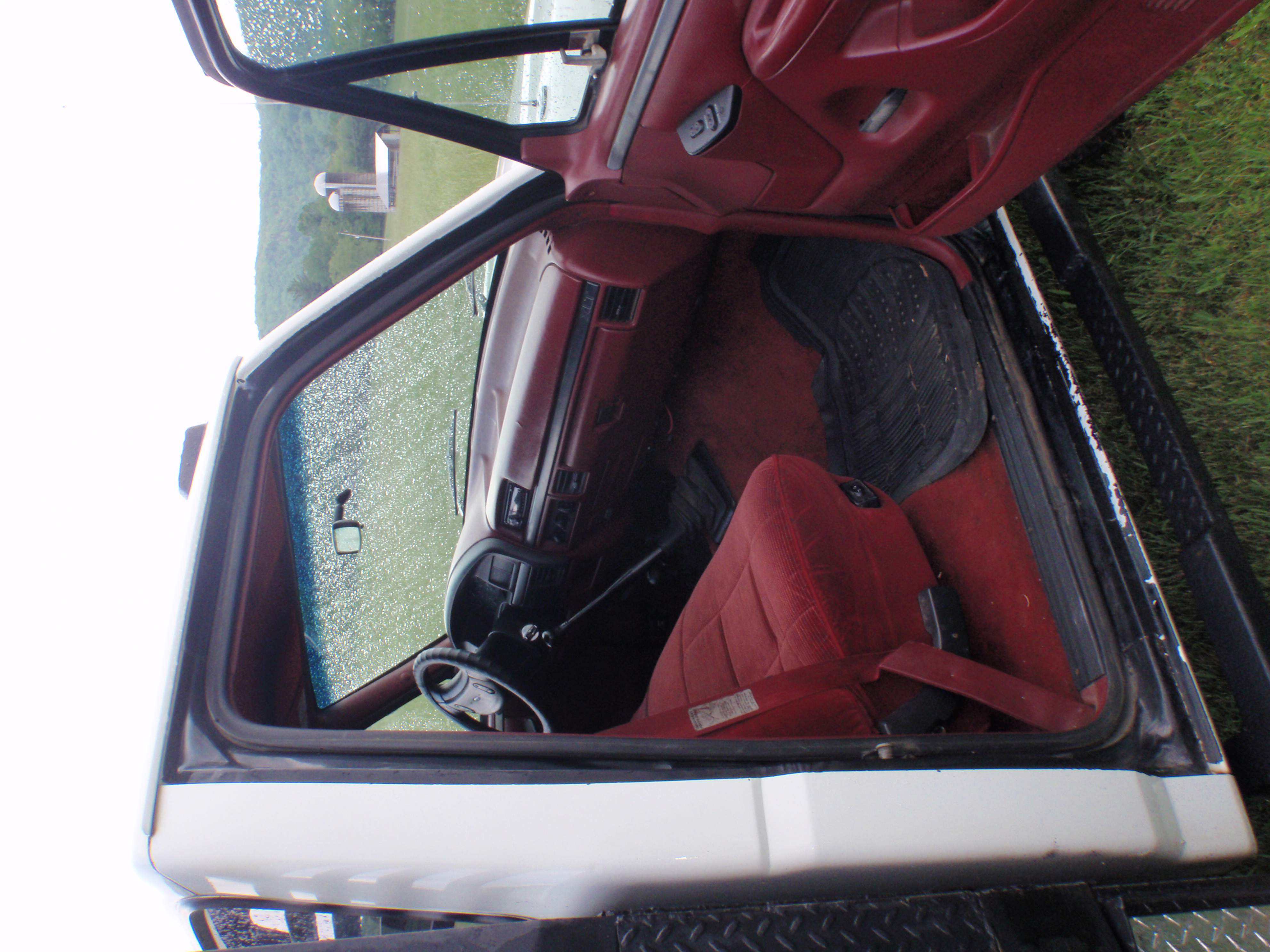

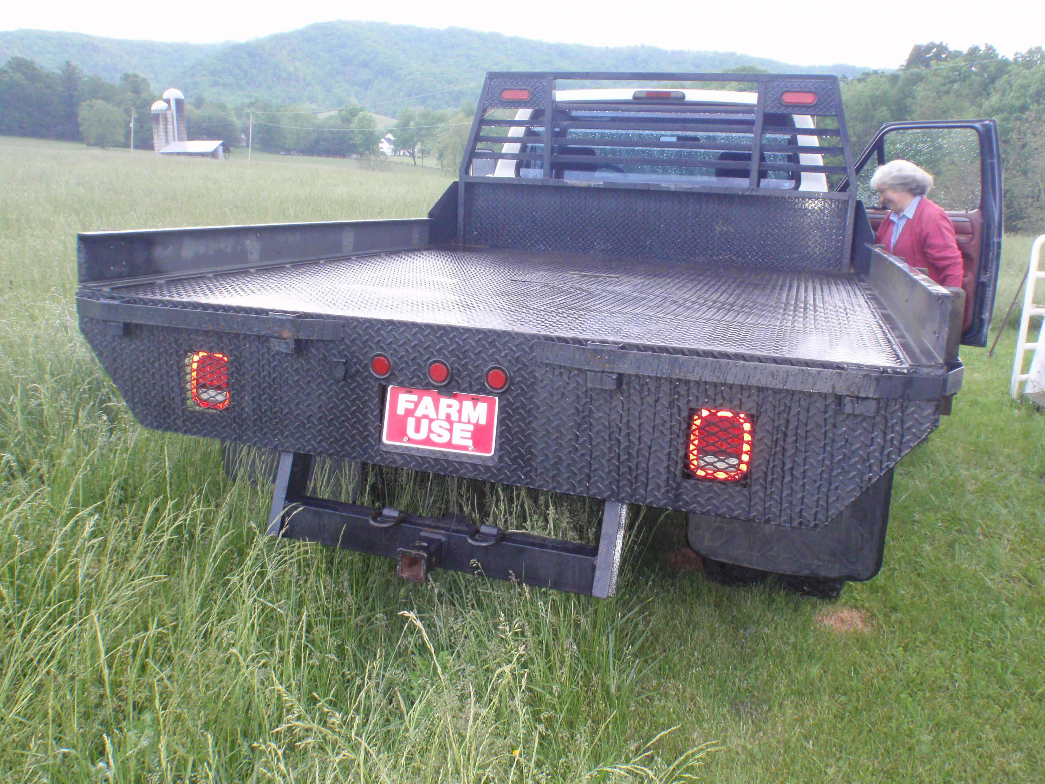

Well I went back to the house were the truck is currently at today to see what all it is going to take to get it up to my familys standards of daily driving roadworthy-ness.
So far from all of my checks it looks good, It looks like:
complete fluid/ filter change
some sort of new tires
one new headlight bezel
get the tachometer working (they didn't buy the adapter parts for the swap)
Check out the back fuel tank (been with out gas cap for quite some time)
put fuel settings back to normal
fix left hand speaker
new ignition switch (acts up every now and then)
windshield wipers
check on status of KDP
Clean!!!
Thats all I can think of for now. And thats plenty
-Mills
Here are a few pictures I took today: (last one is me being a proud papa):D

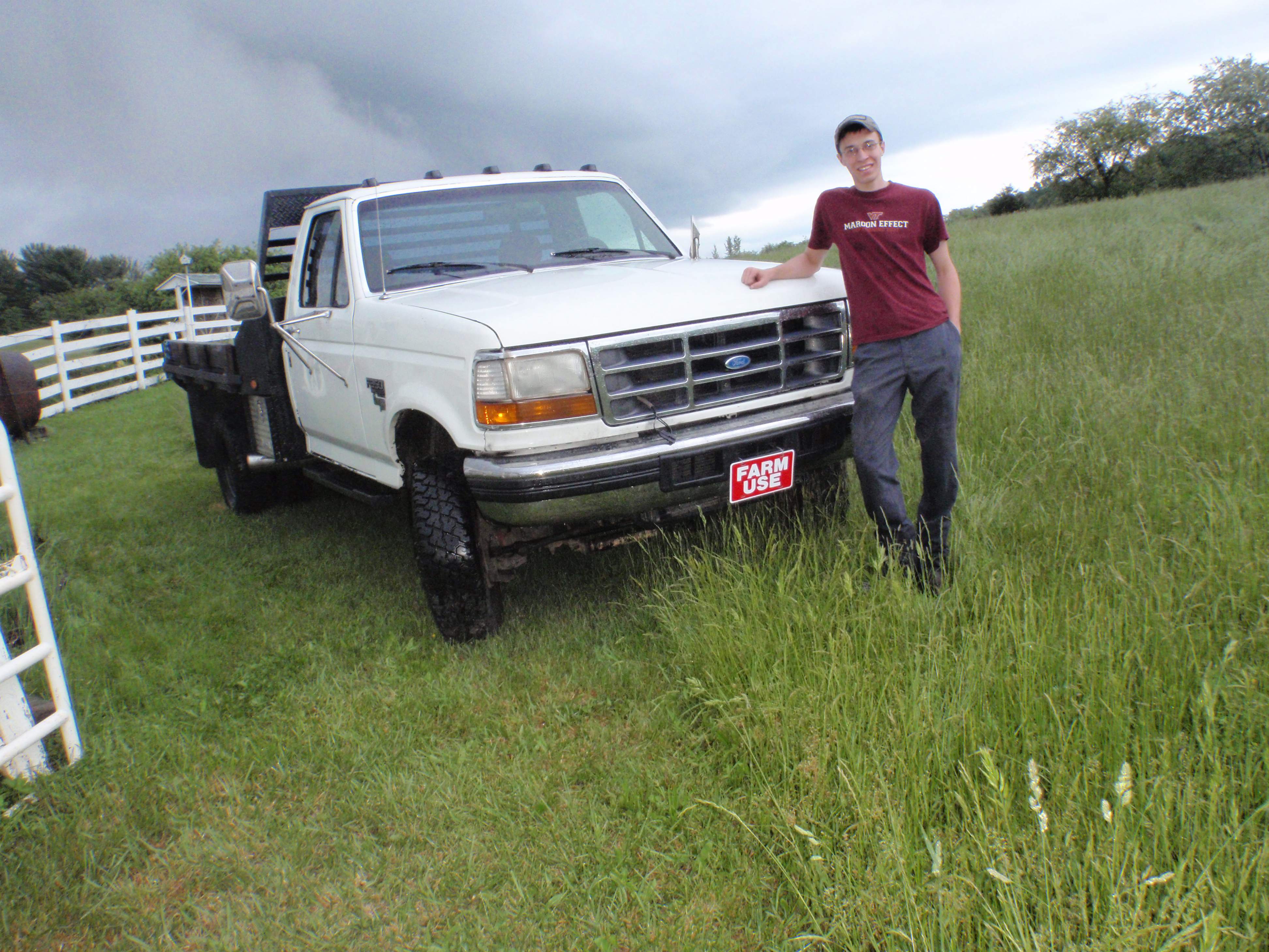

Well I finally found my dream machine the other day and I went and Bought it today. I drove 225 miles round trip to get this beast and drive it back.
A little about this truck:
late 1994 F-350 Cab and Chassis, 4x4, ZF 5 speed was a turbo 7.3 truck
139,000 Miles on the truck
1990 Cummins motor, VE injection pump, Turned up way to high and aftermarket fuel pin.
Other goodies, 3rd gen cummins intercooler, Bigger Radiator, Decent flatbed with LEDs and two nice boxes on the sides.
My plans for it:
Reliable Daily Driver that can get at least 18-20 Mpg, Still Pull a decent load ,and Looks and rides good.
What it Needs:
I need to check and see if the Killer Dowel Pin Problem has Been fixed, Help with the interior (color change), Good service, Tires sometime soon. And some brake work (just in case)
Here it is when I finally got it home, It cruised 70 Mph and Ran Very Very Cool down the road, Over all im pleased with it so far
