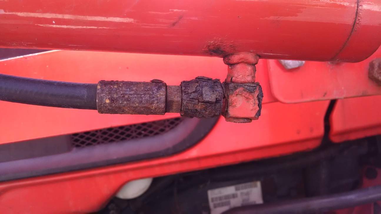

The fittings on the lift cylinder look like they were about to let loose, so after doing the 300 hr (actually 350hrs) I replaced 4 lines... Had to use vise grips to get a few of them, because the corrosion had worn away the flats for a wrench...
Some how everything went smooth... despite needing to run out for a 26 mm socket for the strainer hex above, So now I'm waiting for the shoe to drop.. the before pic got deleted accidently...oops
   / Dam# NH weather... Nasty hydraulic lines
Looks more like you are running salt water as opposed to hydraulic oil in your system. My fittings here in Washington state look nothing like this.
Gregg IAFF 1352
10 yrs old, and the worse are the 2 at the base of the FEL lift arms. the other 6 couplings were not that bad, I was able to use a wrench on them, but started to round as they loosened... Obviously these needed vise grips.
Tractor sees a lot of snow removal, stored under cover in a quanset hut, with good air flow...

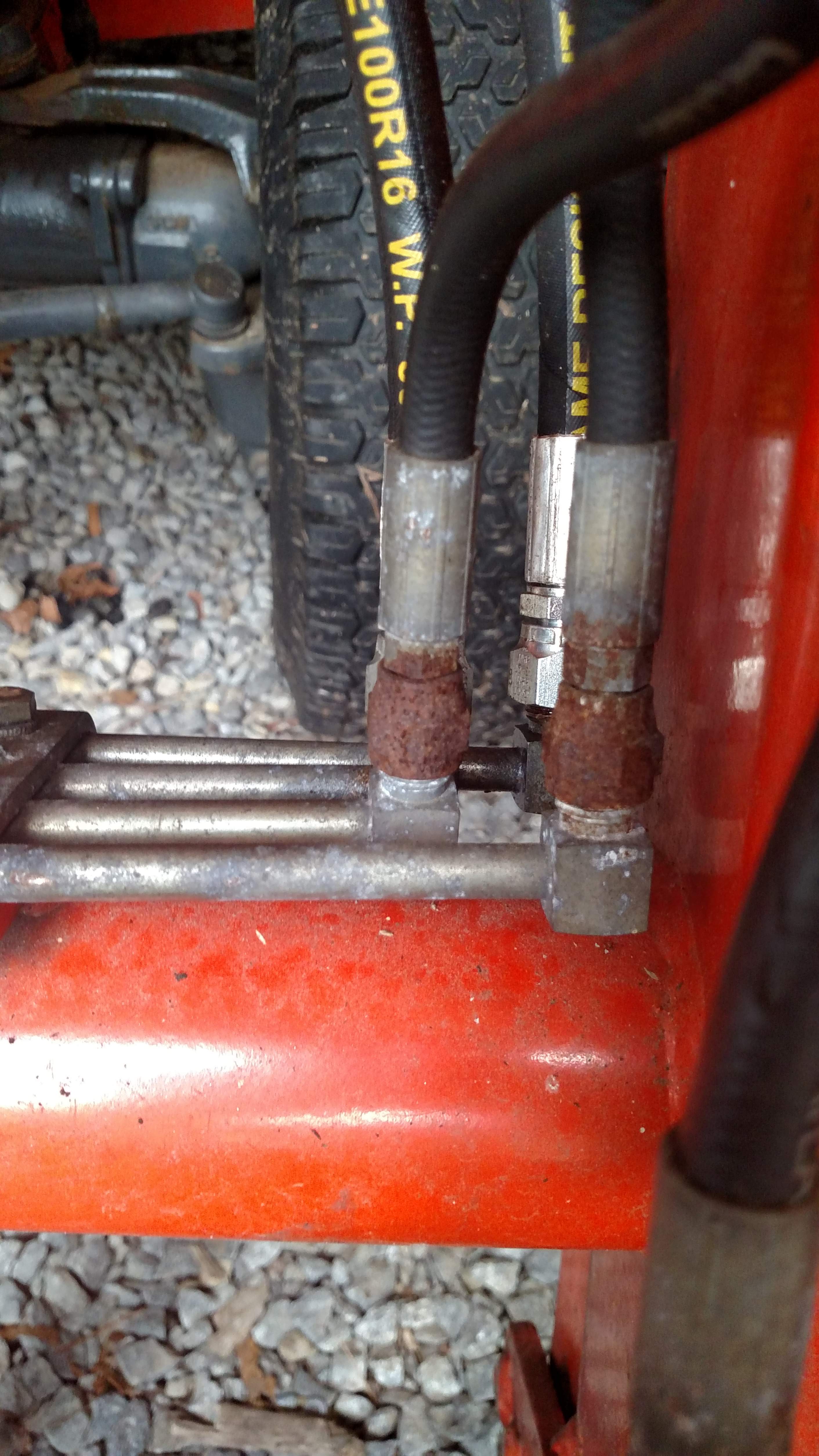

The tractor is pretty good... these are the other fittings, more heavy surface rust... Cheap Chinese metal fitting1.jpg
