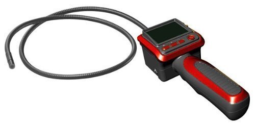

The plan is to tuck it in the back of the garage so the wife's car will still fit. I will drop the oil pan, borrow an inspection camera and some night this week try to find where my hole is. Then I'll determine a plan of attack from there. A call to my uncle confirmed my suspicions and he agrees on the proper plan of attack. He will be here when we inspect everything.

Go get one of these and see if you can look INSIDE
