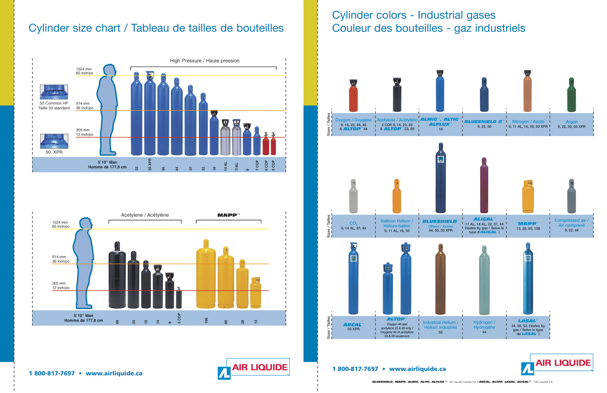

Interesting, except the second one is a pic of a car subwoofer;)
I think the smaller O2 bottles are delivered minus a cover due to their small size (volume) and generally their not used in a environment where they'd be likely to get the valve knocked off. Im sure the cart will provide alot of protection.
Locally industrial gas is delivered in a closed in van, however there is many vents around the perimeter to provide ventilation. The back of the van is also open.
I dont believe the altops are available in medial gasses. Theyre aimed at the industrial / construction market. I think theyre available in Oxy,ace and argon only.
As a FYI the small Altops are available for purchase here. Price is $250 each which is a deal considering they come with a regulator. Thats almost the same as what air liquide charges for regular bottles without the Altop benefits.
