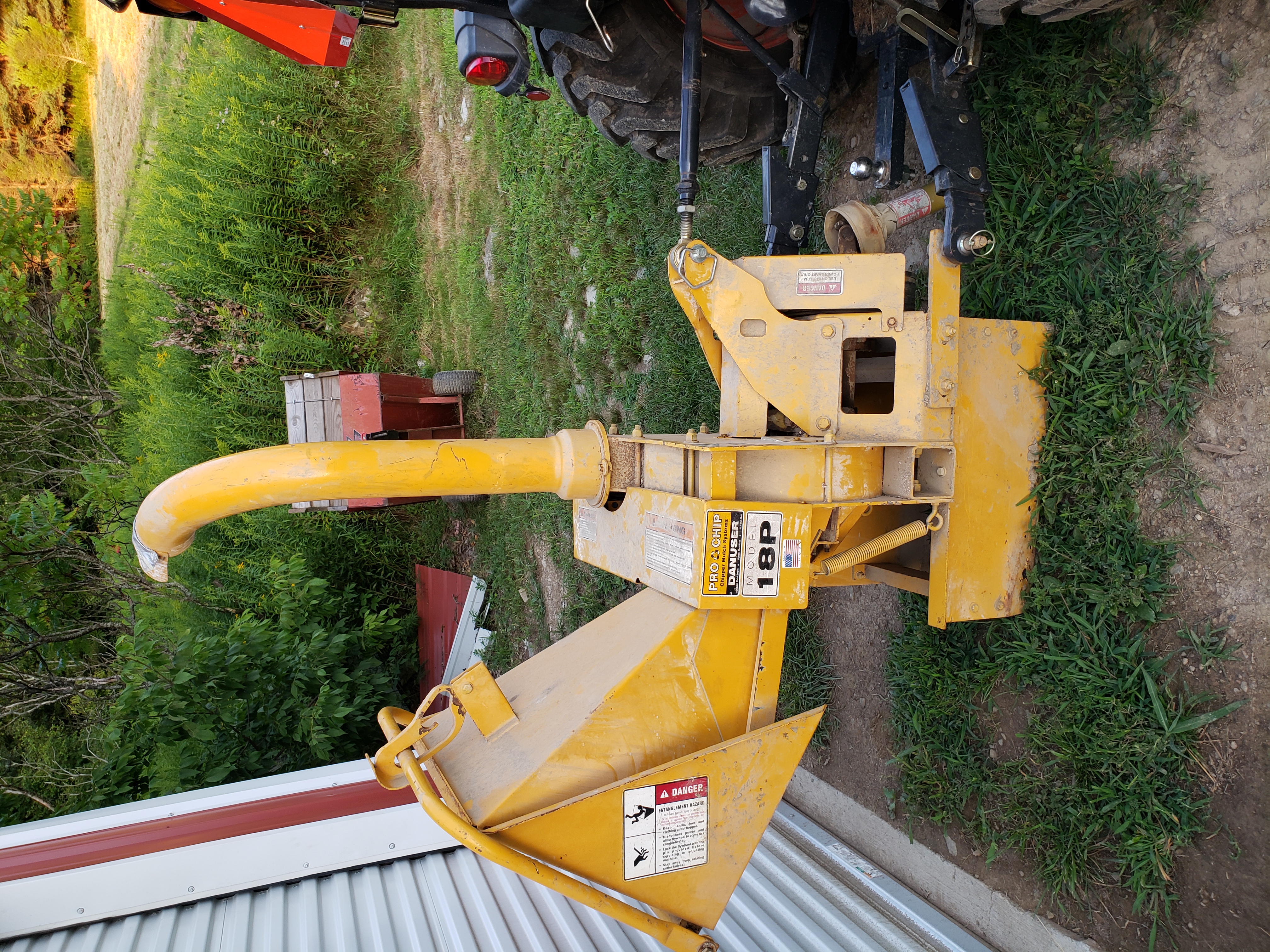

Finally got a chance to run the chipper some today. It runs great! My Kioti ck3510 has more than enough power, I was running some 2 1/2 - 3" limbs through it, and the tractor never even fluttered on rpm's. If I had to find a complaint....I wish the chip size was a little bigger. When I flipped the knives, I opened the gap up to the maximum it says in the manual (.090), and it's better than it was, but they're still small chips.
Here's a picture....amazing condition for being 20yrs old. I paid 550, plus 22 bucks to rebuild the U joint on the pto shaft that was shot. And a couple hours to flip the knives around.
   / Danuser 18p chipper/shredder #7
Good looking chipper, and priced right too!
Like other products from Danuser, it is well-constructed. The support the company provides adds to the value of the equipment.
Good luck going forward.
