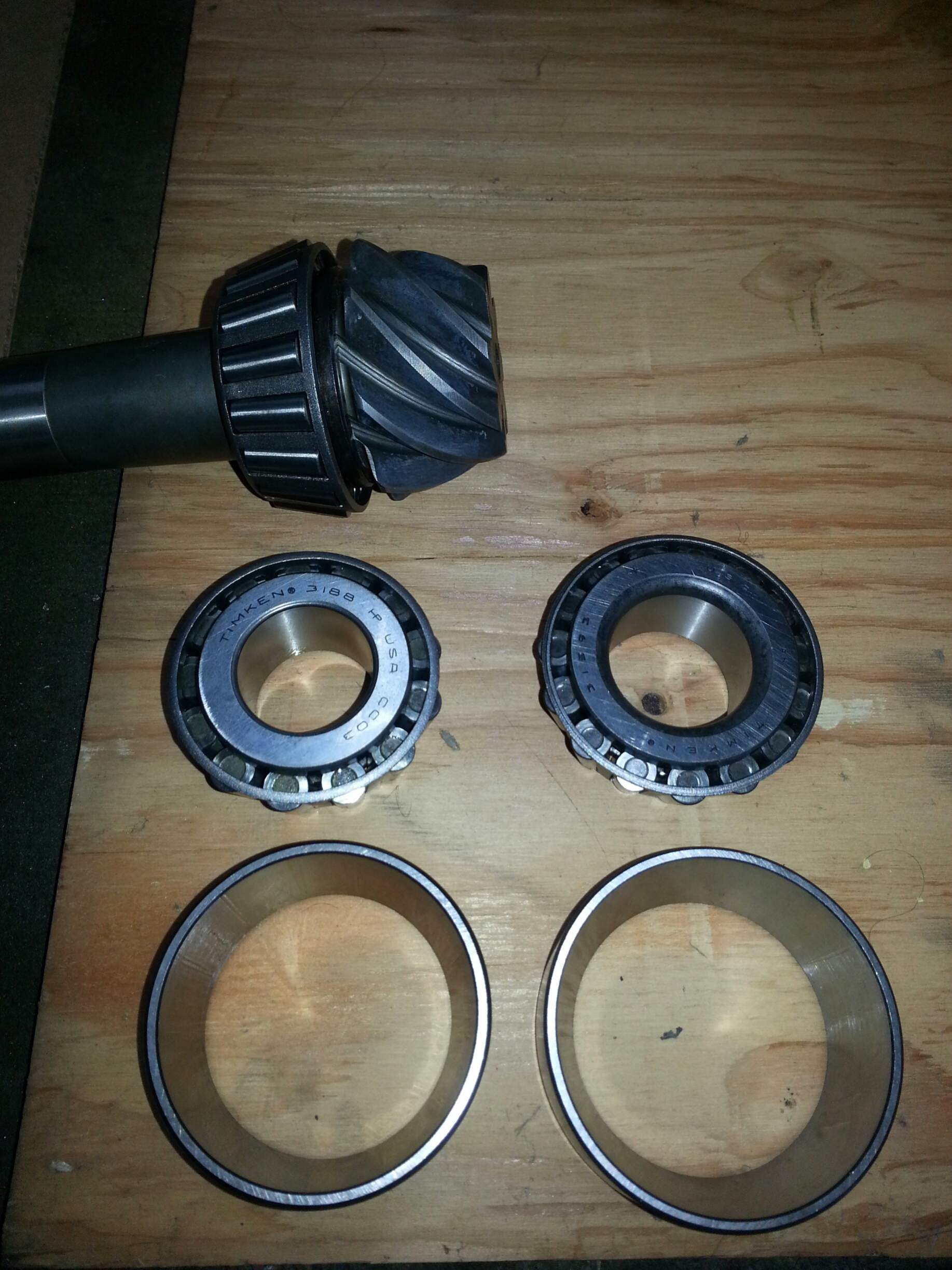

I replaced the 2 bearings on the pinion on my F7/8 auger with the same brand as original (Timken) and they were 30 bucks at the local bearing supply company. If you open it up there may be 1, 2 or 3 gaskets, they use them like a shim to set the gear backlash. Danuser has adaptors to fit other size/brand auger to your F8. The Danuser Augers bits are pricey but far exceed any farm store auger and there are a number of different options. Attachments | Augers | Post Diggers | OEM Parts | Recoil | Danuser

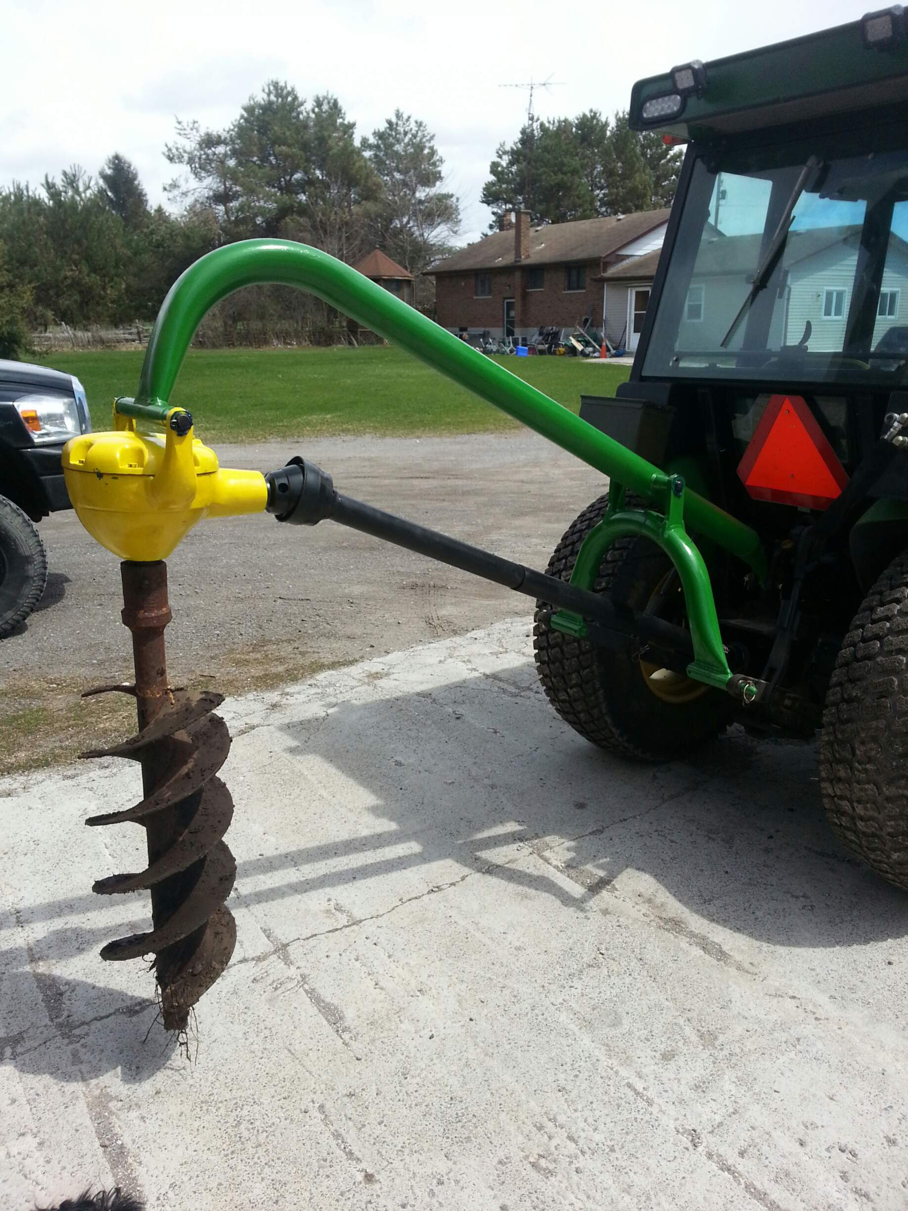

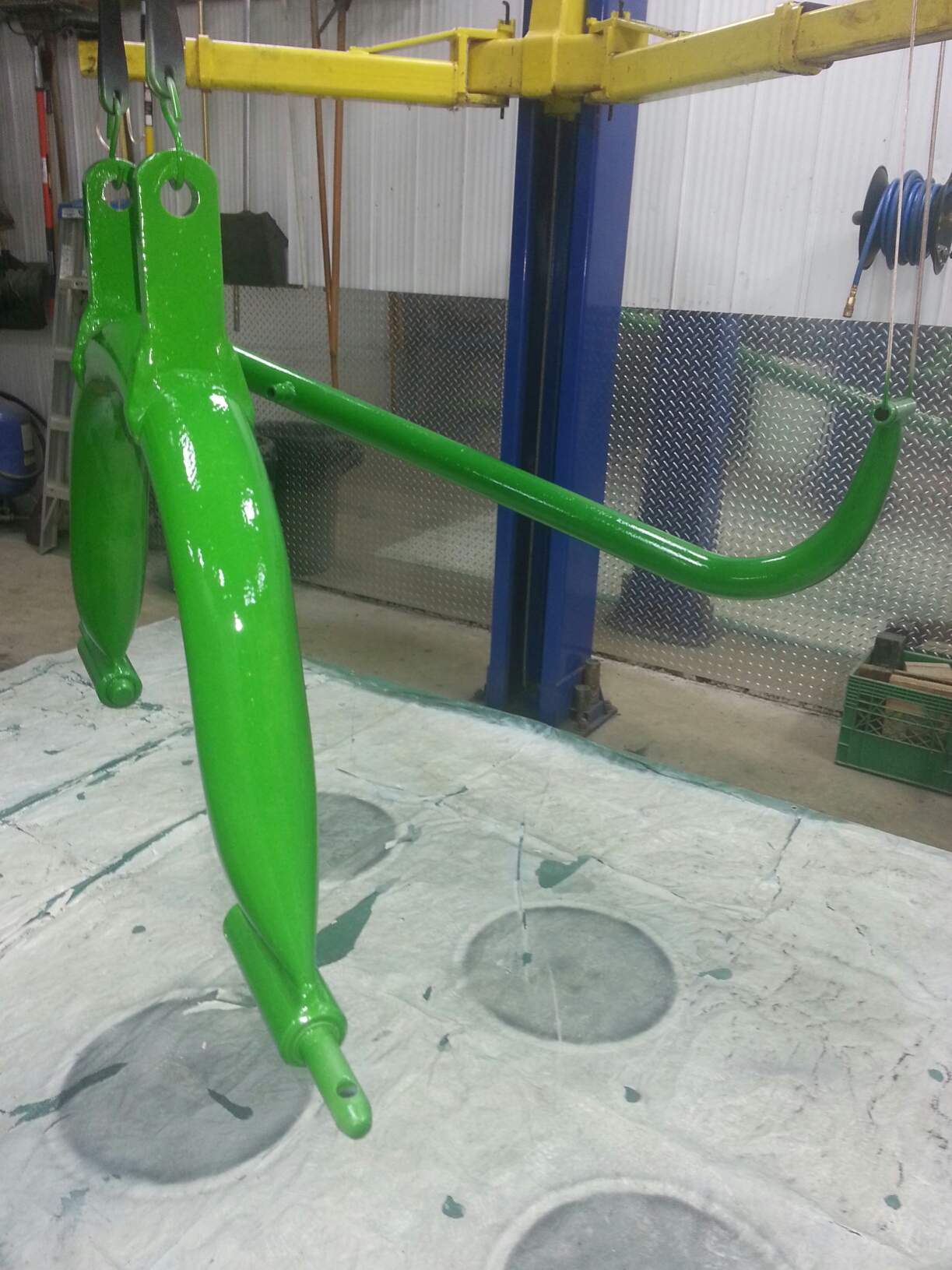

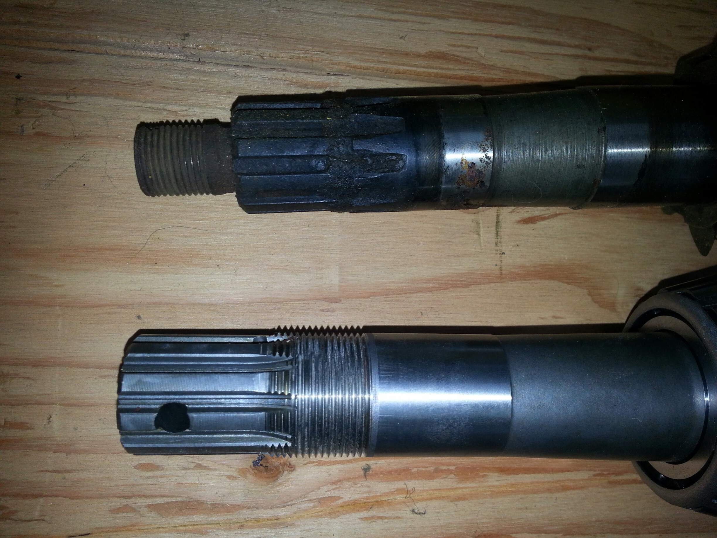

20140504_141150_resized_1.jpg20140504_105817_resized.jpg20140504_110216_resized.jpg20140504_110137_resized.jpgYes I replaced the gaskets as I ordered the complete update safety kit from Danuser to make my F7 an up to date F8. That includes a new pinion, grease seals, gaskets, safety guards and complete new driveline. These augers far far exceed any Generic augers gearbox or augers themselves. The gearbox gears and bearings are very similar to a Ford 9" rear end that everyone uses because they are bullet proof.

Ken 2920 Yes that is the kit I got. The only bearing that comes with the kit is 1 bearing pressed on the new pinion. I think they do this just so everything can be done by the owner easily. There would be no need to change any of the other bearings unless they were damaged or rusted from water intrusion in the gear case (like mine were). Bearings don't really wear out. They are good or damaged, rusted or pitted. The bearings are very robust in these augers and also run at a pretty slow speed in grease. Yes the kit includes a complete pto shaft with safety shields. The shield they include for the very top of the auger has 2 tabs that have to be welded to the gear box for the shield to attach to. I would not of spent the money for this kit ($550 canadian) other then I got the auger cheap and my brother paid for the kit as he has a large fence that needs lots of post holes done. The other reason I could not find U-joints to fit the shaft that came with my auger and they seemed small compared to every other part of these augers. The new shaft looks much beefier.
