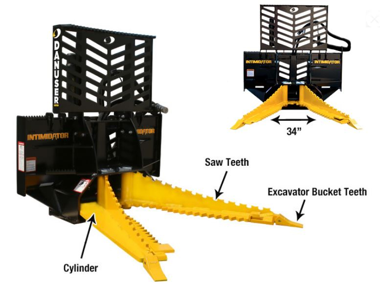

Used on Kubota B26 plucking trees and brush. Some trees removed along the wooded driveway 20’ tall. Privet and Russian olives clumps easily pulled up. Small tractor gives great maneuverability and sight near fences and buildings. Easily pulled trees growing in the blueberry patch with surgical precision. Long tines give good reach. Pull, pile then use to grapple the pile to carry off. Carrying piles long ways thru narrow wooded roads easier. 100+ pulls in a couple of hours. Used many different tools over 50 years to accomplish this routine task but none are as quick and easy.
The Intimdator usually not shown using on small tractors. Built to handle large tractors and skidsteers clearing large vegetation. Often overlooked on a smaller maintenance scale.
   / Danuser Intimdator #2
For those not familiar with the Intimidator: https://www.danuser.com/attachments/intimidator
$4200…. Ouch!
Wow! That’s twice what I paid 5-6 years ago. Hard to keep up with the rising prices.
Maintaining our property particularly as we have gotten older a concern. Pulled thousands of trees and invasive plants with a chain and piece of pipe over decades. So a new tool has to pay for itself in time, labor and cost savings. The Intimdator did that the first year. Hopefully cost and labor savings for many years to come. Well made tool that has several advantages over a regular tree and post puller. Close maneuvering, pushing and pulling power is where HST really shine.
Only minor problem has been wood, gravel and mud getting packed in the slot of the jaws locking tab. Preventing jaws from closing completely. Effects gripping thin slippery stems. Pulling out the little stuff early important to our maintenance. Have had to chisel it out only a few times. Different design featured on new ones might help prevent this.
Just one of many tools to help maintain our pastures, fields, woods, roads, creeks and ponds.

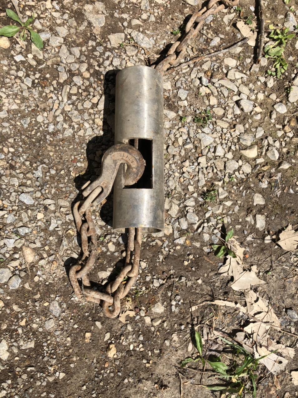

I've pulled trees with chain and a wheel rim against the tree trunk for leverage. How do you pull a tree with chain and a piece of pipe?
   / Danuser Intimdator #8
The pipe bites and allows the grab hook chains to slip. Grabs slippery and small stems. Also rocks.
That’s interesting, looks like it would be more effective than my way (wrap the chain around tree several times, and hope it doesn’t slip off) then up over a old wheel.
