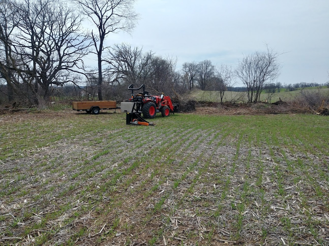

can you give the dimensions of this pipe? I asked a friend if he can get this pipe fabricated for me(as I have the necessary chains and hooks). he asked for more pictures, not quite sure why. I had given him the picture from your post. Maybe the dimensions would help him.
I found a scrap piece of thick-wall pvc, cut an opening out of it with a sawzall and will try that.
PVC will shatter into sharp pieces and won't dig into the saplings like a piece of metal pipe. The metal pipe needs to be big enough for the size of chain and chain hooks you will be using.

"PVC will shatter into sharp pieces". If it does, so be it. I could not find what I really wanted. Looking at the pvc contraption, I doubted if it would function as desired.

pipe and chain method- as my pvc pipe will fall apart on its first use, can someone tell me: can the pipe be aluminum, will that hold up? shortest length pipe could be? Thanks.

Aluminum is soft metal and will tear after a while. Would be better to find about a foot of regular metal pipe with a diameter sufficiently large for you to pass your chain hook through. A scrap yard should have something that would be cheap or look for a cutoff at a welding or machine shop or maybe a plumber.

got it made. my hayman stopped by this morning and between his sawzall and my grinder, we did it. will try it out in a few days.

Simple devise makes short work of pulling the small stuff. Imagine a piece of square tubing would work as well and might be easier to cut a hole for the hook. Not roll away when transporting either.
When I can get my wife to help, we can make a pile pretty fast. She has the choice of tractor or hook up and usually chooses the latter. East Tennessee hills be careful.
