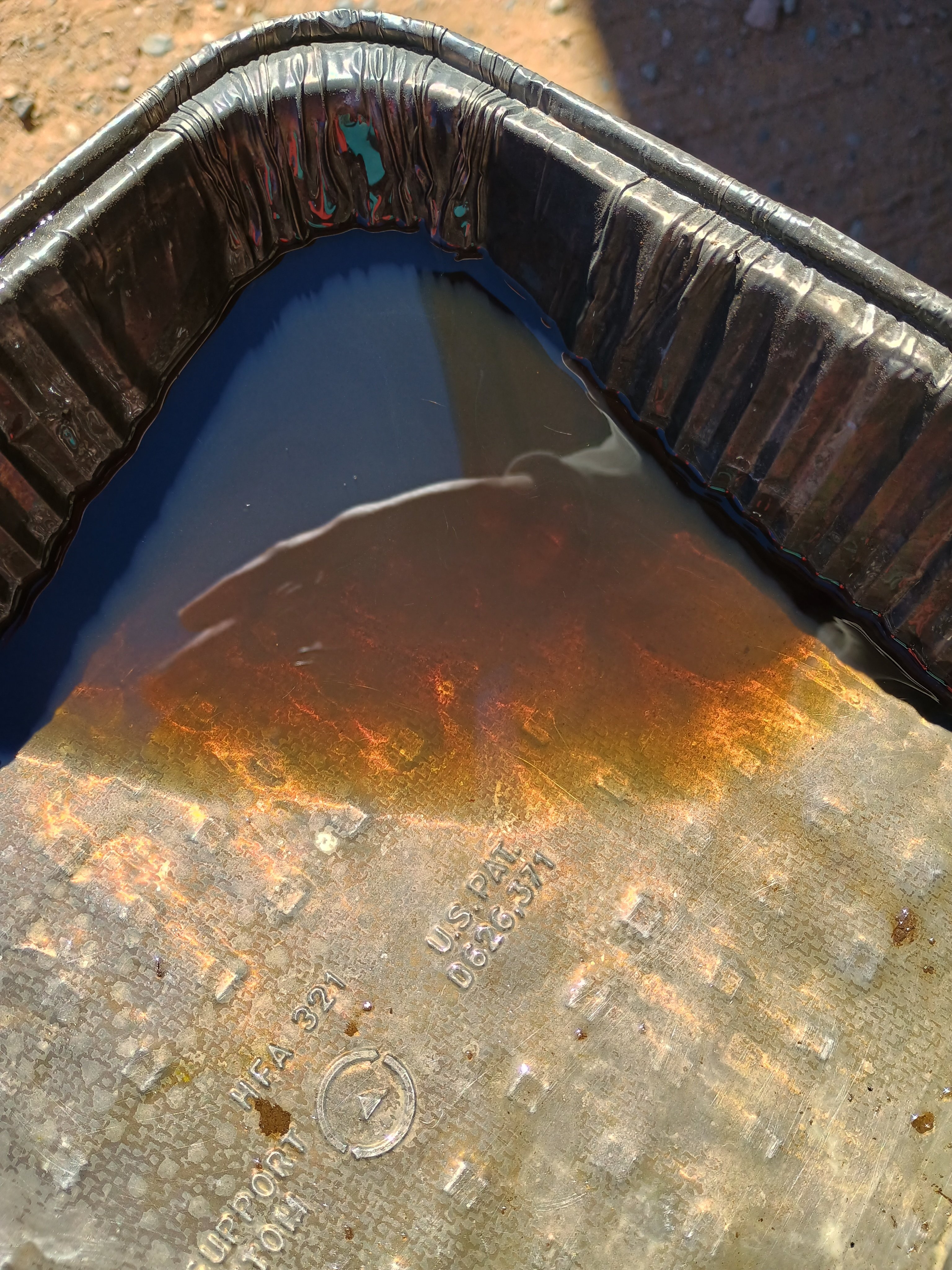

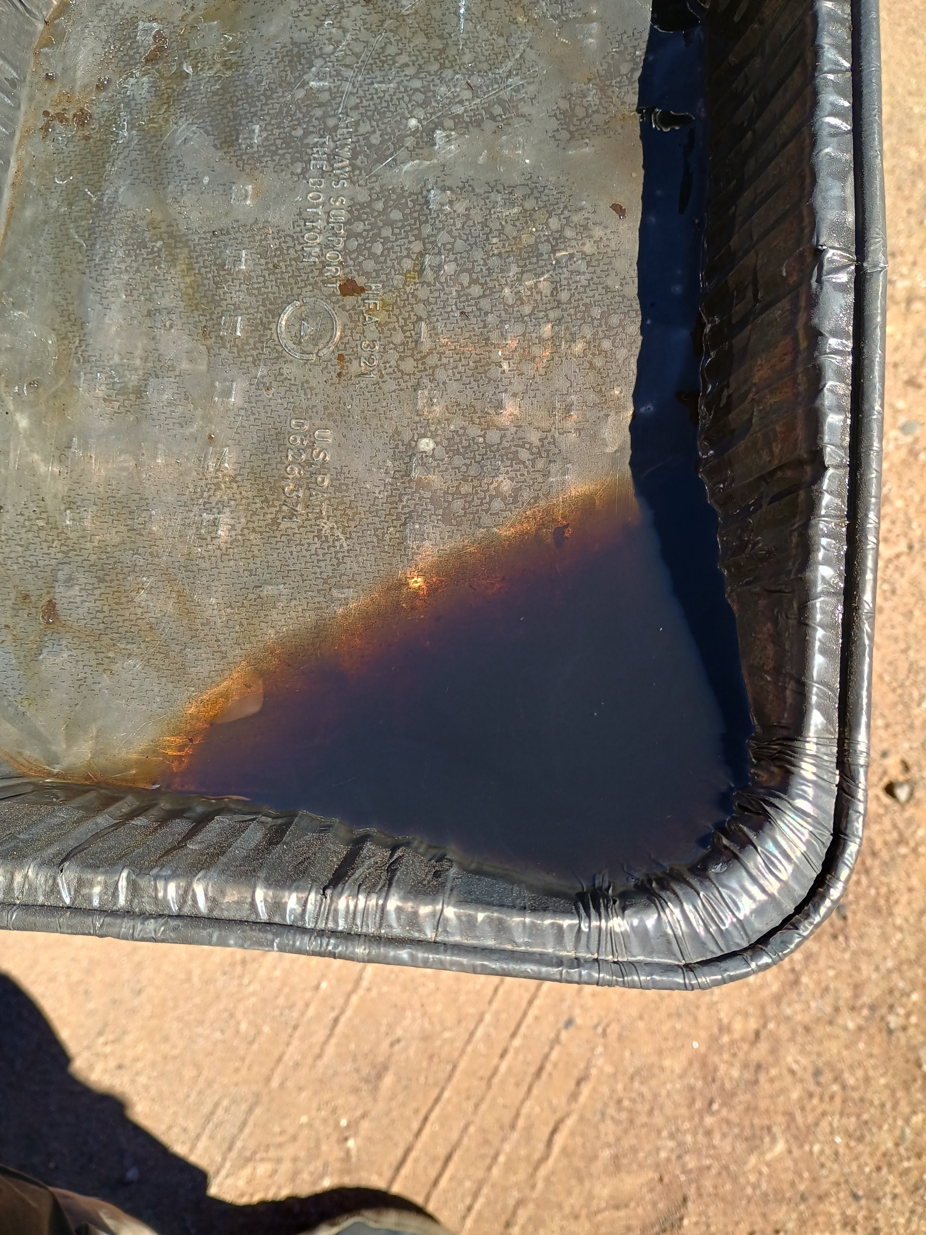

I bought this tractor (2021) used, about 1 year ago with 175 hours on it.
Today I was adding some rear remotes and had to undo hoses connecting to the power beyond port on the tractor.
This fluid looks way too dark for 315 hours, right? The oil smells fine... should I be worried? The manual calls for a filter change at 500 hours, but I guess I should change the oil and filter ASAP, right?

Change it out for sure,should'nt be that dark.Make sure to use the Kubota fluids.Who knows what the previous owner used.
Some don't like the price of Kubota fluids but for the average person's use it pays to be safe.
I have owned Kubotas for 20+years.I add the JD dye so I can see it(it is dead clear).

I'll change it out today. Two filters and 15gal of UDT2 is about $700 from my local dealer. Ouch!
The manual calls for filter changes at 500 hours and fluid at 1000 hours. Which begs the question what the hell is going on that my tractor has such dirty hydraulic oil @ only 300 hours!?
Good idea on the dye. The fluid is so clear it's hard to read the level on the dip stick.

The previous owner may have had it hooked up to a contaminated(or non compatible) system.I.E. anything with a cylinder .
At least now you will know it's the proper fluid.I know it is expensive but for me only a change maybe every three years.

Got it done today. Very easy job as the M5 has enough clearance for 5 gal buckets. I was not looking forward to pouring three (heavy!) five gal buckets of oil back into the tractor, but the oil is so thin it pours quickly and I was able to put my foot on the 3pt and rest the buckets on my leg as I poured.
Pouring the oil out of the buckets with the spout at 12 o'clock (which is IMHO counter intuitive) eliminates all the gluging that happens when you pour at 6 o'clock. I read about that tip a long time ago, but this is the first time I thought to use it.
Also, there was almost no metal on the magnetic rings, which was a relief.
