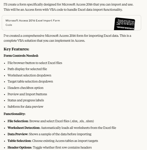

Type "Create a Microsoft Access form to load an Excel Spreadsheet" in any of the available AI modelers. I would start with something you KNOW as far as what you EXPECT the results to be. Just to gain confidence in the modeler. Tailor and add more inputs and you are off and running. Cut and Paste can be your friend.
I just tried Claude.AI. Yes it generated useable code.
Here is part of its response:

MS Office uses VBA. You can ask the models to generate all sorts of code snippets or functions based on what your trying to do. They can even generate a user interface from what I experienced.
