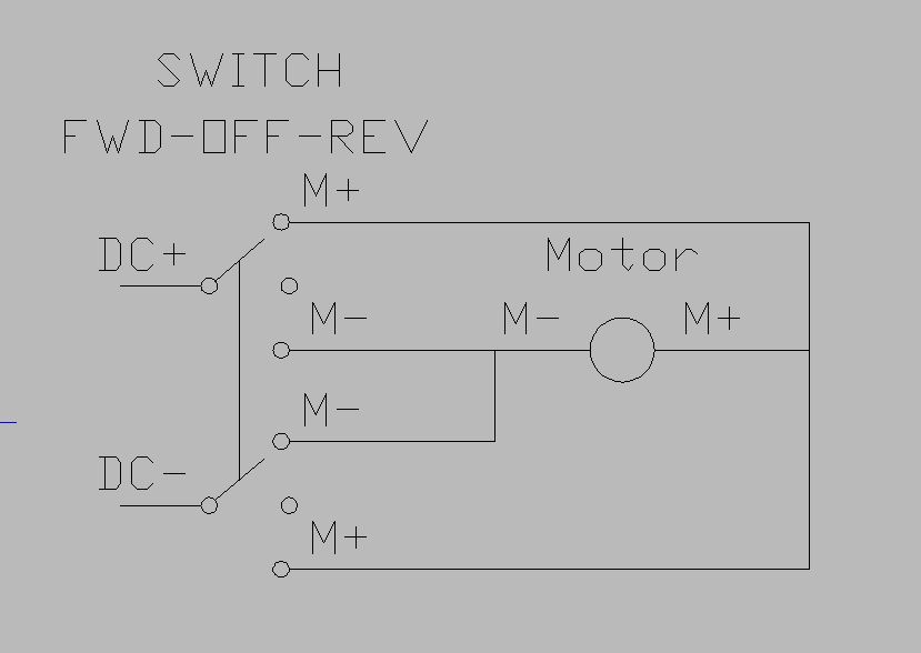

Building a small Welding turntable for a friend with fractional HP, DC Motor and Drive.
I have built hundreds of DC Polarity Reversing circuits using a DPDT switch, but I have an industrial panel switch with three positions, and four contacts. Nothing is connected in the center position and the contacts are either in the other two positions. I was sure I could substitute this contact arrangement for my normal DPDT switch, but I can't make it work without getting an unintended short as I am trying to reverse the wires in one position.

For Reversing. Switch has three positions. Four Contacts. All open in center (B) position. Two Closed in lets say the (A) position and the other two closed in the (C) position. Can this contact arrangement be used to reverse the polrity to the motor?
/ DC Motor Control Question #4
I see that you normally use a DPDT switch (which has 6 tabs for the wire connections), this switch makes no sense as a DPDT switch unless the terminals are cross wired internally. With having only 4 leads, you're going to have to figure out which terminals are connected together in each of the switch positions. An ohm meter will tell you which are connected together.
On a second reading of your post, it sounds like one pair of terminals is connected with the toggle to the left, and the other is open. Then toggle to the right and the opposite situation occurs, i.e. 2nd pair of terminals are connected and the 1st are open. With toggle in center both sets are open. This really means you have 2 SPST switches in the same body. I do not see how you can make a reversing switch out of it, you need a DP type switch.
That switch will work. See drawing.

I wonder if that switch has a make before break setup. Would explain the short while switching?
Otherwise Mendonsy's diagram will work if it's a true open on switching between poles.
/ DC Motor Control Question #7
Here's my understanding of his switch:

As to your switch idea and arrangement, yes, that switch should reverse the motor. Wish I had some drawing tools here... I would sketch out how I would wire the circuit. Oh wait, Mendonsey did it for us.

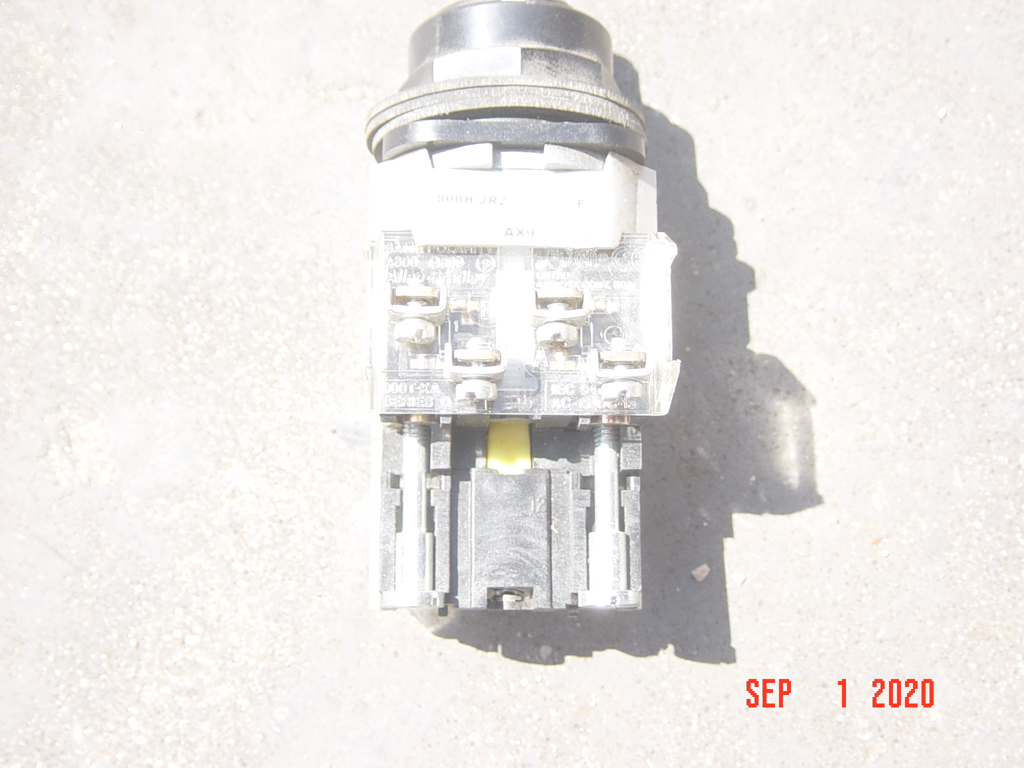

As far as the reversing contacts go. The contacts are not single pole, double throw, but seperate single contacts. Maybe I will take a picture. I won't be using the switch, but would like to know for future reference.

Sorry, not great pictures, but give some idea of the type of switch I am talking about.
