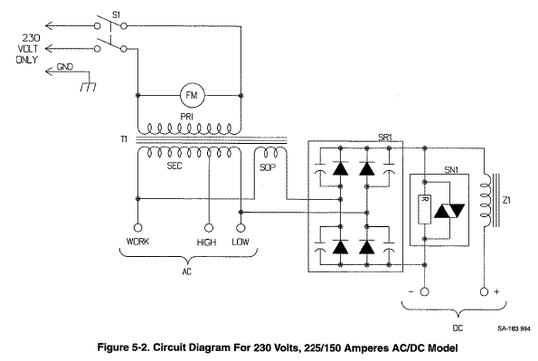

The highest voltage was 120VAC +/- normal fluctuations. What boggles the mind is that the insulated wire nuts were UL approved. Why in H E double toothpicks did they want us to wrap insulation around a UL approved insulator approved for a much higher voltage? Like my customer said, they were probably justifying their existence. If they couldn't find something to gripe about then of course they weren't needed.

DC output adds better control on thin work and easier out-of-position welding, as well as fewer arc outages, less sticking and spatter.
I pulled that out of a Miller ad. However I have wondered why the same welder puts out 225 amps AC but only 150 amps DC. I am sure the answer is simple and obvious but for some reason I have never run across an explanation.
I believe the answer is that question is the AC is being rectifier by a half-wave rectifier. If it were a full wave rectifier, it would be 225. The full explanation can be found in a basic electronics, or electricians book.
I thought that too but that begs the question why not use the full wave rectifier? Cost perhaps? Wouldn't it be nice to have 225 amps DC at your disposal for the price, that is if the cost of the full wave rectifier is not prohibitive.
I barely know enough about electronics to ask dumb questions but all I have read here, and in some welding forums, none have addressed the question of the difference in amps between ac and dc in the same welder. Perhaps the question is too basic.
/ DC Welding #28
Sorry JJ but I don't think so. Borrow an O'scope and look at the wave form or open the case and measure the RMS voltage (AC) on the secondary of the transformer (or autoformer depending on the design) and then with a true RMS meter measure the DC output. I think you will find you are in error.

I got curious, so I went and grabbed the schematic from Miller's site(see attachment). Unless I'm reading it wrong, they do use a full wave rectifier. I don't have a definitive answer on why the DC amp rating is so much lower than the AC amp rating, though.
