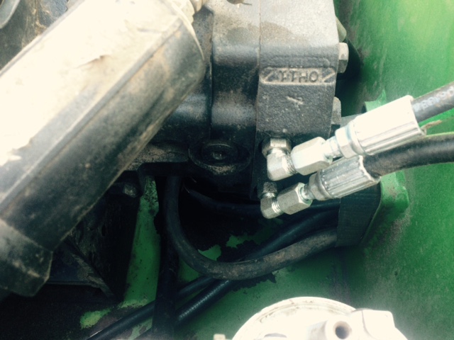

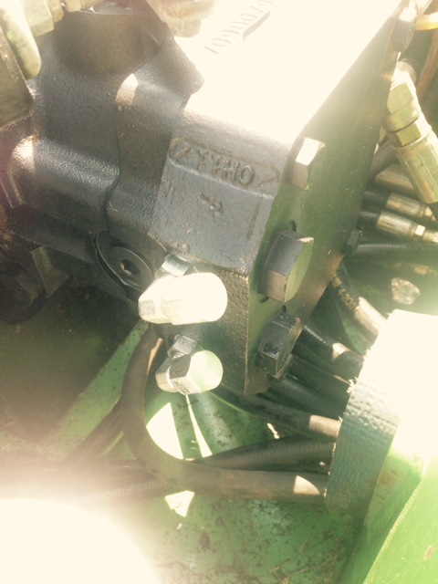

My only concern is the fuel filter getting hot. It's not touching the engine, but it is close. I may move it after I see how it goes.
   / Dead battery, broken exhaust stud, tow ports, gas tanks, welding, carbs.... YIKES! #32

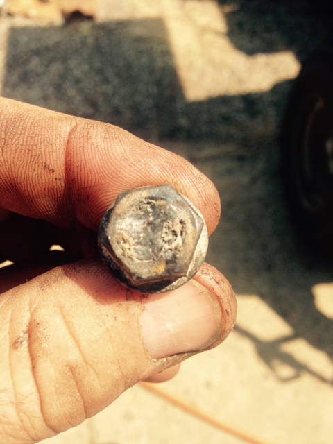

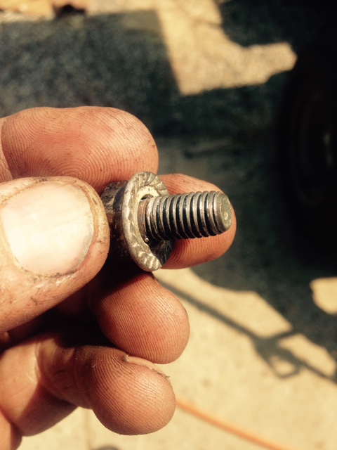

I forgot the Valve cover had the Oil Fill in it. :eek: You may need to be careful when unscrewing the cap.
As an aside: You may be able to drill a new hole for a small 6mm or 5/16" screw to one side of your damaged fixing. ??
#33
There's not much room for anything. If the valve cover starts leaking, I'll take a dremel tool to the EX out in the hole and see how that goes.
#34
Cut brush for about 2 hours pretty heavy on Sunday. Worked well. No valve cover gasket leaks so far and no problems with the new fuel pump.
Cut about 4 miles of trails... really 2 miles, but made them 7' wide, so two passes = 4 miles. :)
