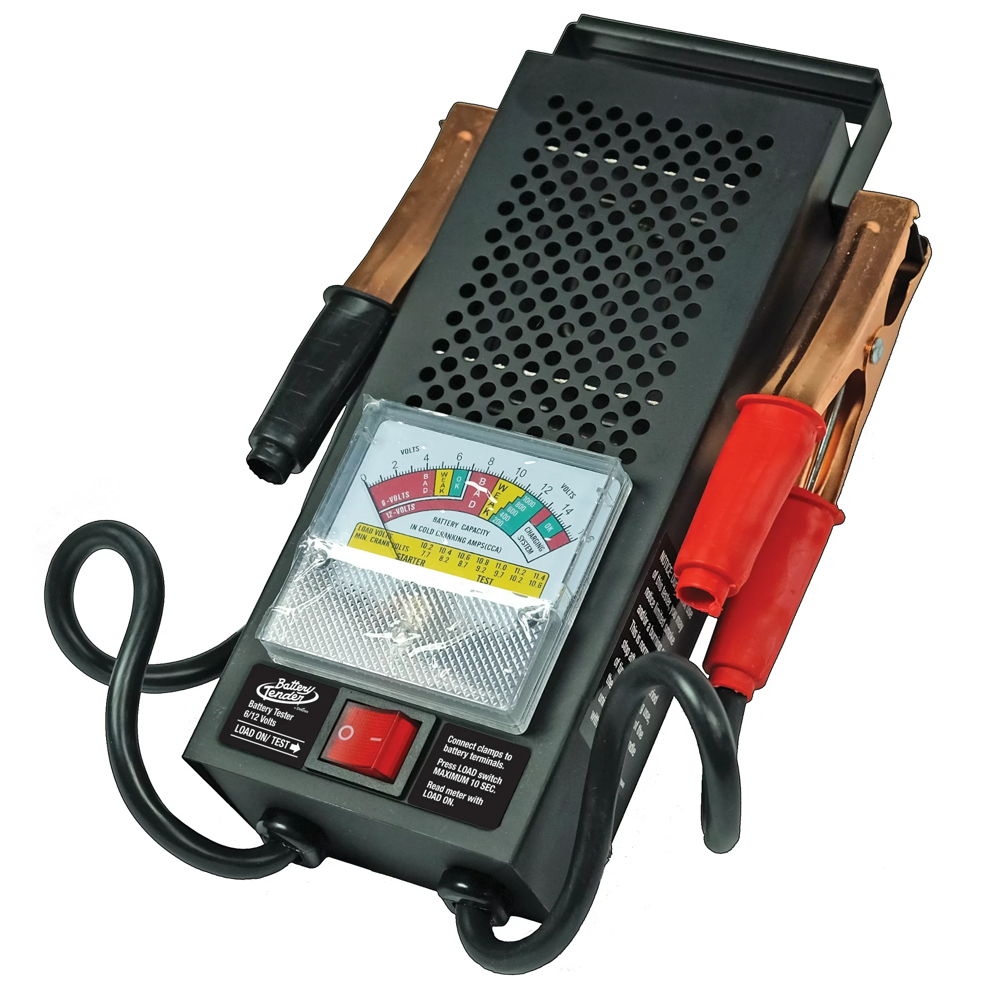

I purchased this from wally world and it lets me know if
my battery is good or need a shovel:
