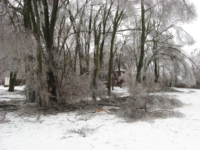

I have plenty here from last winter's ice storm.
Very much a YMMV thing for return on effort, and you might want to try it first. BTU/cu ft is somewhere between boxelder & maple, and I suggest mixing with either in the firebox. btw, I would think this burns best in a catalytic stove, where flame is suppressed & smoke feeds the catalyst.
Oh, and I was throwing the stuff onto the burn pile yesterday, 2" to 4" dia and it was all glow and no flame. Yippee ...
