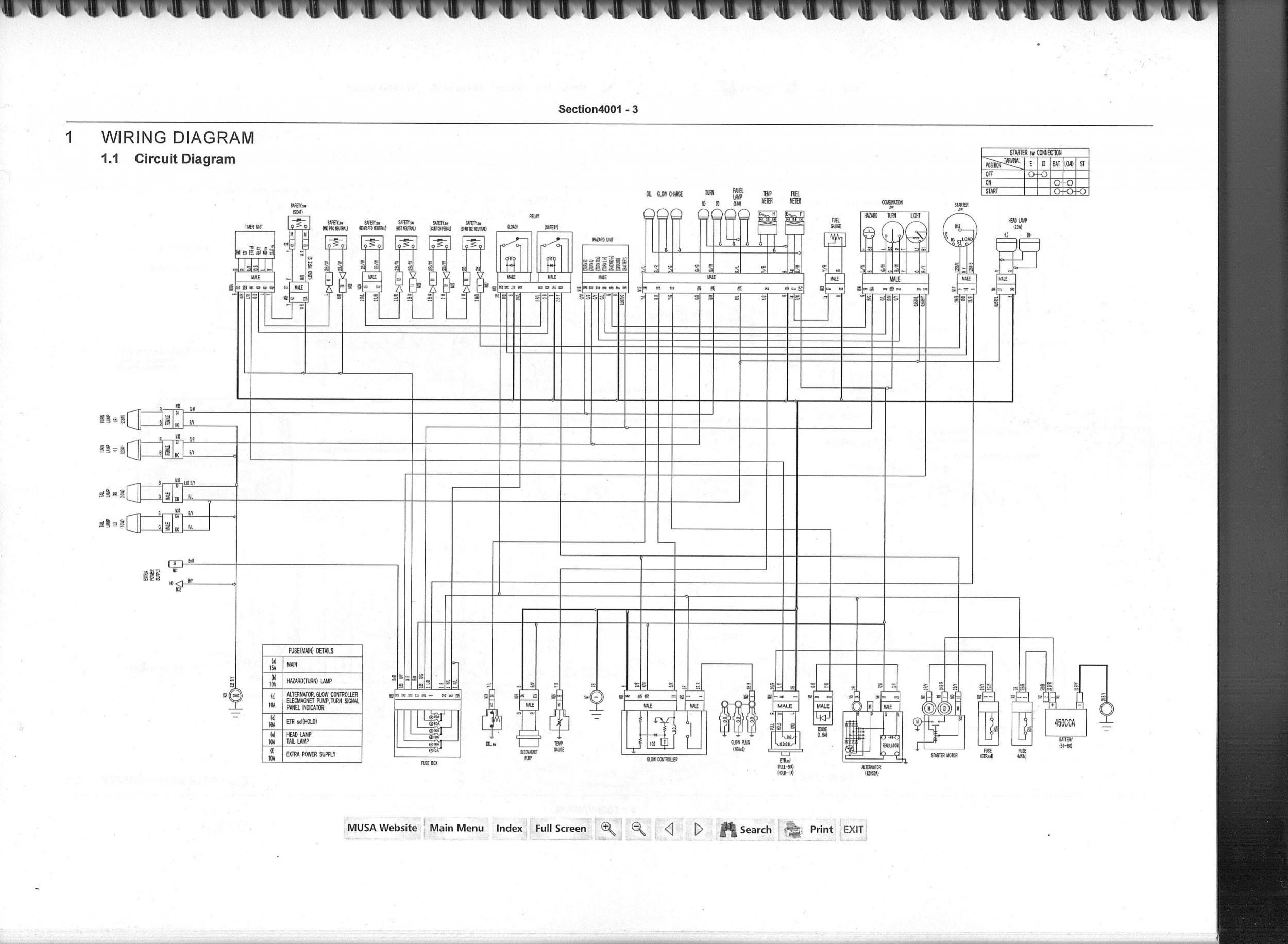

Does anyone have any idea of what it could be? And, does anyone have a wiring diagram I could look at? I've not had luck finding one on line.

Not sure if this helps but here’s a wiring diagram for a Mahindra max which is manufactured by MHI. I believe yours is also an MHI machine so it might be similar.
