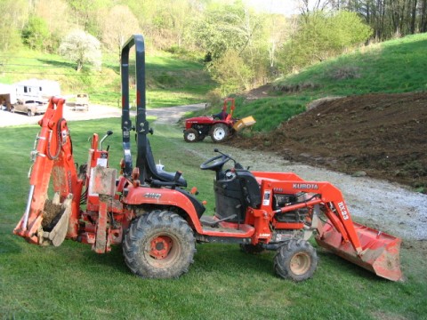

I did my own 50 hr service and never checked the screen. I did change the filter and used SUDT. Seems to work the same. I use my BX23 VERY hard. Just wondering if I needed to check the screen. Unless I may have read the book wrong but I thought it needed to be cleaned after 300 hours?
Heres a picture with 76 hours and 5 months old taken this past weekend.
   / dealer said not to #10
Definitely check & clean the screen. Chemically, all the fluids would normally have atleast 50 more hrs of servicable life left in them but the reason for the two 50 hr fluid changes (at 50 and then at 100 hrs) is to remove all the shavings, bits and pieces of metal that becomes suspended in those fluids due to engine & HST break-in. The screen keeps the debris from entering the HST/pump and if it's doing it's job it should need cleaning.
