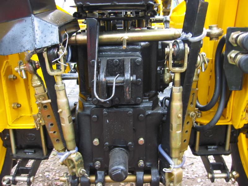

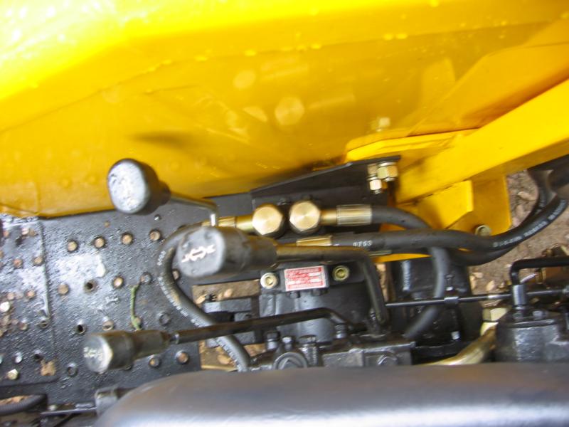

Ron, you are correct and wrong at the same time. I have a way of doing that also. Her new Jinma does have true remotes, the first ones I have seen. They have 2 separate controls located on the right side of the seat. What you are talking about is the variety the older Jinma 200 series had. I am no sure if it was a option when she ordered the tractor or if it is one of the many improvements they have added since I got my tractor back in 2003.
Here is couple of pics of her tractor.

That is interesting about the newer jinma, I hadn't noticed that in the new jinma pics. I was thinking about Coreys 2004 Jinma 284 but didn't make that distinction in my post.
I would guess his dosn't have any provision for this as his is a little older than mine, and it would be a custom job to integrate anything else back there to give it a true rear remote. I noted a few months ago when I picked up my backhoe, that the newer Jinmas have a different larger lift box and valve assembly. I don't think there is an easy way to retrofit the newer remote valve assembly to his older valve/lift box as they appeared to me to be completely different.

Ron,
I can vouch that Chris is correct ... those are true rear remotes and not the 1/2 remote you are talking about. I have run my hydraulic implements on it already. They come with QD's that are compatible with my 1/2" Pioneer QD's. They are, in fact, 1/2NPT and they fit perfect.
corey,
As far as adding them to an older model Jinma 284, I would install an after market valve like a Prince...at least a 2 spool valve to give you 2 sets of rear remotes. The only adapters you need would be to go from your (possibly) 18mm or 22m x 1.5 threads on your tractor (whatever) to NPT, JIC or ORB, whatever your new valve will be. So everything back from the valve including your QD remotes are American.

Looking at the two pics of the remote set up on the Mrs3RRL yellow 284LE there is little reason to suspect that it is not a "true remote".
Chinese appear to make gradual revisions with specific models, i.e 284LE.
My 03/04 manufactured 284LE has the new design fiber glass hood, steel rear wheel fenders, new design headlights, low slung below the radiator battery, single panel instrument display, new style 3PH (no chains). I do not have a FEL or BH.
I need to rule out that the remote set up as on Mrs3RRL yellow 284LE cannot be an OEM component that will function on my 284LE.
If it is a functional OEM component then a purchase, if possible, is in order. If not then I need to do a custom job.
3RRL, thanks for your comments and the pics.
3RRL, any chance of sharing some additional multiple pics, from many angles, of the remote set up on the yellow 284LE, especially horizontal shot pics of the attachment of the system to the housing on the right side near the rear wheel lock up lever.

You will find you can do a custom remote setup for a 200 series Jinma fairly cheap. I am guessing I have $70 in the valve, $50 in the hoses, and maybe $25 in other pieces like the Pioneer Quick connects.

Hi corey,
We're going up this weekend so I'll try to remember taking more photos of her tractor for you. You might have seen on her thread that this was a crate tractor I got through my friend Scott (flyhiflylo). He ordered the remotes and the color. So I'm not sure (?) you can get them as an add on kit from a dealer such as Tommy or Ronald? Maybe they can tell you better.
But for sure, adding your own valve and rear remotes can be done. It is relatively easy once you figure out what needs to be done. I went through a learning curve when I installed my own additional 3 spool valve for my rear remotes on my Kama 554. One I got it in my head of how to plumb it, it became pretty easy to do. I did a thread about it if you are interested. Pehaps it will give you some ideas and remove some doubt you might have? Towards the end is where the new valve is installed. Adding Hydraulic Side Links and Remote Valve
