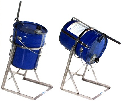

A pail tipper makes it easier to transfer to a 1 gallon container: http://www.tractorbynet.com/forums/parts-repairs/258905-anyone-have-pail-tipper-5-a.html
   / Dealing with bulk / 5 gallon bucket of oil #17
That pail is in there wrong. They are a lot easier to pour if the spout is on the top. In fact you don't even need a pail tipper. If you set the pail on the work bench so that when you tip it over on it's side the spout is on top then it's quite easy to get the oil into another container. One the pail is part empty and laying on it's side you just roll it along the work bench till all the oil is poured into other containers.
