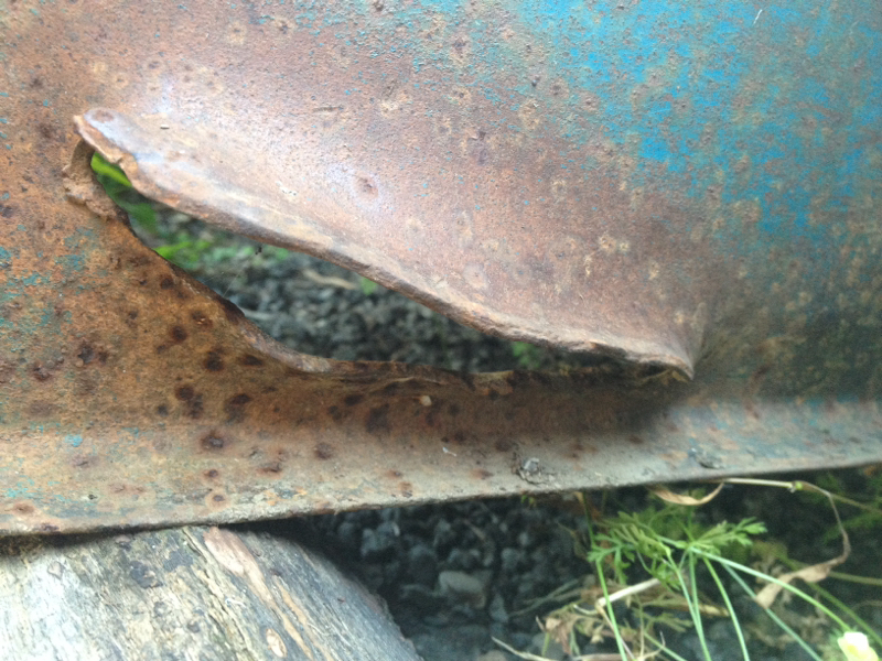

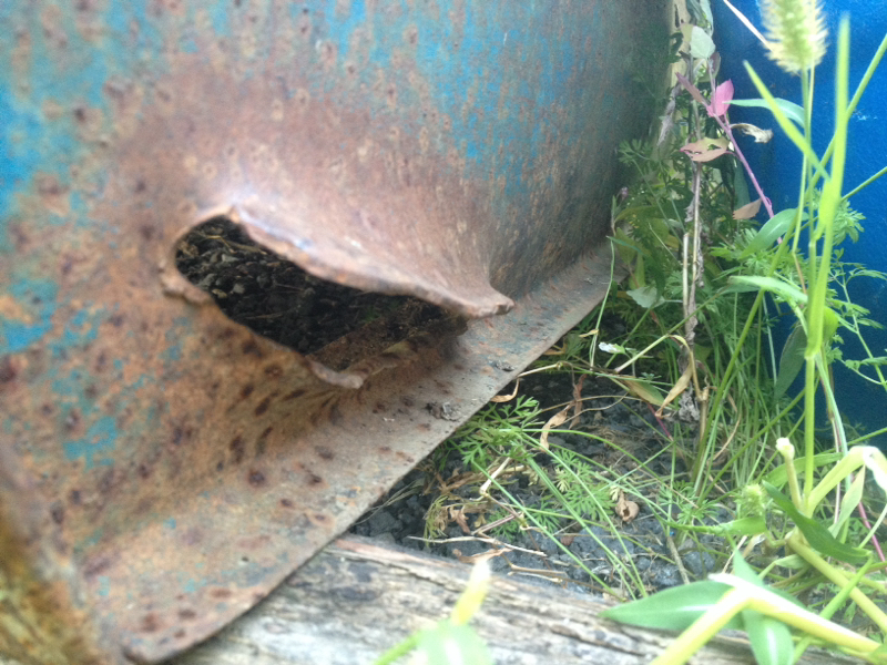

While my father has had and used a brush hog for many, many years, launching rocks may not be the most dangerous thing. My father clipped something solid a number of years ago and sent more than half of one of the blades clean through the side of his brush hog deck. I'll measure the thickness of the steel when I stop by there this weekend, and also snap a pic as the hole is still there.
That could have been life-ending had it been in a well populated area. I use a flail, and while it's not as beefy as my father's brush hogs, it leaves a nicer finish and I don't worry about the potential for injury as much. I still use the 'hog a bit when needed, but much prefer the flail.

Pics as promised, sheared blade went right through the deck. This happened probably 20yrs ago when the brush hog was much newer.

Darn autocorrect, I edited my post, meant to say 20yrs ago not 20hrs. Either way, dangerous around people for sure!

YUP more than a handful of lives were ended or nearly destroyed when the rotary cutter wings of death decide to leave the rotary cutters underbody.
All of the above is due to poor maintenance/lack of equipment inspection/service/repair and lack of safeguards for these rotary cutters.

Mostly, I agree, however my father services his each and every time he uses it. Checks gearbox oil, inspects blades for cracks or fatigue, sharpens if need be, looks for oil seepage, checks the deck for stress cracks, greases the PTO shaft, makes sure the safety guard is properly fitted and that the PTO shaft spins inside it, he's very **** about all that stuff.
When that blade let go, he clipped an immovable object while running at PTO RPM with a 75hp diesel tractor.
Sure makes me love my flail!
