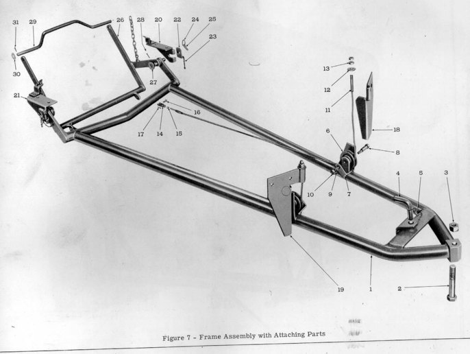

I purchased an old Ford what I think is a 2N tractor a few years ago. It came with a dearborn plow with all the cables etc. I have never had it on the tractor. It is now time to sell off this wonderful piece of equipment & I thought I would put the dearborn on it as a selling feature. I have no idea as to how this gets installed, I think I have the front of the cables figured out, but have no idea where the rear of the cables go. I have looked on the web for photos, but they either seem to be blurry right where I want to see, or in shadow so not much help. I have seen photos of how the rear arms go over the 3 pt arms, but I was wondering if there are any install instructions out there?
Thanks in advance for any & all help.
/ Dearborn front plow #2
Like this?
dearborn front plow - Yesterday's Tractors

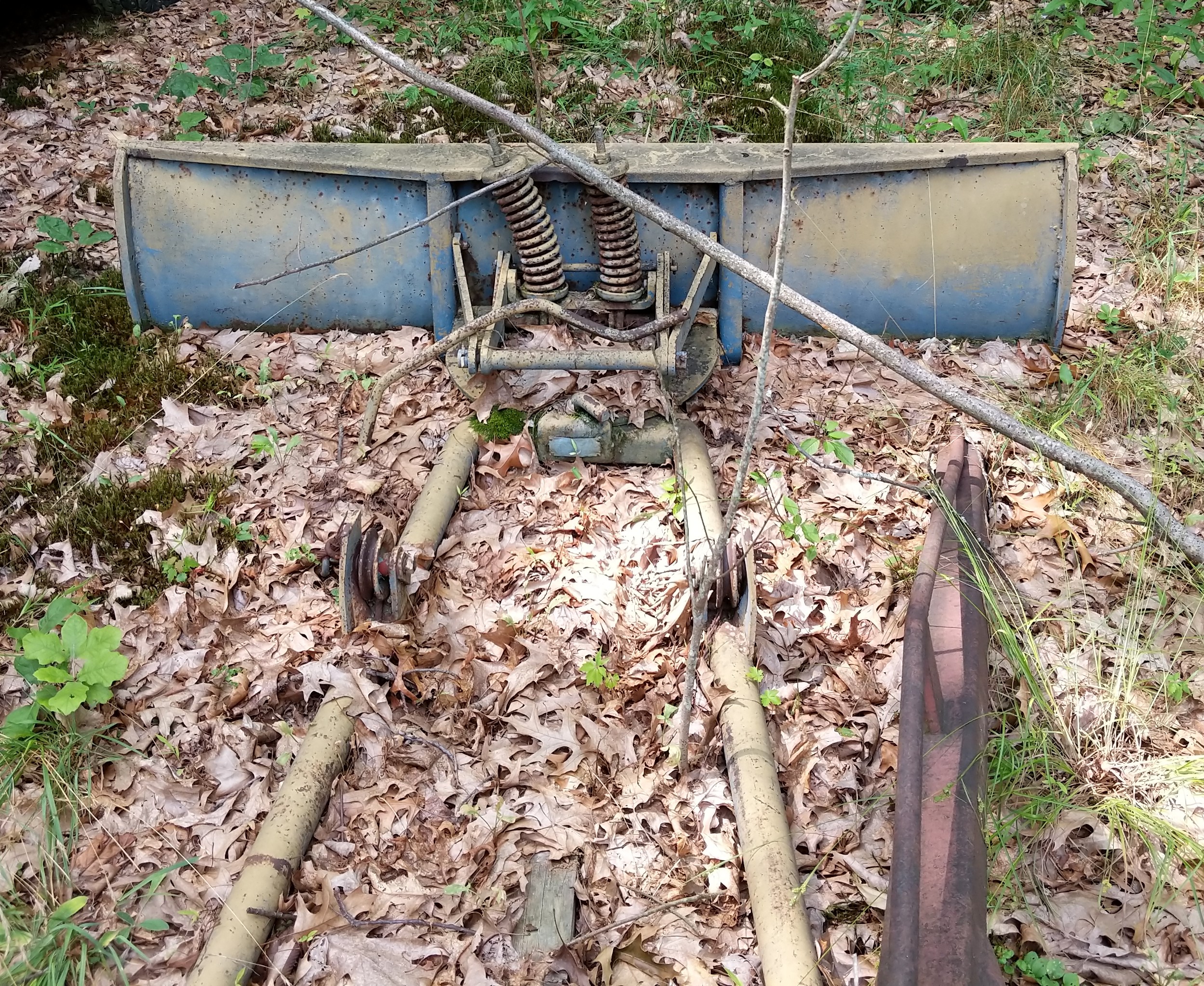

I've had a couple of those plows in the past. With rear ballast and good tire chains they will make an awesome little snow mover out of an N.
Ford did build two different blades for the universal plow frame. One was called a dozer blade. It was lower and did not have the trip springs on the plow.
The snow plow was taller, had trip springs and has more value. Actually, they also made a V plow for them. Kinda rare but not nearly as versatile.

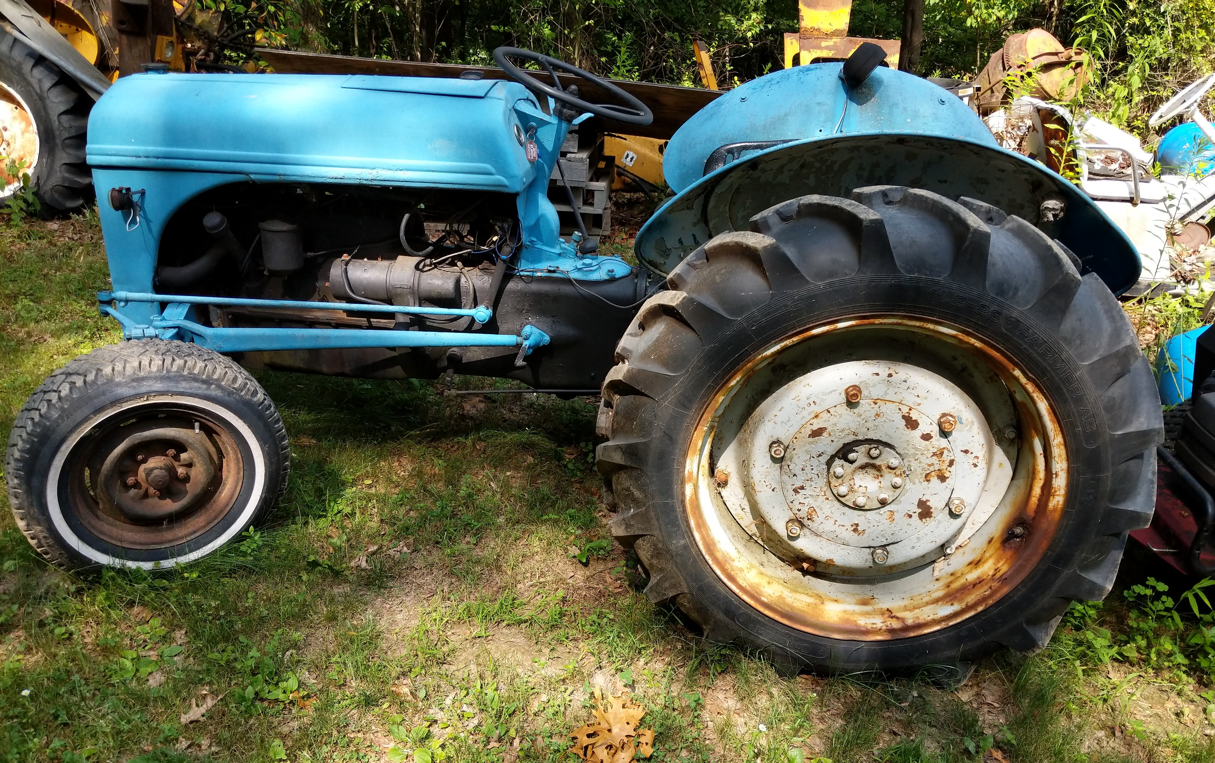

I didn't get to putting them together yet, other projects took priority. But as for photos, here's the tractor, & yes it was that color when I bought it. I would never do that to a classic. I always hoped to get it back to dark grey, but the mechanical side was more important. Speaking of which, she fired right up first try, even after sitting for a month.

At some point the dozer blade got mounted to the snowplow mounting plate. The dozer blade did not use the trip springs like your set up has.
View attachment 614708View attachment 614709
Looks good Loaderman22. Thanks for the pictures!
