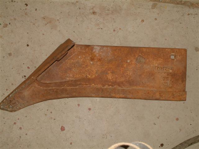

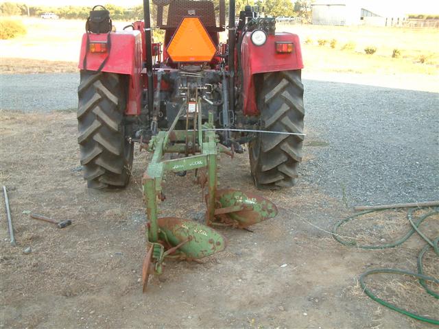

Before you plunge into this project, I'd suggest you carefully determine which parts need replacement. You'd be surprised at the cost of some of the pieces.
For example, my old JD 2-14 plow needs new shares.
It has JD #217 share on it now.
Here's a photo of one of the worn 217 share. The cheapest replacement I've found so far costs $170. Talk about sticker shock.

Flusher, If I were you, I'd be looking for another Deere plow from a SLIGHTLY later era as a parts donor. Not even a GOOD plow, just one where you could rob a pair of frogs from a plow that was set up to use "economy" bottoms with separate share/shin/moldboard. Then swap frogs, install new "HSS" wear parts and go on with life. You'll probably spend roughly the same amount, but at least you'll have ready access to new wear parts going forward. Your plow is the EXACT same as a 415, 416, or 416A OTHER THAN the bottoms.
Last set I bought, shares for the HSS bottoms are around $15, shins about $12, and moldboards were $110. I'm sure they went up some in 2 years, but still in range considering $170 for the cast shares......... Valu_Bilt has the HSS parts, as well as several other sources.
You can go even "later" and find a junker plow from the 60's and 70's with "NU" bottoms and swap to those frogs. Same bolt pattern (frog to beam)
Ah, FWJ, great minds run in similar channels (or ruts).
I was thinking the same thing after I saw how inexpensive some of the more modern plow parts are compared to those oldies.
Wish I had my grandpa's blacksmithing skills (and equipment). I spent lotsa hours as a lad (late 1940s) in his shop in Auburndale, WI watching him repoint worn plowshares. He used sections of old worn out rasps (the type farriers use, IIRC), forge welded half of the rasp one side of the share, bent the repair piece 180 deg, forge welded the other end of the rasp to the other side of the share, pounded the new point approximately to shape and finished the repair on the bench grinder.
Another possibility is arc welding with hard facing rod to build up the worn areas and grinding to shape. I may give this a shot on one of those old spare shares just for grins.

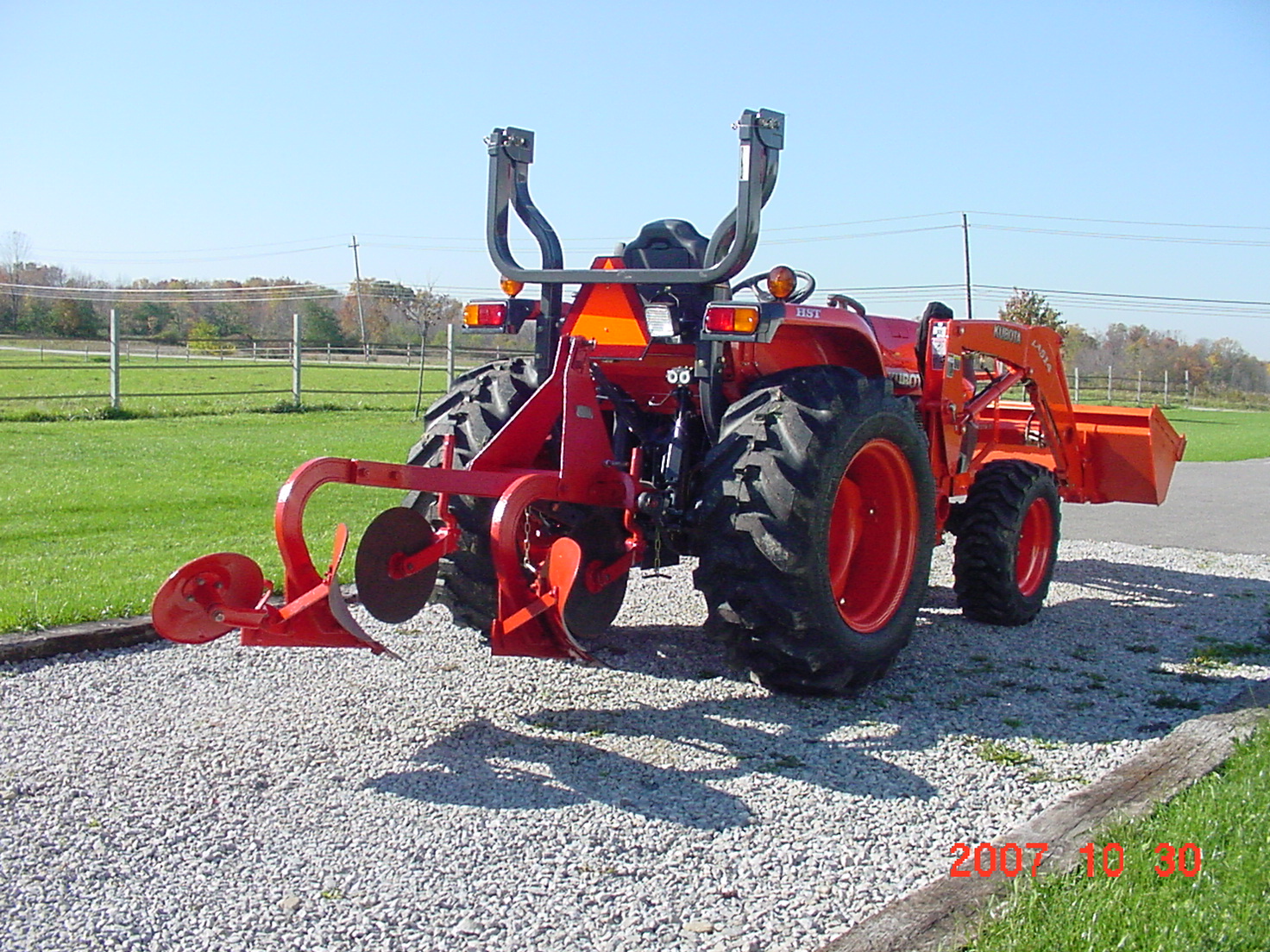

I was lucky to come across a 10-156 Dearborn 2 bottom 14" plow a couple of years ago. I cleaned it up, repainted it and it works great!
Good luck with yours.
-Len

Wow, that plow is too nice to use!! That looks great. A beautiful restoration! Sadly, I have one just like it that I recently trashed by catching a rock. Do you ever have any problems with it grabbing something unexpectedly? Maybe our soil here is just too variable to use a plow such as this without trip protection, or maybe my tractor is just too big.

My plow looks just like claridon's except not so pretty. Great job claridon.:)
