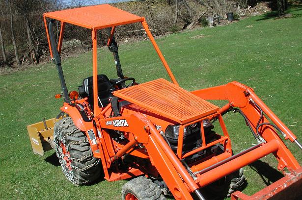

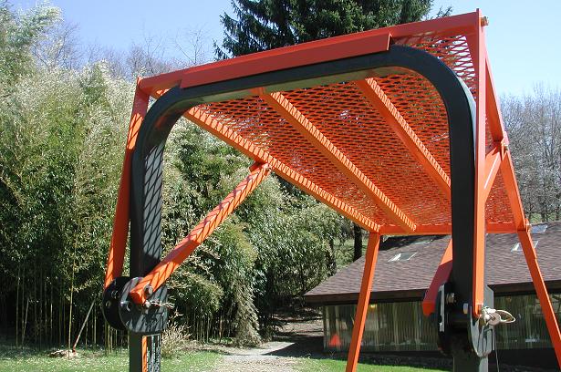

A falling branch or even a tree has been a worry of mine. My solution was to weld up a "head protector" and guard for the tractor hood.
This has worked a couple time to keep something from hitting my noggin...glad I did this...does not get in the way at all as it tapers narrow towards the front and slopes down towards the front as well, so nothing catches on it.
An added benefit is that if I put a cloth on it in summer, I get shade as well.
