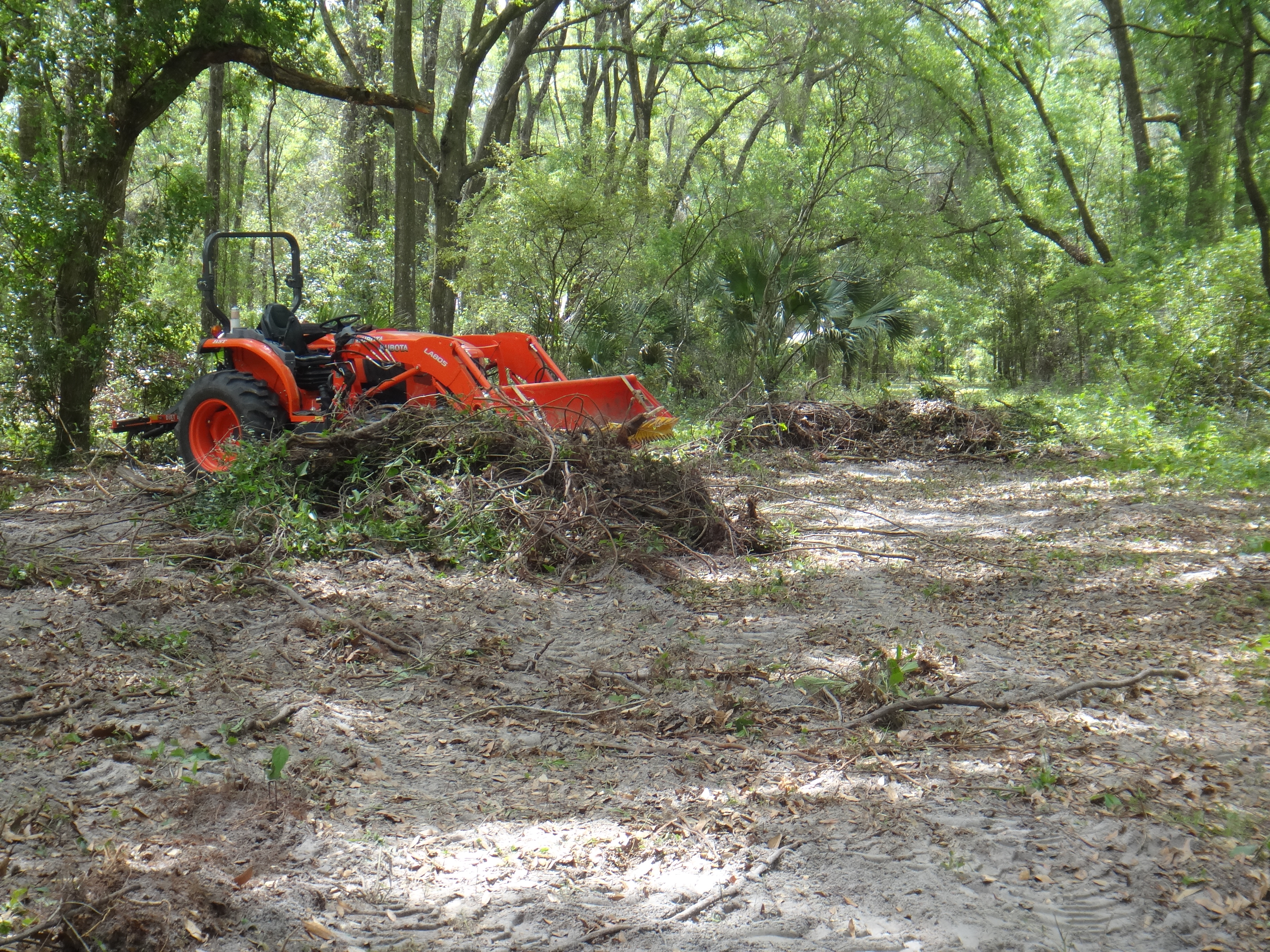

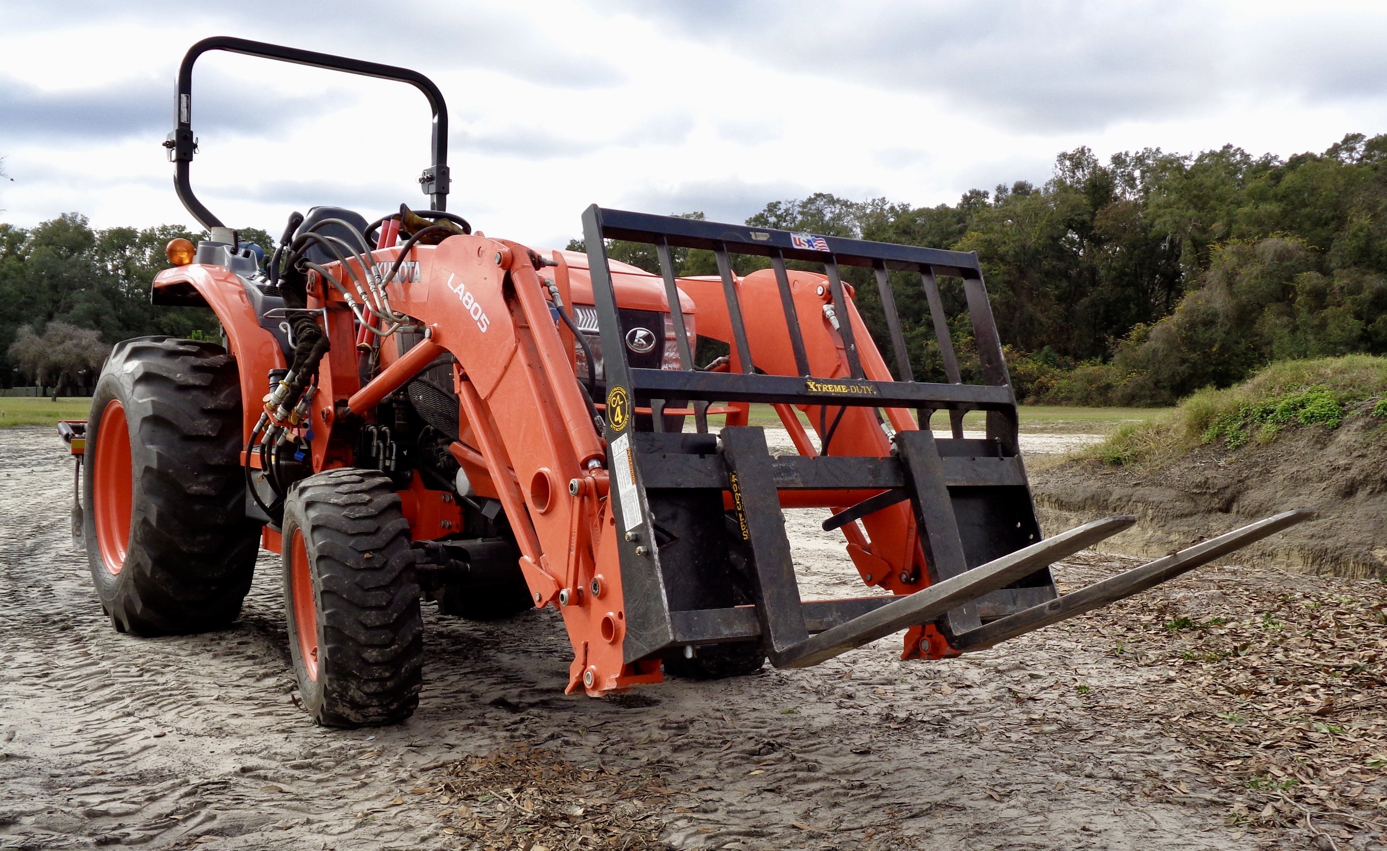

I used aluminum clamp-on Debris Forks for six years.
Two complaints: My five tine forks picked up too much dirt along with tree debris.
Once, picking up a tree section, I rolled the bucket too far back and the tree section came over the bucket, crashed onto the tractor hood denting it, then rolled off before hitting me in the operator's station. This "in the blink of an eye."
Now I use SSQA Pallet Forks with a large guard. (PHOTO #4) My pallet forks have easily moved individual tines. Properly spaced Pallet Forks are about as effective at picking up brush as the Debris Forks and better for heavier work. Short forks (36" or 38") are better for debris transport than long forks (40"+). Pallet Forks pick up less dirt per load.

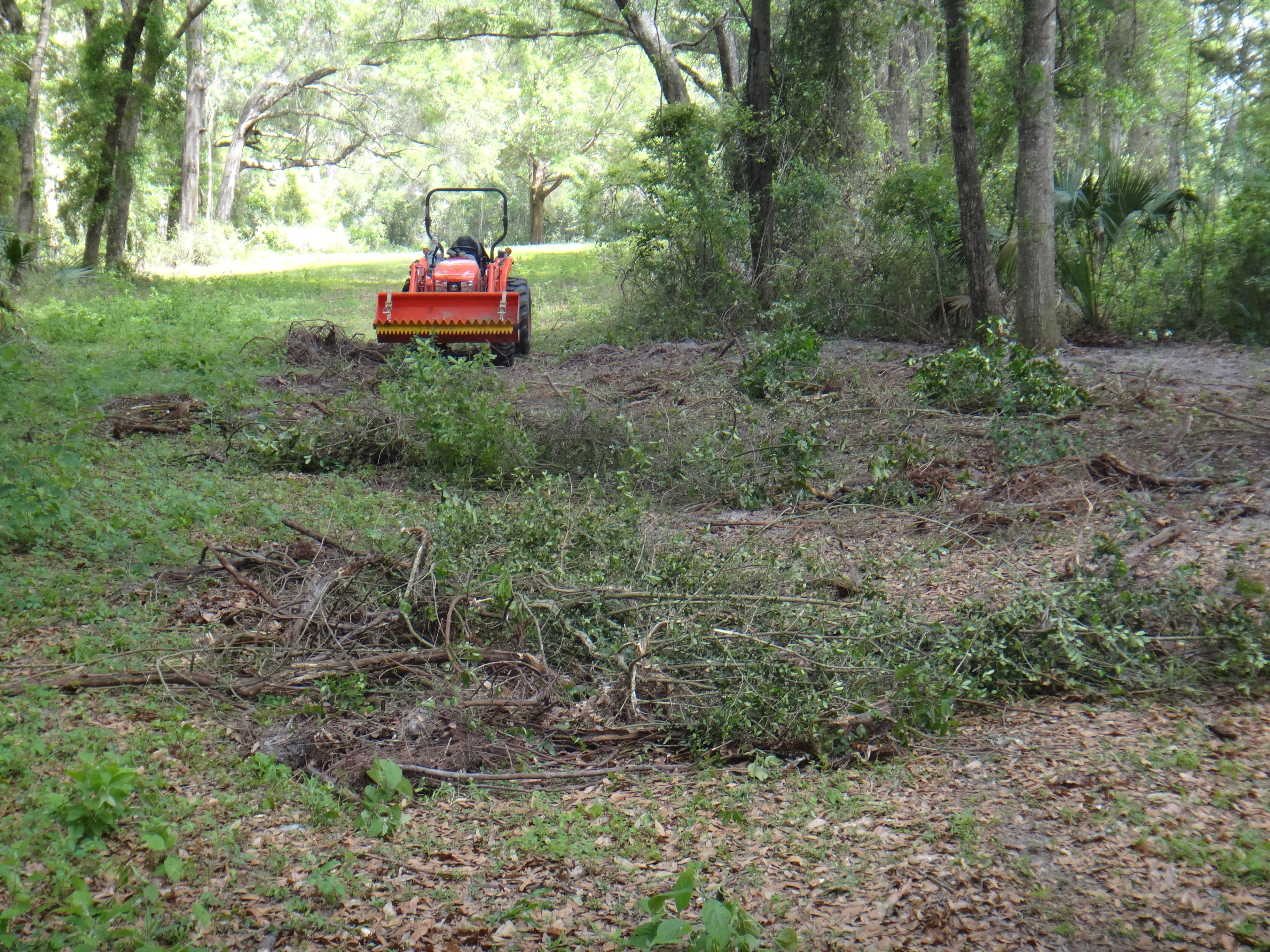

A Ratchet Rake bucket attachment is by far the best tool for collecting brush and limbs into piles. Good for grading small areas.
LINK: https://www.tractorbynet.com/forums/attachments/375397-ratchet-rake-today.html?highlight=
