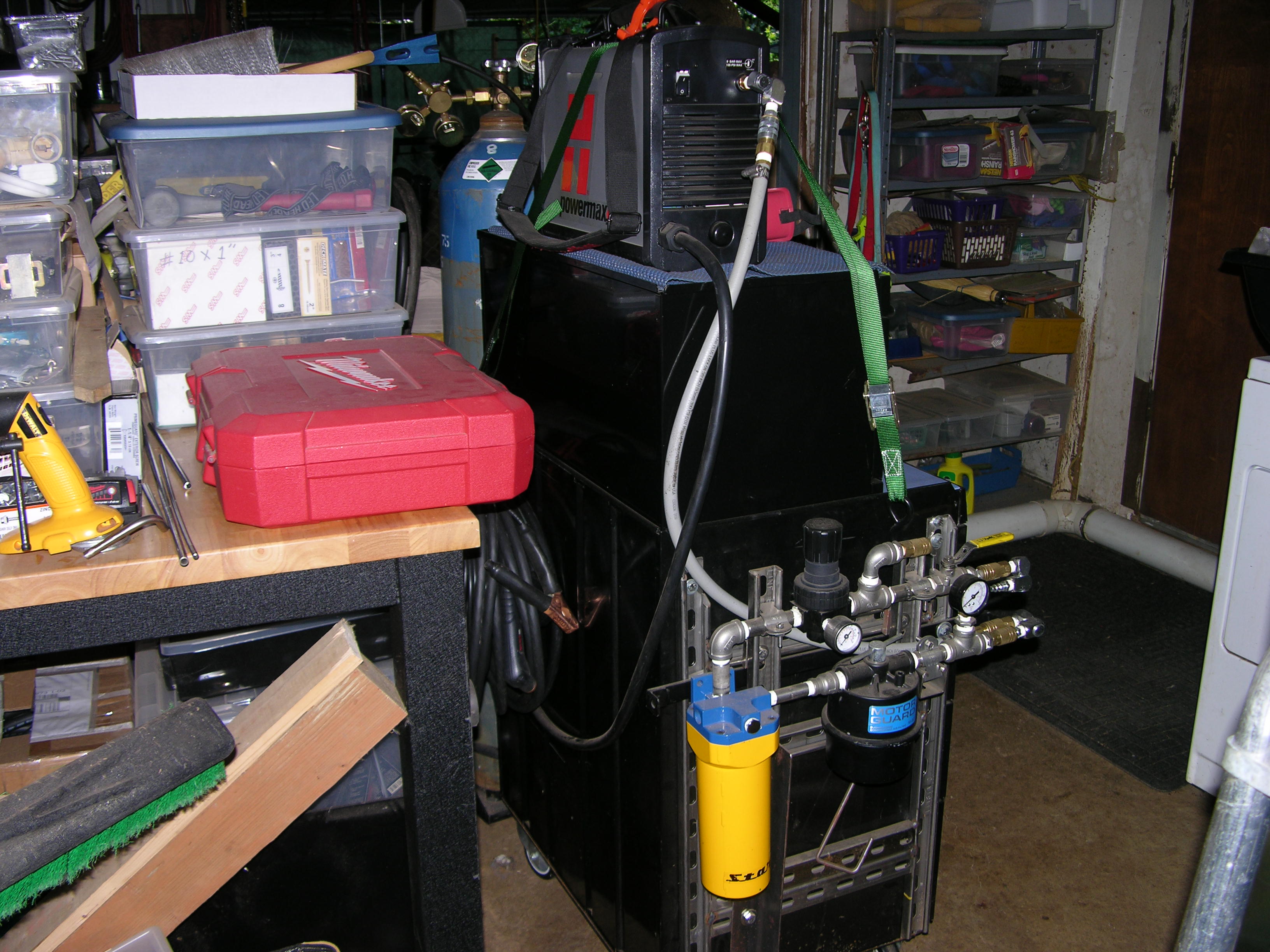

I have been using a harbor freight separator with a filter in it. Its starting to leak. I rarely use my plasma cutter and mostly use some air tools and media blaster the most. Just looking for a decent home diy'er water separator that doesn't break the bank. Thanks in advance.

For my plasma I purchased a Motor Guard unit. Uses filters that resemble tp. Different models for various cfm requirements. Don't remember where I ordered from, shopped for the best deal. Was from the US though.

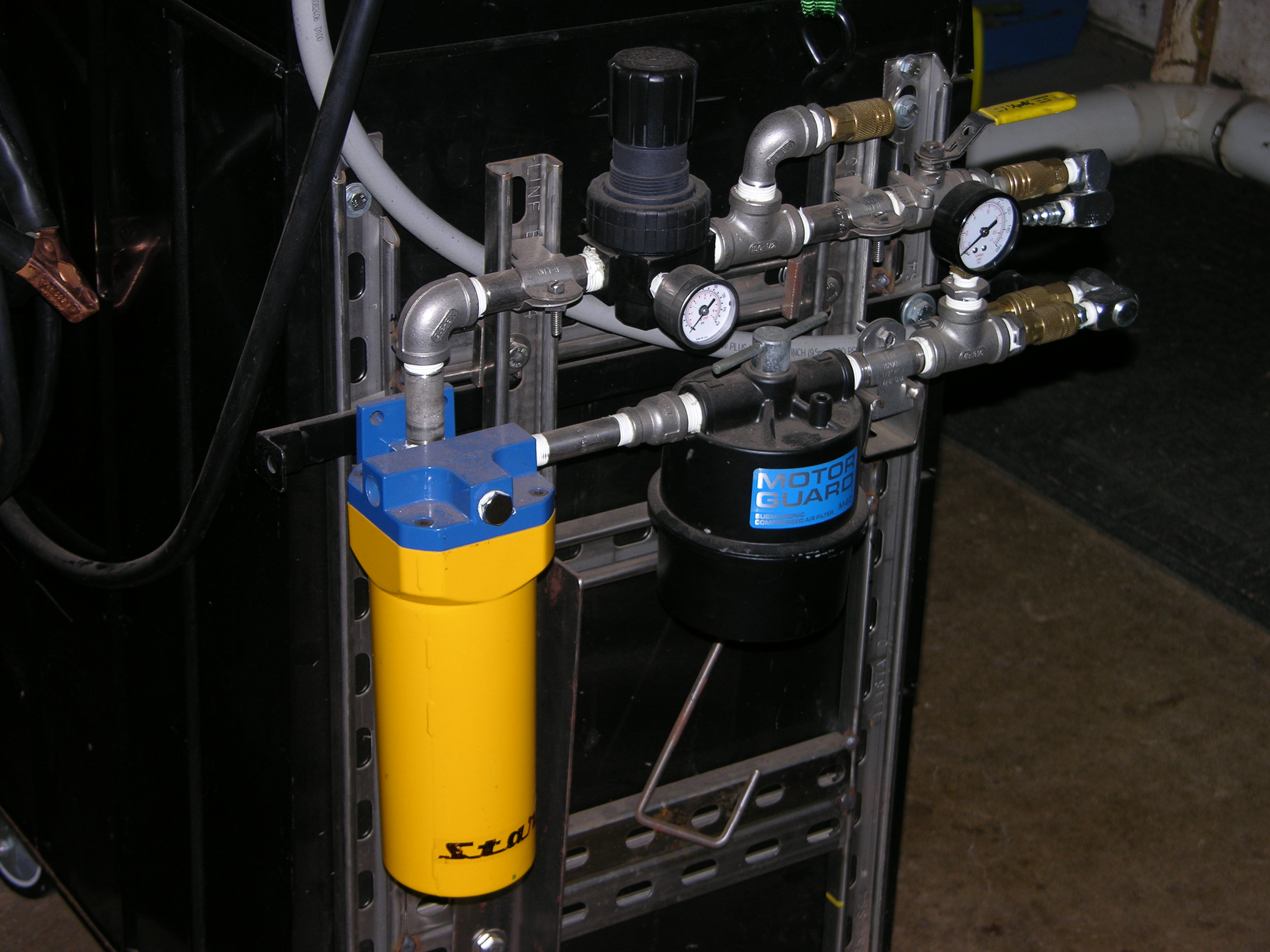

Who you callin' a hack??!? :laughing: ...Steve
